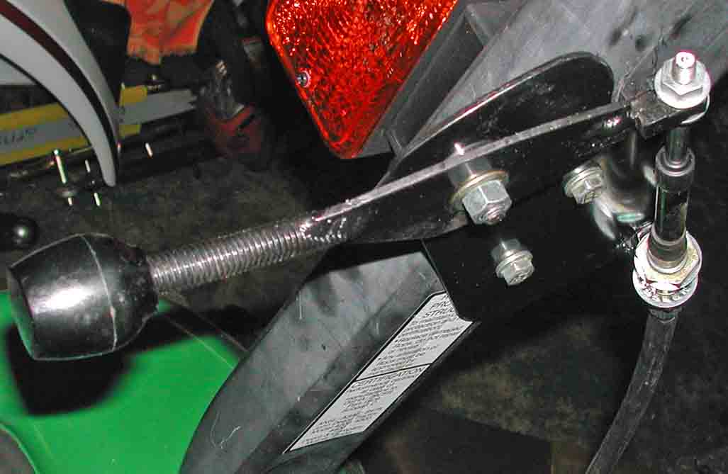

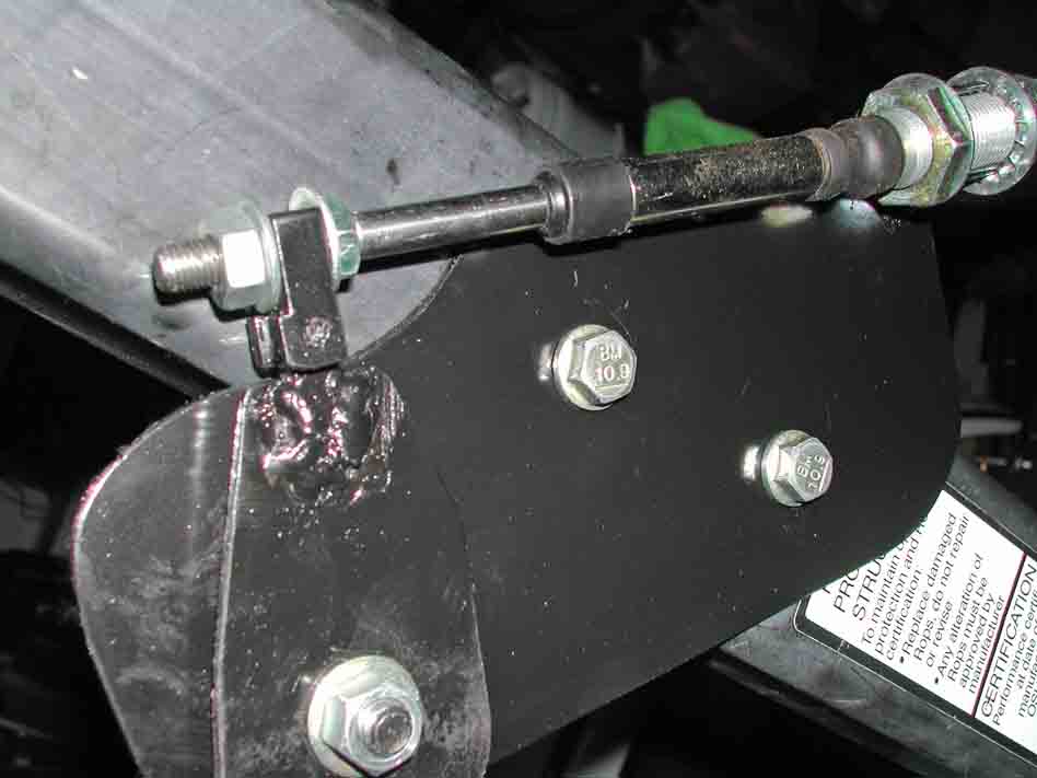

Sometimes experiments do not work out. I cut apart and re-made
my AUX valve lever, this time with a pivoting end piece so there is very
little slop in the movement. It works great. Clearer pix below.
As I said earlier, the push/pull forces required are large. The threaded
end of the cable is 5/16-24.....I am glad I got a big one.

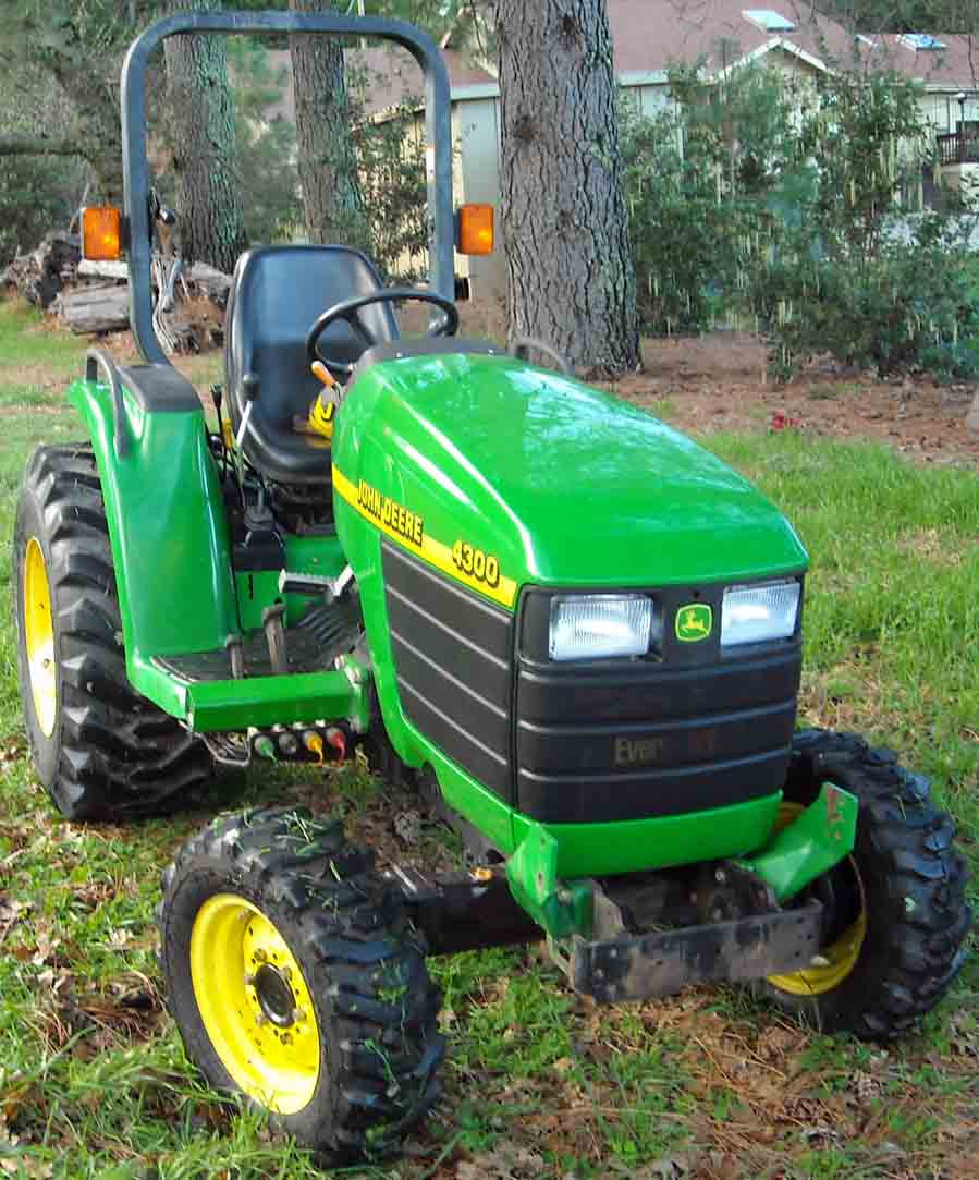

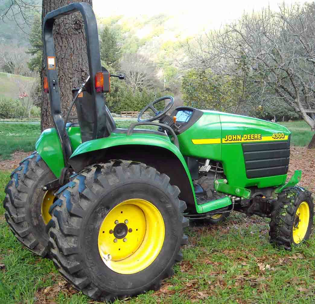

I drove my tractor over to the neighbor's place a quarter mile from here
so I could get some sunlight. (I live in the forest with a mountain and
trees blocking my winter sun.)
By letting the sun shine on the new body panels, I could get the temp
up to a safe range for the label glue to stick. These new labels were
about $17 each and really give the tractor that finished look. I also
applied a few dabs of touchup paint to gouges in the rear fenders. Here
is the result.
Alas, I was not able to apply the left side label as some clouds obscured
my sun.

   / John Deere 4300 complete rebuild #393
Dave,
You really have done a remarkable job of bringing life back to that machine. Nicely done!
   / John Deere 4300 complete rebuild #394
I call BS, I think you just bought another JD in much better shape!!! :eek:
Great job on the project!!! Perhaps one day I can use my retirement to do something similar, you are an inspiration!!!! ;)
   / John Deere 4300 complete rebuild #395
wow, it looks great. Great job.

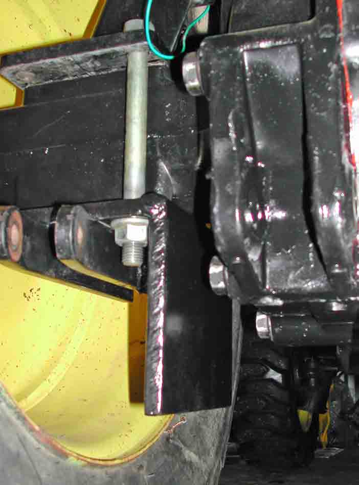

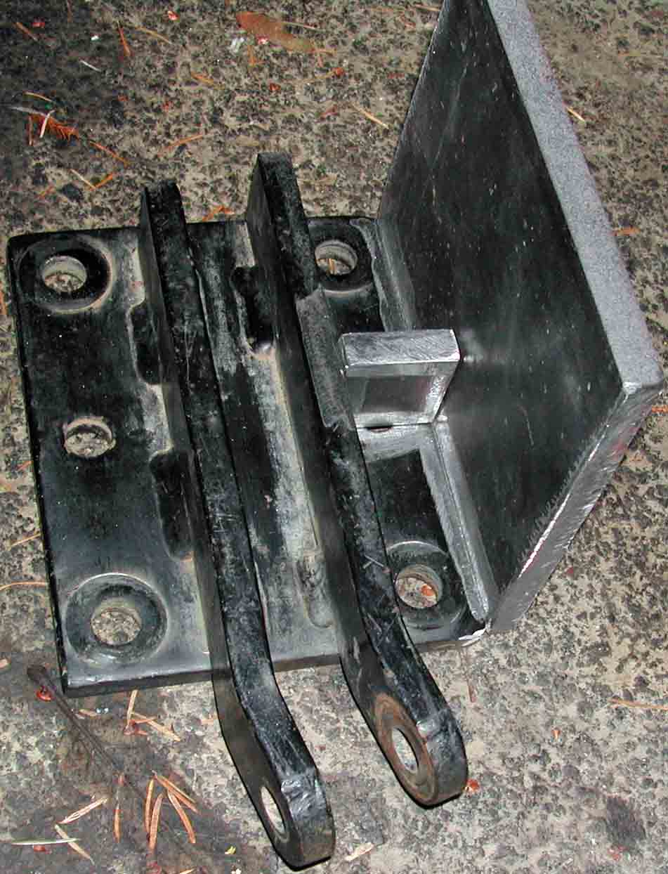

Meanwhile, I have been working oh the new hoe subframe. Perhaps I
need to start a new thread for that.
These two pix show the brackets I made, which are securely welded to the
lower ROPS bracket, I will not be using any of the troublesome bolts
that go thru the aluminum axle housings. Here I have used some 1/2x6x7"
A36 steel plate and a 1/2" buttress.
When I installed the finished bracket, I can see that the clearances
are just too tight to allow use of some 3x1.5x1/4" channel for the
rest of the frame. Those huge tires extend inboard so much, the hoe is a
tighter fit than even on my old 955, a MUCH smaller tractor.
So I went out today and bought some more 1/2" plate, this time a stick of
1/2x4" for the frame rails. (It was $5.80/ft, BTW.)
