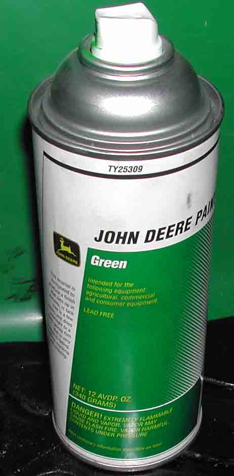

#408
Man, that thing looks brand new ... better than that even.
That's what they call "soft focus". Anyway, thanks.
Some would say I went overboard on this, but at least I did not repaint
the fenders, ROPS, or engine.
The loader paint looks kinda dull, but I won't repaint that either.
Someone asked.....here is the green paint I used in the few areas I needed
it....it matched pretty well, and even dries in cold weather. I also bought a
quart of AgriSupply JD green enamel for rear fender touchup with a small
brush.
