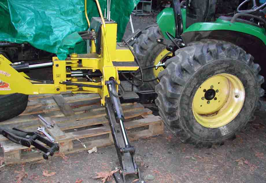

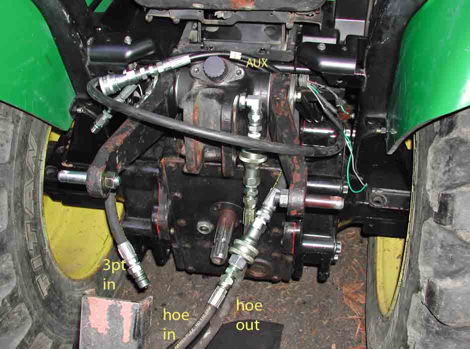

Here I have hooked up my hoe to the tractor's PB loop, and operated
its controls to get it up to the correct height to take some measurements.
I have had this hoe in storage for a year, waiting for this moment. It's
a Prairie Dog 7.5, just like the one on my Kioti.
With the hoe mounted, the 3-pt cyl will be completely bypassed, and the
QD return connection goes right to the reservoir. All hoses and fittings
are nice big 1/2" units.
The AUX hoses in the second photo are the two work port hoses of the
3rd SCV. They will be secured to a bulkhead mount welded to the ROPS.

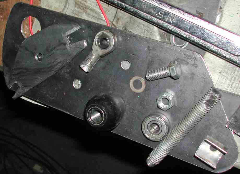

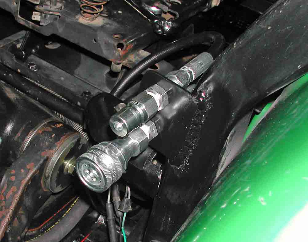

#387
Here is the bulkhead I welded to the ROPS to support the work port
QAs of the 3rd SCV. My cheapo rattle can gloss black does not quite
match the JD off-black, even after polishing it. But it is good enough.

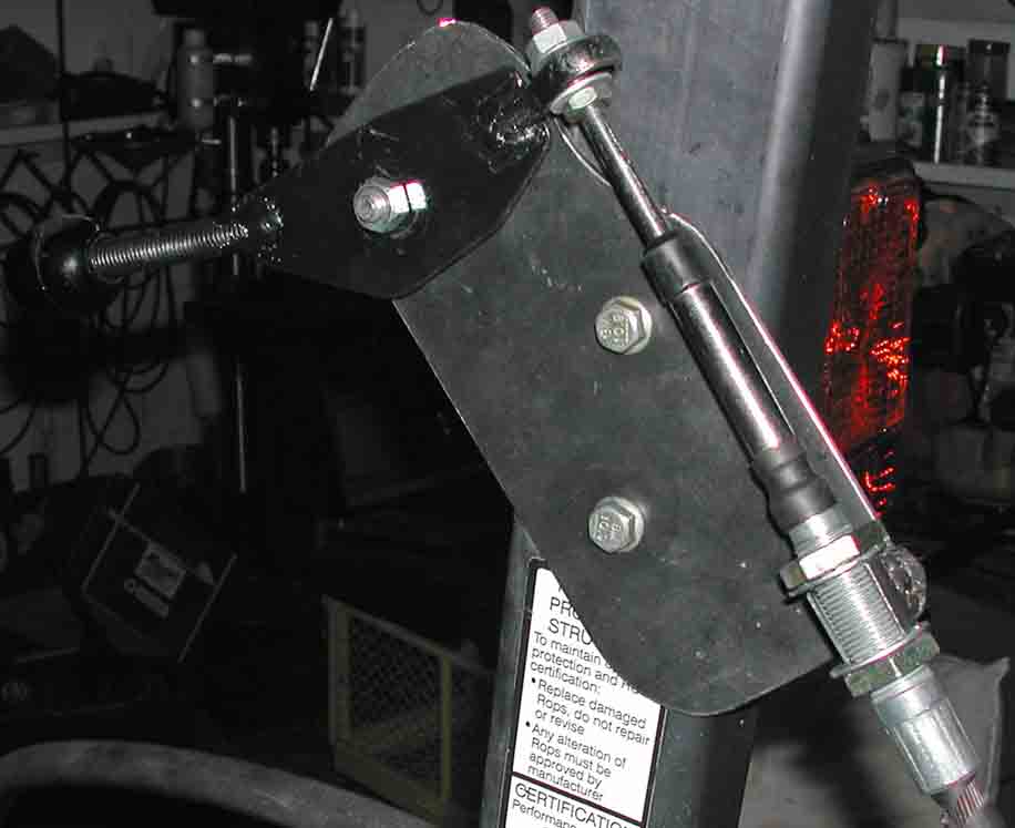

For the control lever, I experimented with some 1/8" plate for a backing
plate and the lever itself. Also, I am going to weld in an old ball bearing
so the pivot will be very strong and smooth. A piece of 1/2"-13 threaded
rod will screw into a black phenolic ball that I have in stock. To get the
articulation I need to hold the cable, I am going to try an old Heim joint.
There is not the room for a clevis.
The third photo is the result. I am using the work light mounting bolts for
a firm attachment to the ROPS. It works, but I may tweak the cable
connection to the lever to make it even smoother. There is a very
strong spring action to this lever, despite drilling a new pivot hole on the
spool's bellcrank.

   / John Deere 4300 complete rebuild #388
Looks good Dave. Will you have any problems with the 3PH upper lift arms colliding with hoses connected to your quick disconnects when in the raised position? It's tough to tell from the camera angle if the splayed lift arms will cause you trouble or not.
Any way you look at it, it's a tight squeeze back there.
   / John Deere 4300 complete rebuild #389
Does this swivel here ?
Edit; never mind, I realize now it's a 'handle'.
#390
The photo could be clearer. I need the sun and outdoors pix.
I am re-doing the lever anyway...it is not smooth enough for the forces
required.
All hoses, brackets, and the cable clear all obstacles....the toughest concern
has been my backhoe seat.
