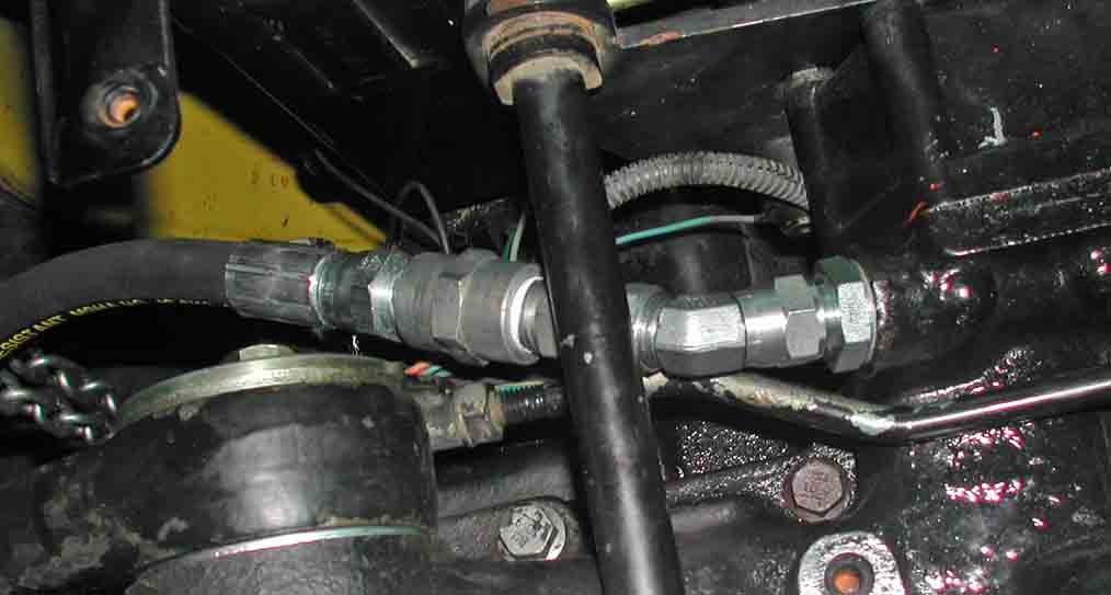

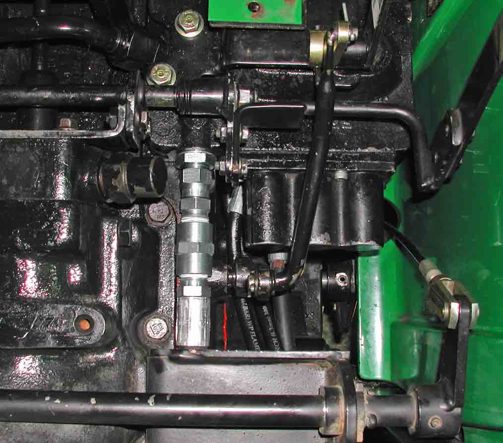

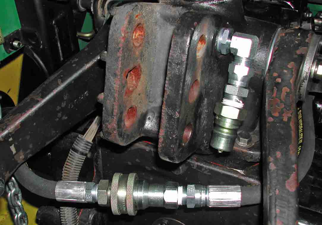

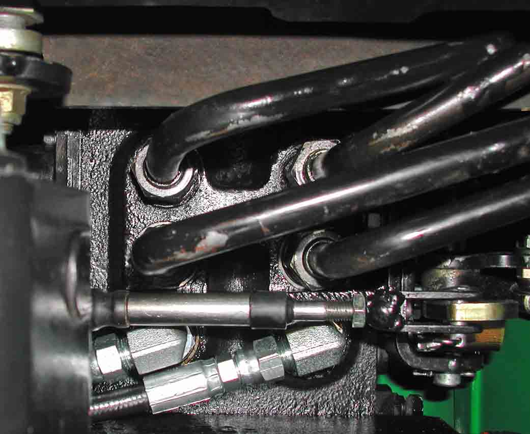

Now I have the fenders and other rear trim plastic all installed. The
ROPS is mounted, but supported only by the fenders until I can work
on welding up the lower ROPS brackets (for the hoe subframe).
At last I have the power beyond loop done. The two short hose stubs
in the first photo replace the hardline that connects the triple SCV to
the rockshaft valve. There are lots of 1/2" sizes fittings and adapters in
there, as I have metrics, JICs, and NPTs to deal with. The QA will allow
me to hook up to my backhoe and use the return-to-tank fitting that
I mounted just to the right of the toplink holes. I wish more tractors had
these convenient reservoir connections. When the hoe is mounted, the
3-pt cylinder will be entirely bypassed, and the hyd fluid will encounter
less resistance as it makes its way back to the reservoir.
The 2nd and 3rd pix show the connections to the SCVs and rockshaft
valve. My new PB setup clears all obstacles: the 3-pt arms, the 3-pt
feedback linkage, and the PTO shaft.
Last is the bottom view of the completed connections to the SCVs, now
with the 1/4" work port hoses on the 3rd SCV. All these connections had
to be made with the valve block installed, and it is very tight in there. I
could do it with fender on, but the rt wheel had to be off.
Now I have fab up some brackets for the 3rd SCV control and hose support.

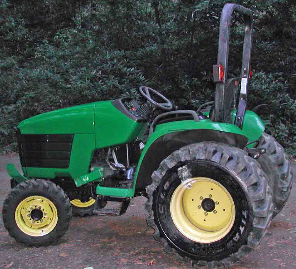

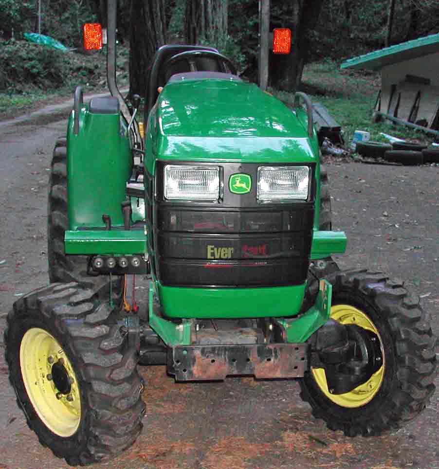

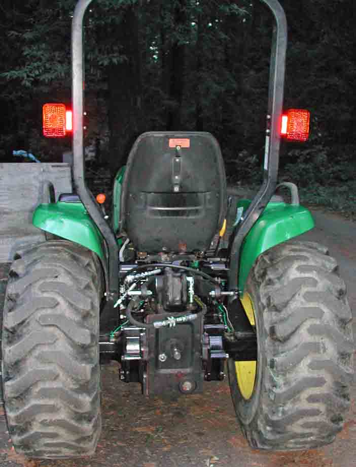

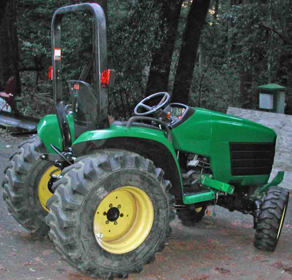

My PB loop is done, so I was driving my new (ish) Green Machine
around, getting some measurements for my backhoe subframe.
It was kinda dark, so these pix are a bit grainy. I will take more when
I see the sun.
Anyway, all body panels are now mounted. The ROPS is currently only
attached to the fenders, as I will be welding ears on the ROPS bottom
brackets. Lots of other minor stuff to do, too.
