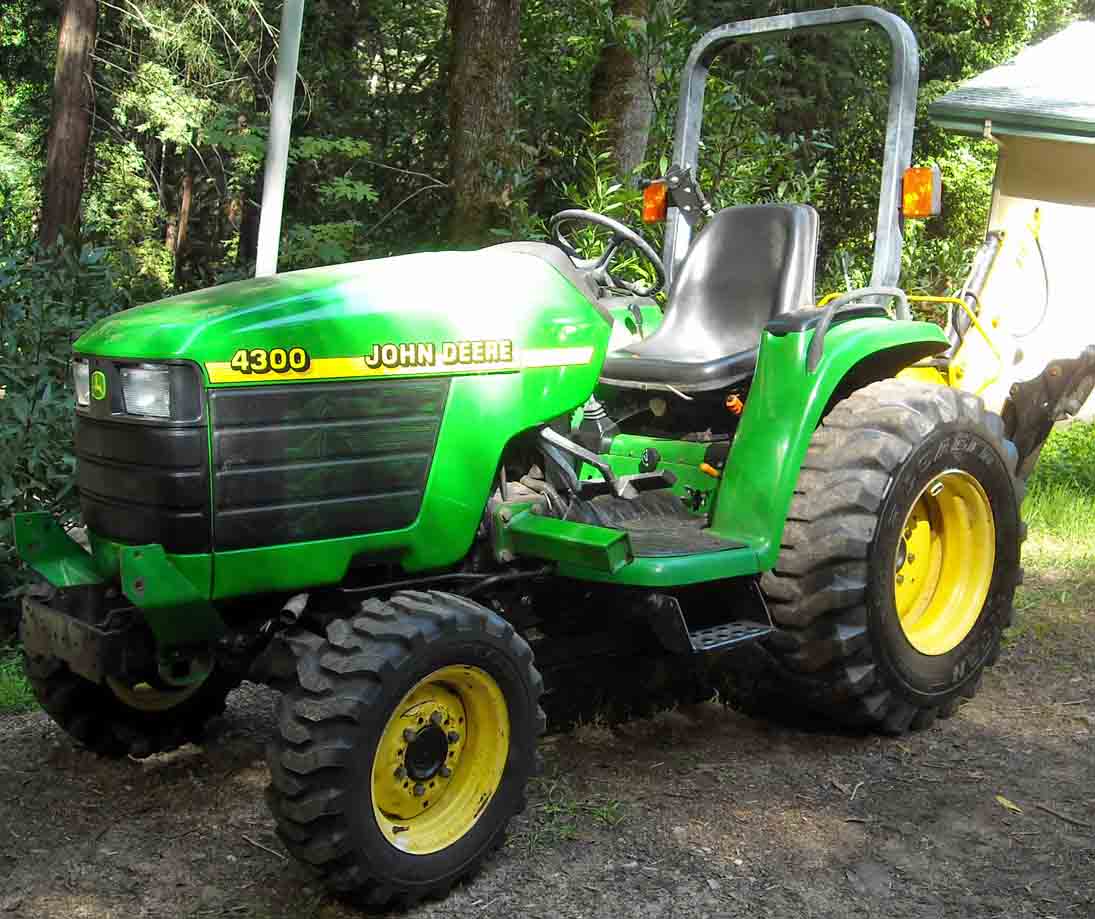

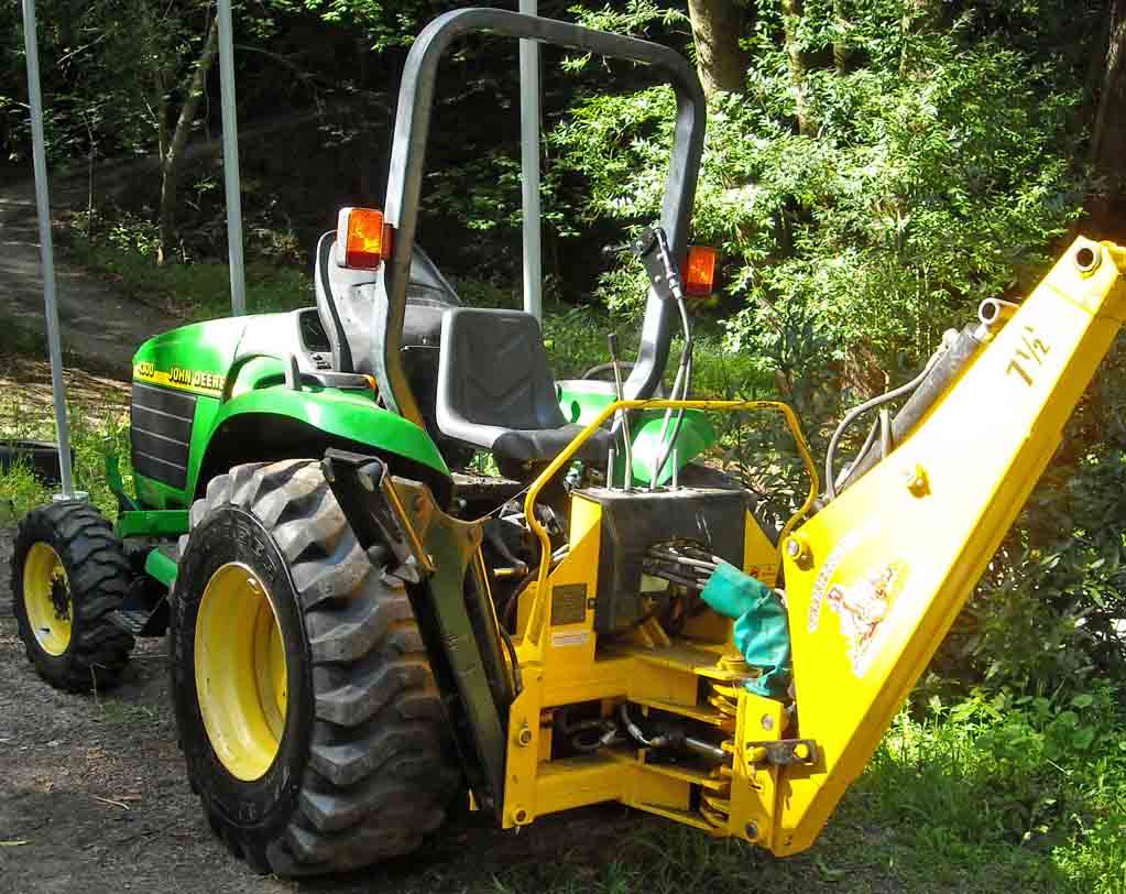

Well, I have not updated this thread in a while, mostly because the next
big step is to get the FEL mounted and refurbished. Doing that calls for
my fork frame/boom, which was not mounted to my main tractor. I just
got it mounted yesterday, so more is coming.
Also, I have been busy making a subframe for the 4300, which is now
complete. I hope to start that thread as a new one, with emphasis on
general subframe building for any CUT and any hoe.
The temp was warm enough to put my last label on the left of the hood/
cowl. I have been driving it around with the new hoe and subframe on,
and it works great.

Ummm, Dave?
You might want to check where you left your glasses...That hoe doesn't look to be all there!:laughing:
