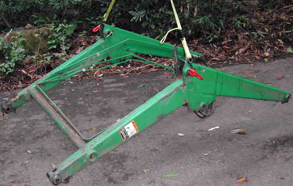

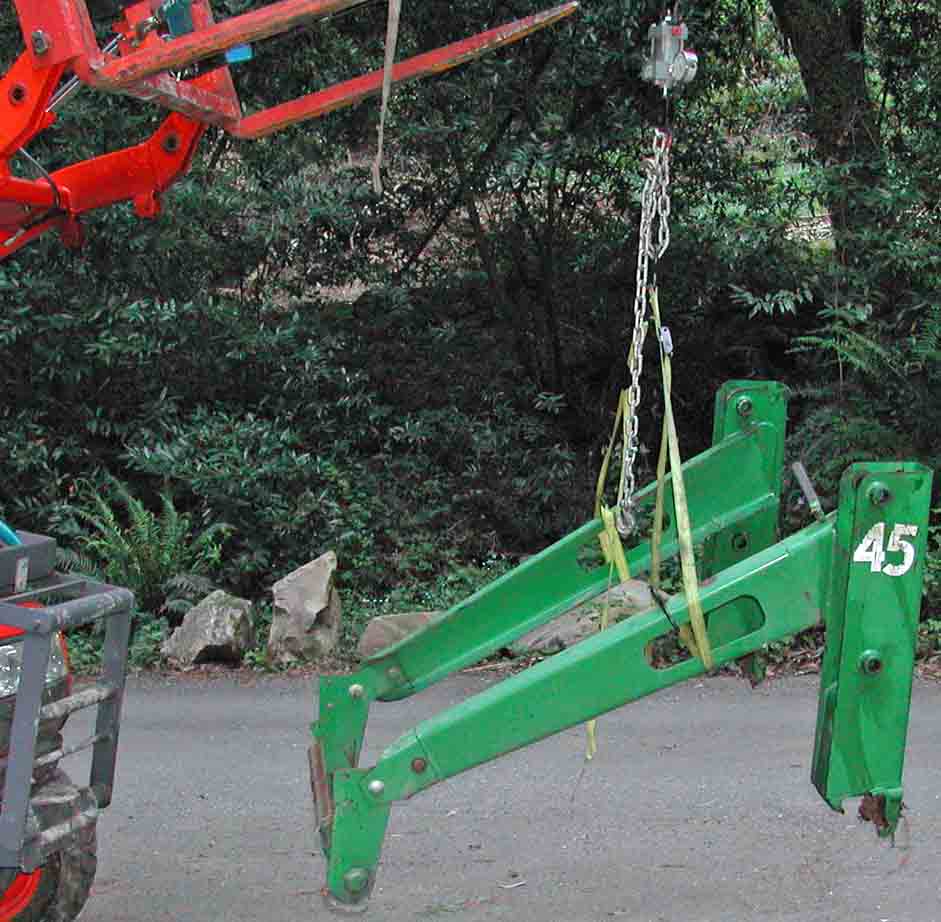

Here I am positioning the 420 loader subframe for mounting. The subframe
and boom were quite a hassle to remove from the tractor when there was
no hydraulic power. Hence, they were separated. Since it was such a
hassle, I didn't want to attempt re-mounting until I had a better way to
lift and position them. I certainly did not want to damage my new green
plastics!
My hydraulic scale indicates the subframe weighs about 150 pounds. I
suppose the 430 FEL might have a heftier subframe.

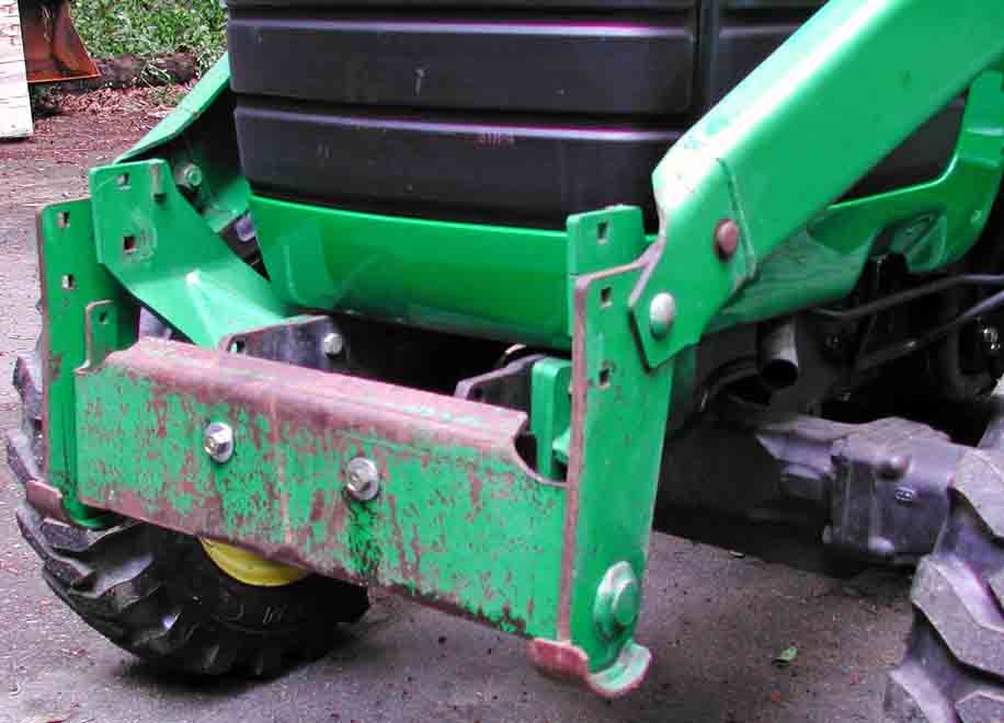

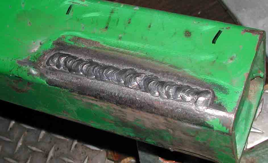

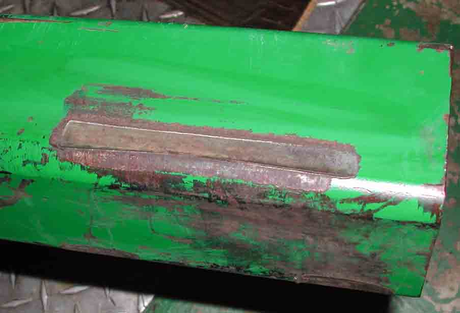

The subframe is now mounted. It was quite tight, securing the front
hinged plate that holds it on. That was due to the material I added
a while ago to compensate for wear. There is no looseness now, that's
for sure. I have also bolted the plate closed, as the rental yard did. This
keeps the FEL from being quickly dismounted, which is no problem for me.
If your 420 or 430 FEL is loose, I recommend this easy fix.

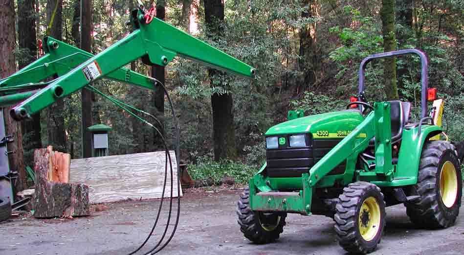

If you ever need to remove a loader, and you have a dead tractor,
don't do it unless you have an overhead crane, a forklift with extended
reach, or a boom pole on another tractor.
Then if you DO remove a dead FEL, the boom and subframe may not
be stable if the cylinders move. The cyls may not be full of oil and will
not likely be capped off, so they WILL move. Bad. BTDT
Anyway, here I am installing my FEL boom. It is surprising that it only
weighs about 130#. You can make a very strong structure with 3/16"
box sections apparently.

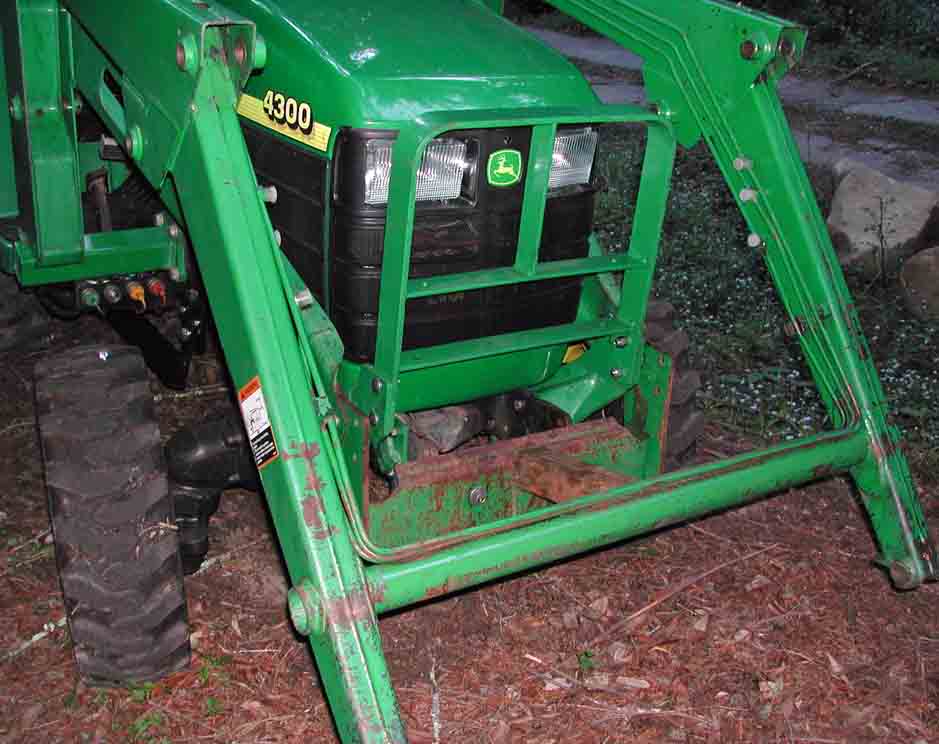

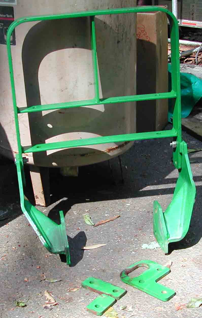

Next I wanted to replace the massive hood armor that I got with the
tractor with the commmon OEM grille guard that you usually see on the
420 or 430 FELs. Go back to Page 1 if you want to see the hood armor.
JD was nice enough to provide green 3/8" shims to install the guard
brackets at the correct width.
And photo 4 shows the result.

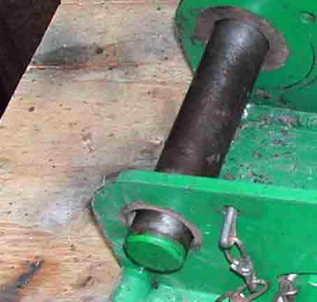

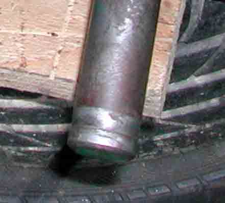

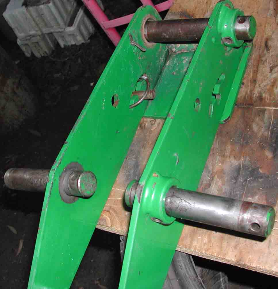

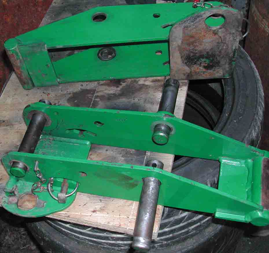

Well, I am quite disappointed with the construction of the JD 420
loader's quick-attach bucket mechanism. It seems they used no wear
bushings to secure one side of the pins, so there is significant wear
in the thin 1/4" retaining holes. You can see in the first 2 photos that
bushings are used on one side to keep them from rotating. Clearly they
should have used bushings on the other side, too. You can see in the
third and 4th photos how much wear I have. I can't leave it that way.
If I weld bushings onto the places where none exist, I will need all new
pins, because they are not long enough. Not a big problem, normally, but
the upper pin is a 1" rod that spans the width of the loader boom.
At least JD uses mild steel pins (unlike Kubota, who uses hard pins), so
wear is shared fairly evenly between the holes and the pins. Another
solution would be to cut the worn holes out to 1.5" and weld in half inch
thick 1.000" DOM tubing. Or I could build up the hole with a weld bead,
and drill it out to 1.0". Decisions, decisions.......
