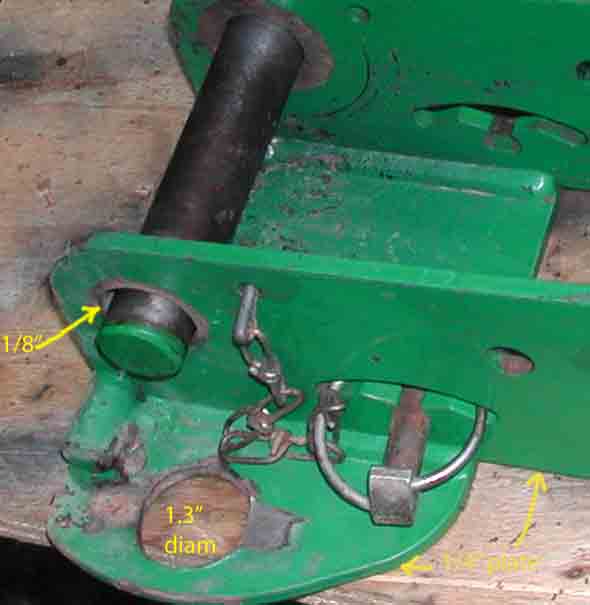

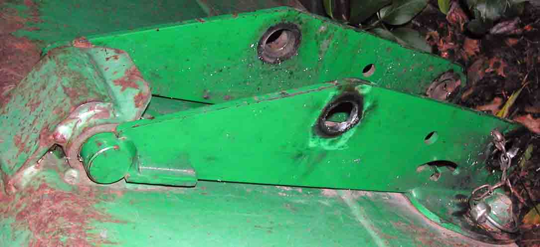

I was just about to start welding on my QA bkt brackets and I noticed that
the slop in the QA "nub" hole is also horrible. I measure the nub on the
bkt to be 1 3/16" diameter, and the hole on the bracket to be 1 5/16".
It is somewhat surprising that the hole is round, not worn to an oval shape.
So it seems that it has worn as much left and right as well as up and down.
I don't know how tight this was when new, but right now, it is extremely
loose. This part of the bracket is also only 1/4" thick, and the retainer hole
limits my ability to make it thicker here. :(
.....got more welding to do....

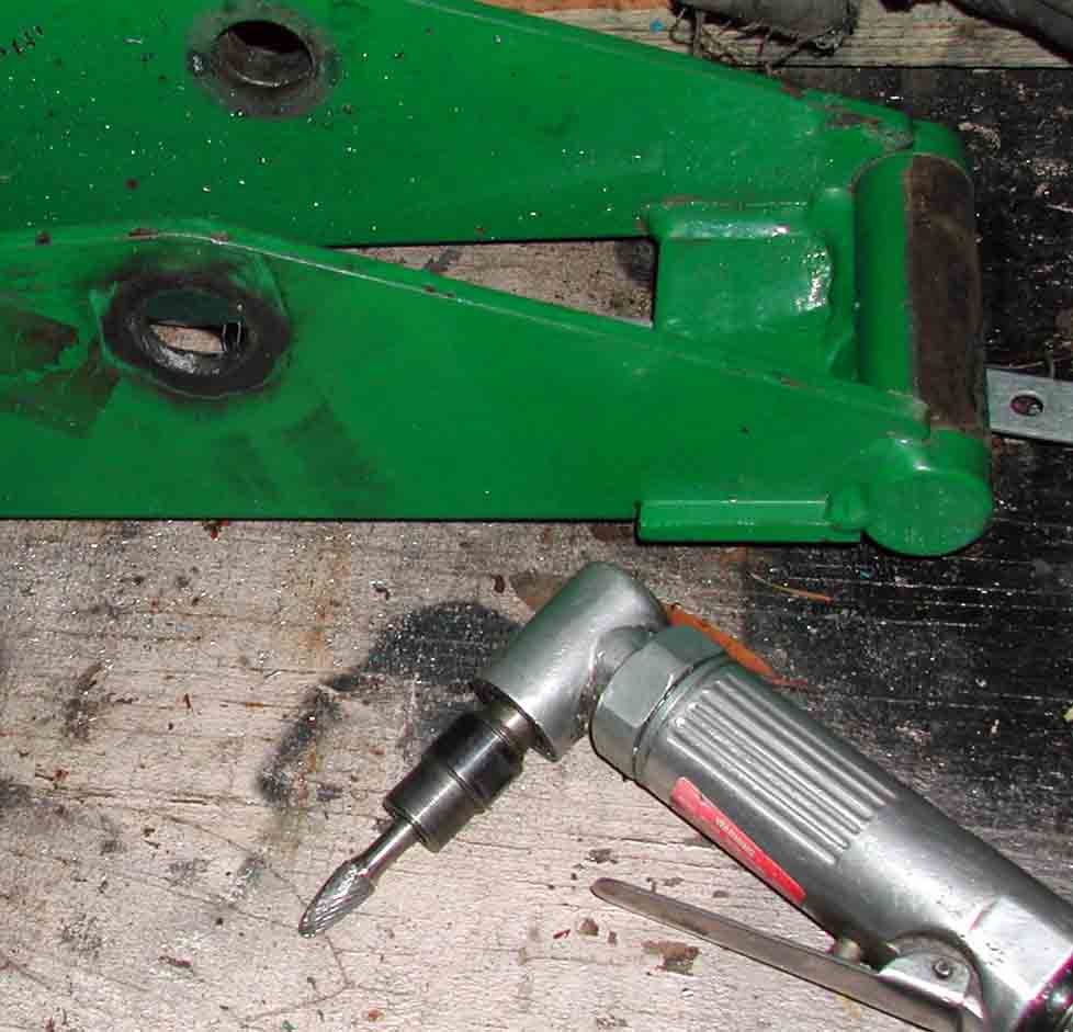

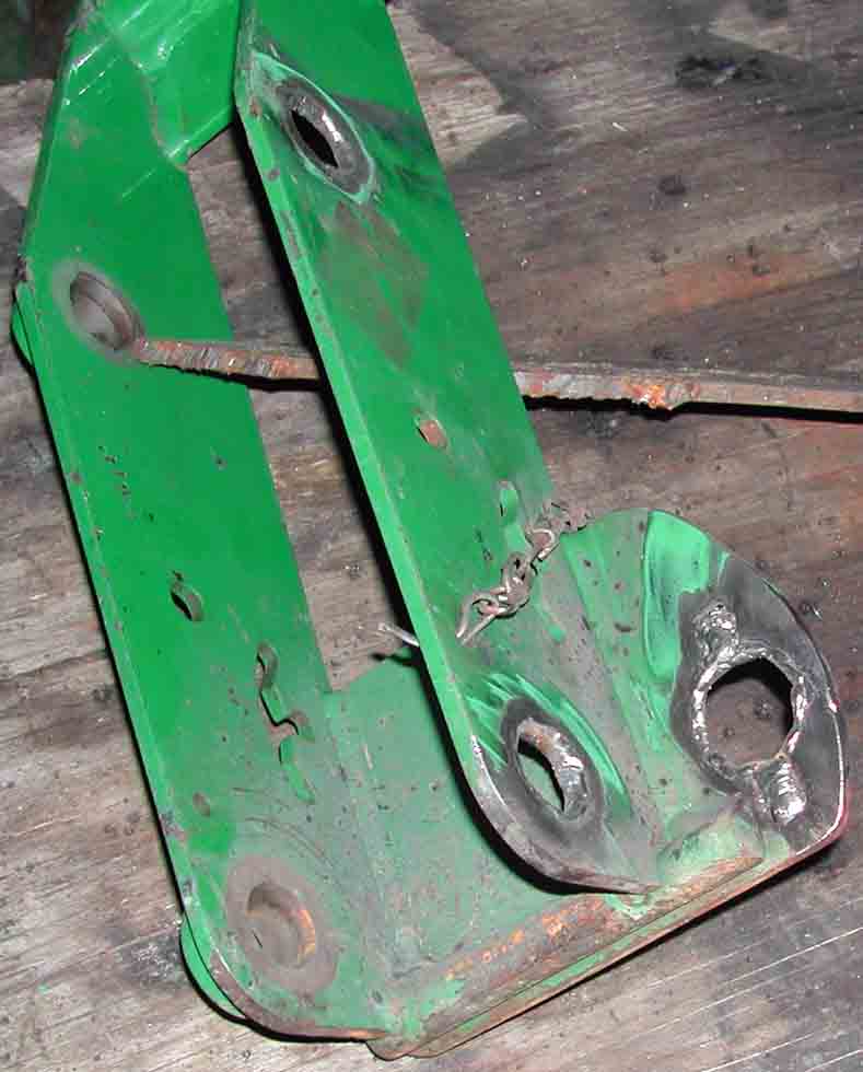

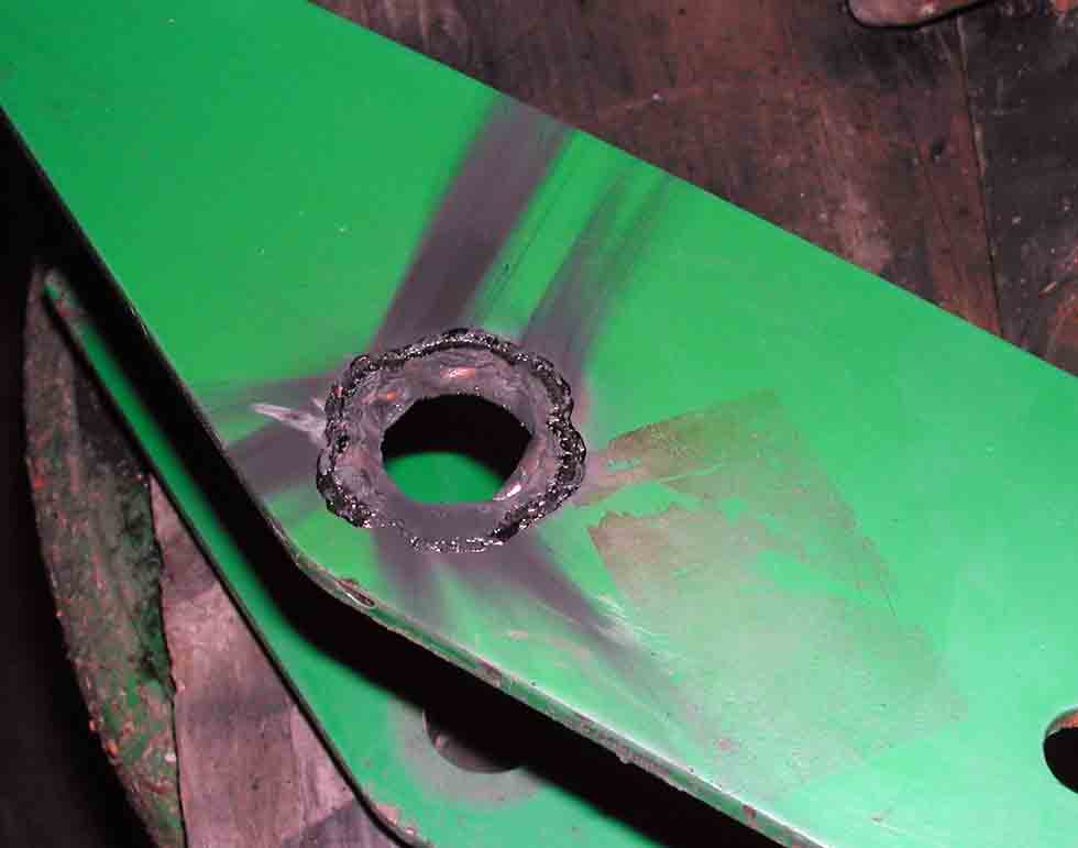

Well, I have a ways to go yet, but here is my first pass at repaired
FEL QA brackets.
The first photo shows just after welding inside the worst of the pin
holes, before clean-up and any material removal. In the 2nd, you
can see the welding I did for the bucket alignment pin hole. Where
the clip that goes thru the pin goes to secure the bucket also needed
bulid-up.
My tool of choice is a pneumatic angle grinder with a 1/4" carbide
bit. It removes steel pretty quickly, until the holes are round enough
to drill with a 1" bit on the drill press. I used a 63/64" bit first. The
bkt alignment pin is 1.25", however, so that one is not drilled.
Then there is my test fit on the bucket (#4). The 1/8"+ gap on the top
bucket support has been nearly eliminated. Like new (almost).
I suspect that my approach so far is a bit more work than just burning
out 1.5" holes and welding in DOM tubing.

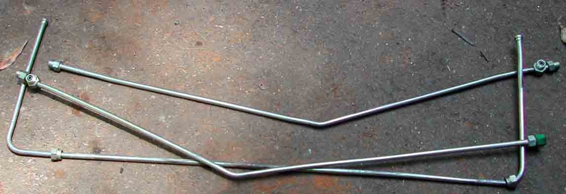

As I proceed with my FEL fixes, I removed and straightened one of my
4 hardlines. This one has been replaced previously with a JD retrofit. Notice
that these come in 3 pieces, instead of one, so it can be shipped in a
smaller box. I have worked with these before, but I do not know how
these compare cost-wise with just making a new hardline. Anybody do
that?

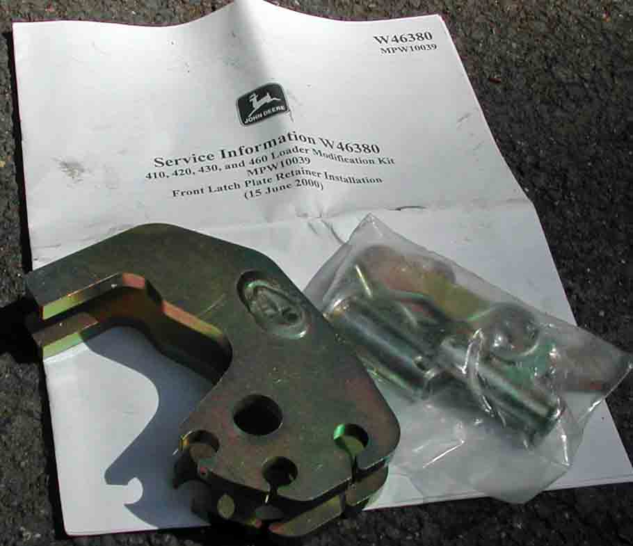

The 2nd and third pix are of a JD FEL retrofit latch, which I imagine is
a response to problems with the front QA mechanism on the 4x0 loaders.
These came out a year or so after the 4x00 tractors did, based on the
date of the instructions manual. This is not a problem if you use the two
bolt holes to secure the loader plate (3rd photo). Anyone have one of
these? Was there a recall notice? Maybe they were just installed by
the dealer or mfgr on units sold after mid-2000?
