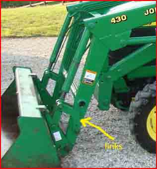

I was wondering.....do all the 420 loaders have no bucket links like this
430 loader has? I also notice that the 430 loader does not seem to tie
the QA brackets together, as my 420 does with long 1" rod. This photo
was snipped off an eBay listing.

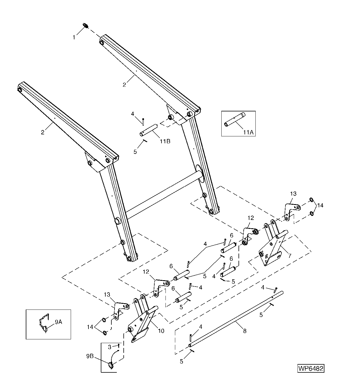

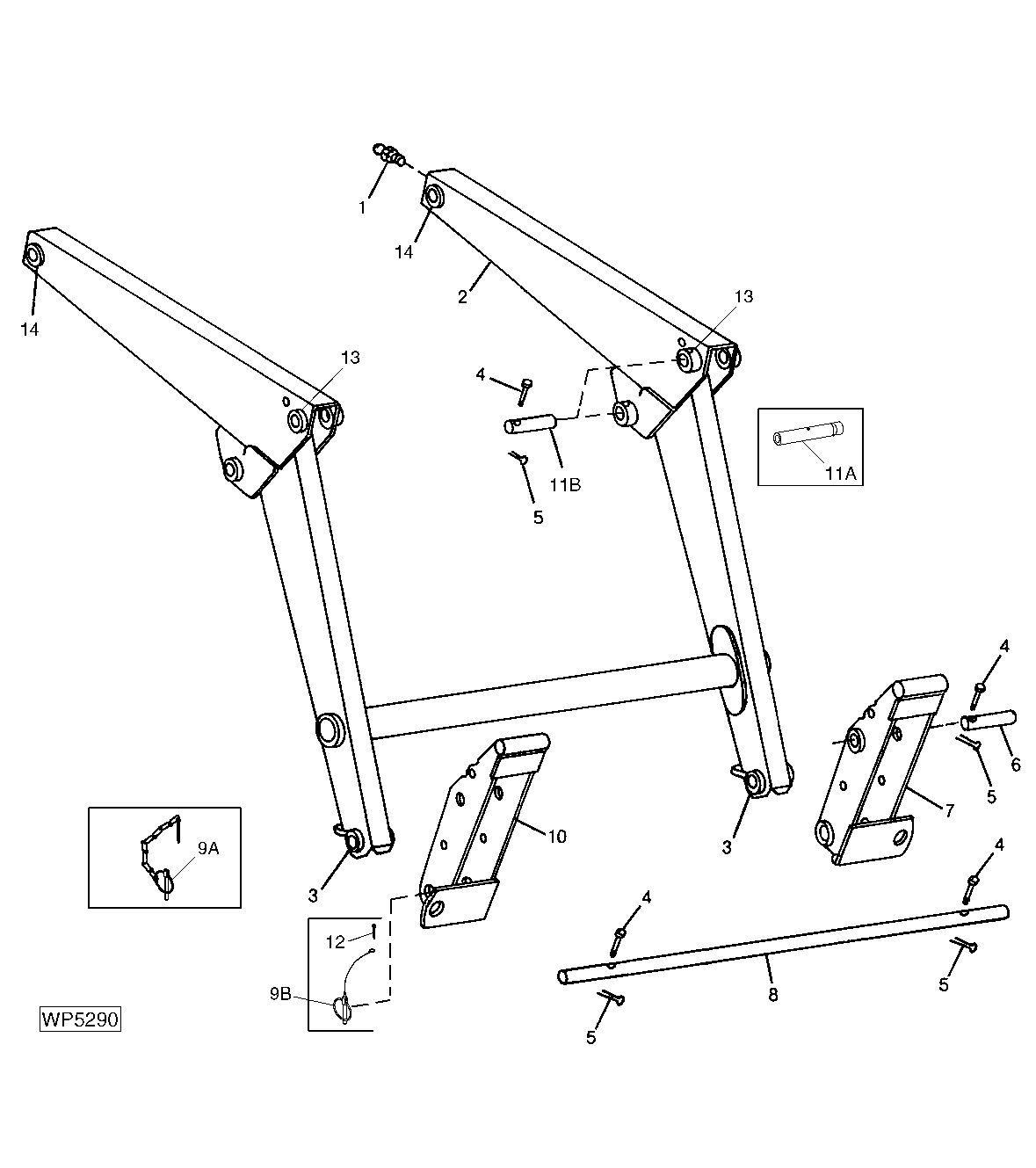

the QA brackets together. as my 420 does with long 1" rod. This photo
410/419/420 picture first, 430/460 picture second from JDParts:

Thx for posting the parts dwgs, Kenny. It looks like the upper rod (#8)
on the 430 I posted has been tossed out. That's a mistake as the
loader boom arms need to be tied together so they don't get twisted.
Having the links is nice, though.

My 420 doesn't have the links. I wonder if they give more curl angle, or if they were used in order to use the same cylinders as the 420 on a longer frame. I'm thinking links were cheaper than having another set of cylinders to manufacture and inventory. Just guessing mind you.
The links are there to make the bucket curl forces "stronger"....without the links when the cylinder is totally extended the leverage is less because the 2 pivot points are so "close together" because of the rotation of the bucket. With the links, it allows the force of the cylinder to "round the bend" and still have alot of leverage. Dunno if I am confusing you...this all makes sense in my pea brain...dunno if I put it on paper elegantly :confused2:
