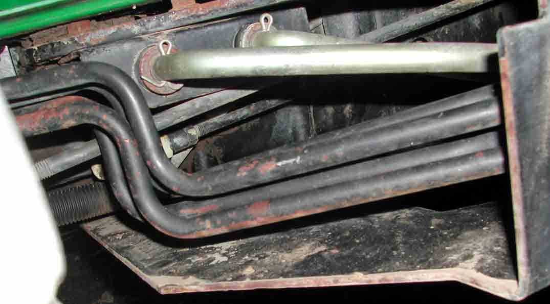

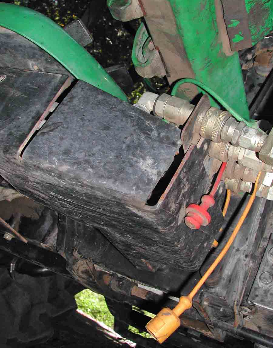

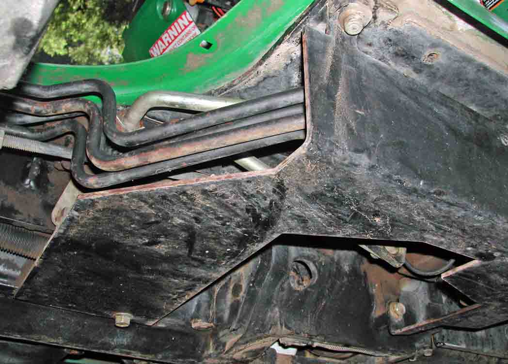

Here are some pix of the underarmor, which is part of a rental service
upgrade kit sold by Deere. I posted one photo of another unit that had
this option a while back.
The plate is about 1/8" steel, and is bolted to existing holes. It does
not connect to the hydraulic line supports at all. Since it is mostly
horizontal, it collects quite a bit of dirt (cleaned off in photo). You
can see how nice the hardlines look, compared to the unprotected ones
on my rebuild. The armor does not protect the large steel pump inlet
line on the left side, or the central suction filter cover, however.
Also notice the two HST control rods in the first photo: they are totally
different from the bar stock used in my older rebuild unit. The unit here
seems to be a 2001 model, based on the date stamp on the 3-pt cyl
housing. Many differences!

Thanks for the pictures Dave; the last one answered my question as to how they handled the area around the quick-connects. I can imagine that armor will be a big dirt collector; but it beats shelling out bucks to repair hardlines.
You're right about the suction line and main discharge line being vulnerable.
BTW, the under-armor piece is still available; but the kit isn't, which is no big deal since the kit consists of the main piece, and some off the shelf fasteners.
