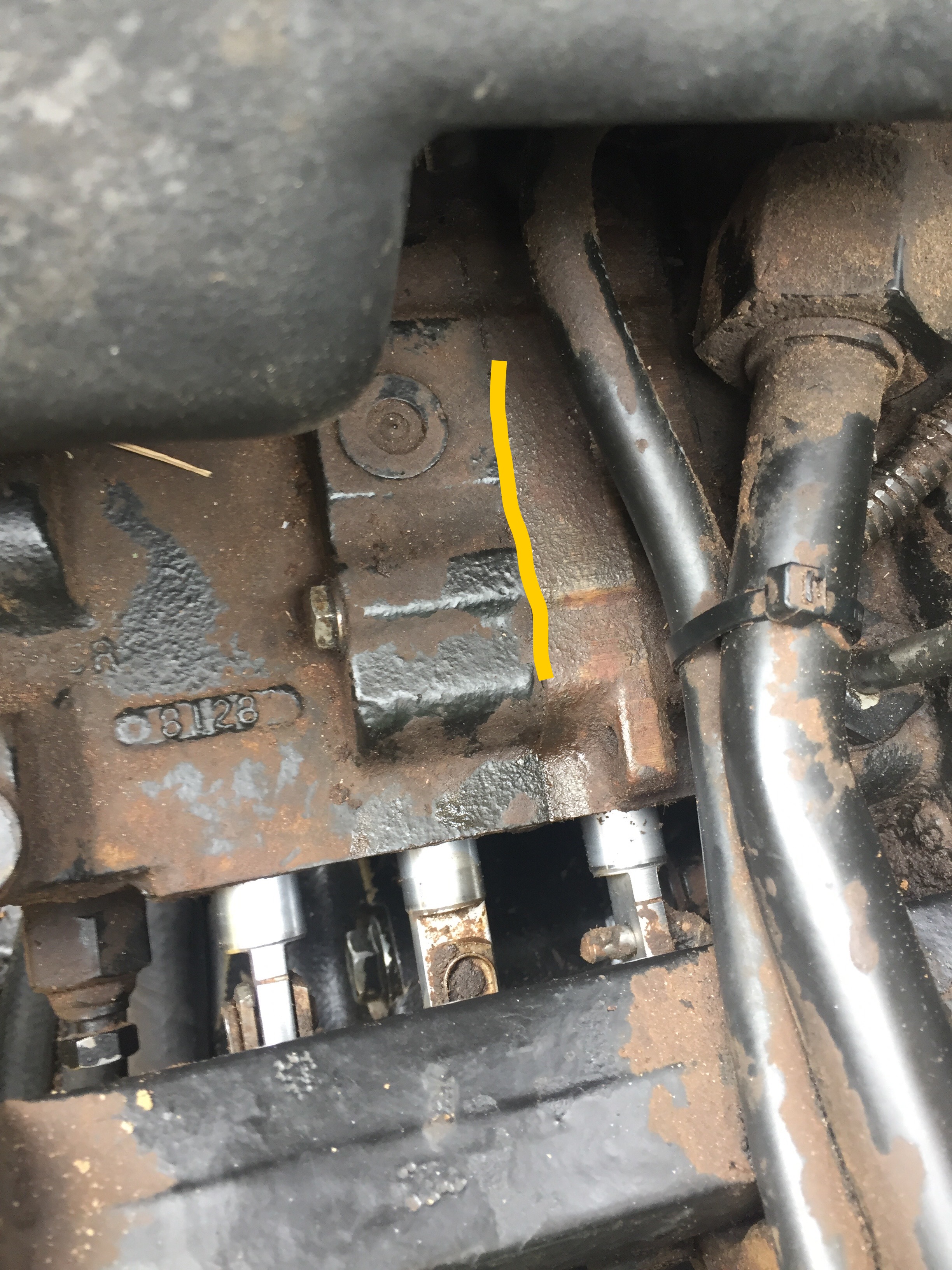

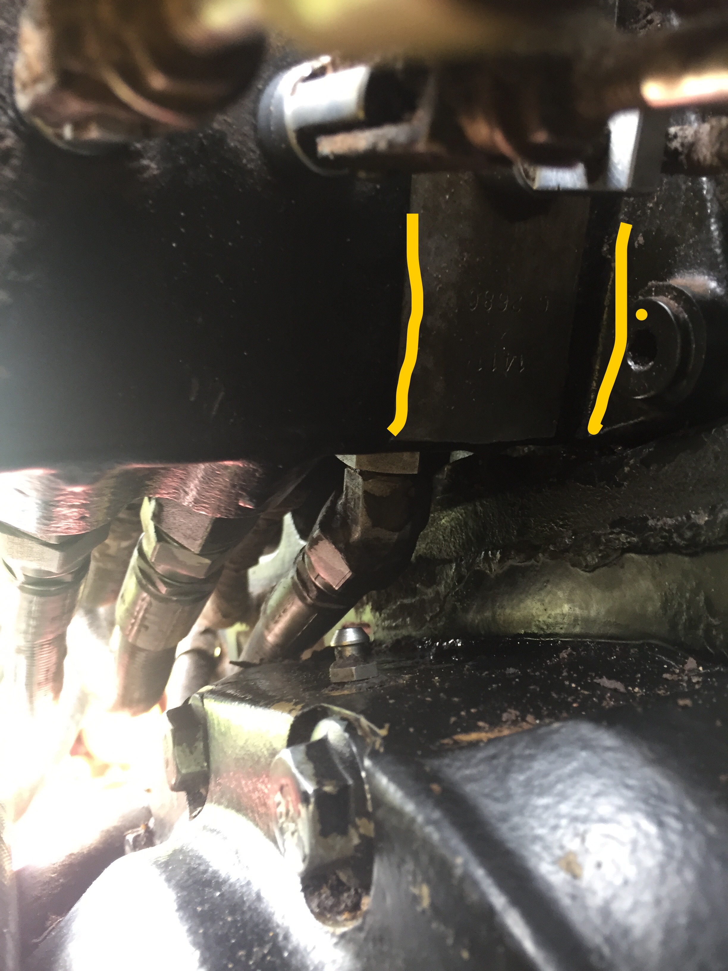

Sorry about that, here is only 2 pictures that are different. I didn't realize I posted the same two 3 different times. The leak is in between where I guess what would be considered the housing?
   / John Deere 5310 Hydraulic Leak
#12
Here are the same pictures. Where the yellow lines I have drawn are where the leaks are. IMG_3747.JPGIMG_3748.JPG

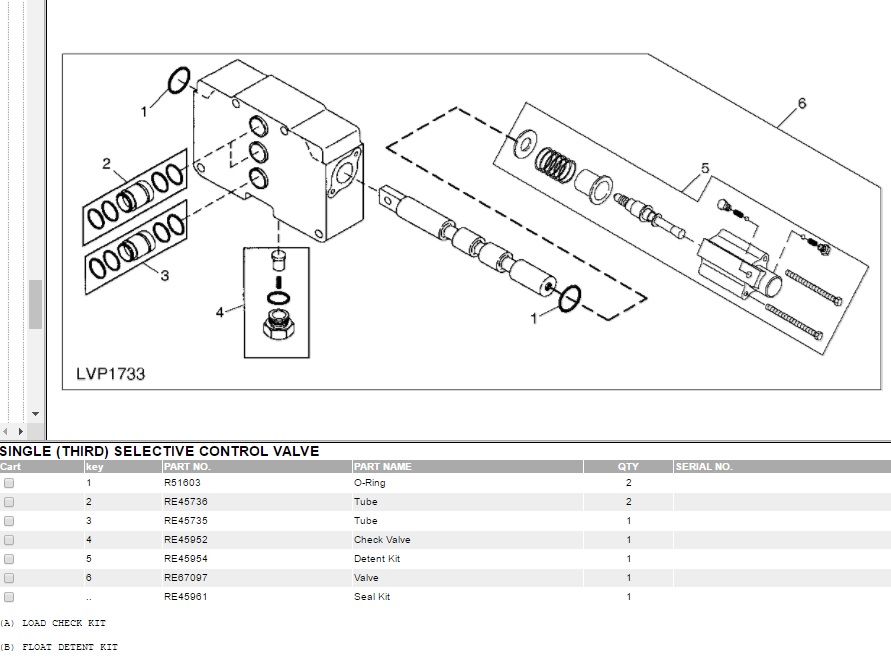

Of the 6 pics posted, are there just two that are different? Or some subtle differences you want to show between the six ?? Just curious...
Maybe an arrow to show where the leak is.. or what is now a seep.
The 3 SCV are mated with tubes and o-rings.. no gasket/seal, if I read the parts lists correctly.
What parts list are you looking at Beenthere? I have looked at jdparts and am not able to find anything that looks like an print where the housings join. Thank you
#14
After looking somemore at some selective control valves it doesn't appear there is an outing in between the housings. Just internally on valves, and housings are just metal to metal. Would I be leaking because the internal prints are worn out and need replacing?
   / John Deere 5310 Hydraulic Leak #15
