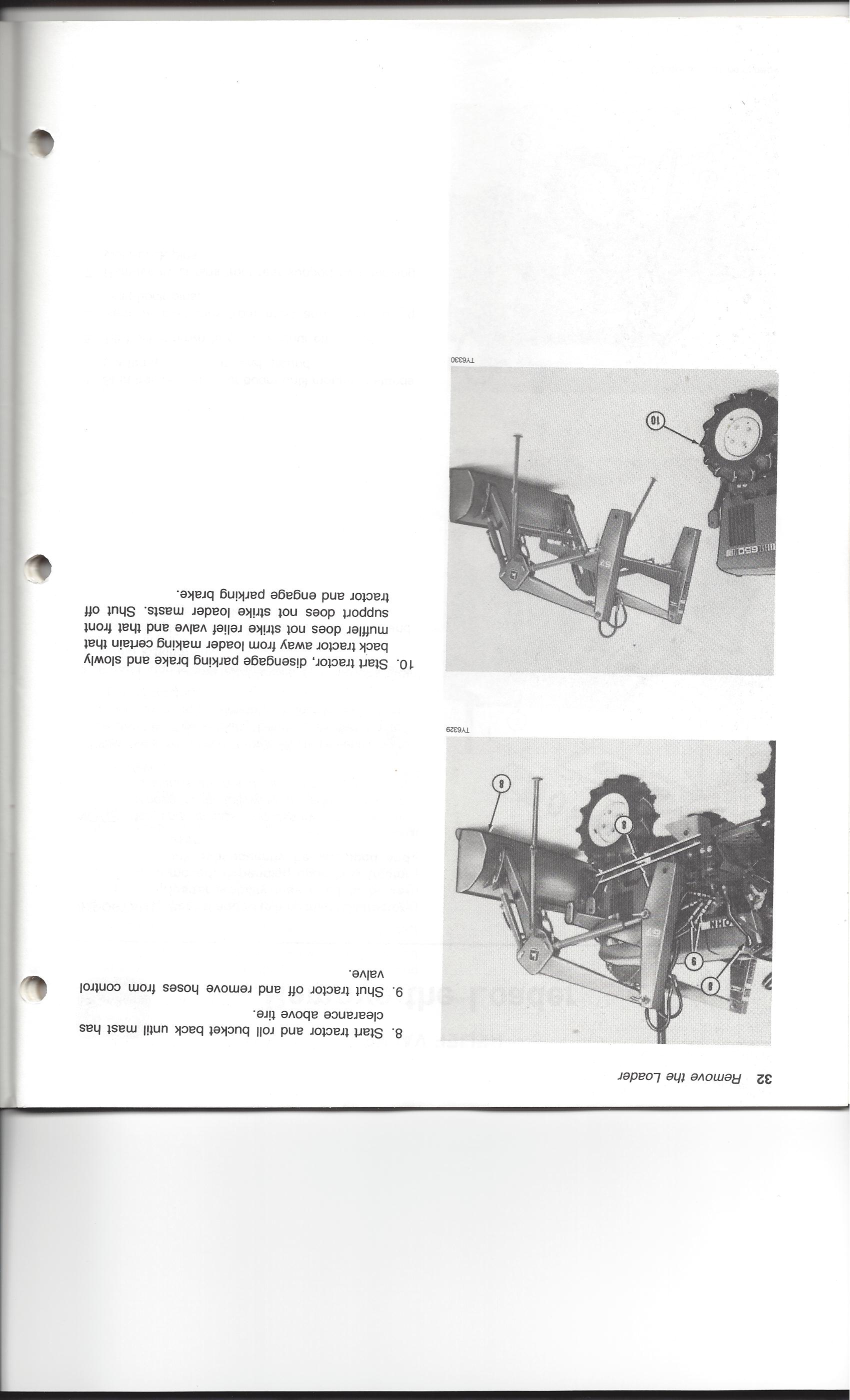

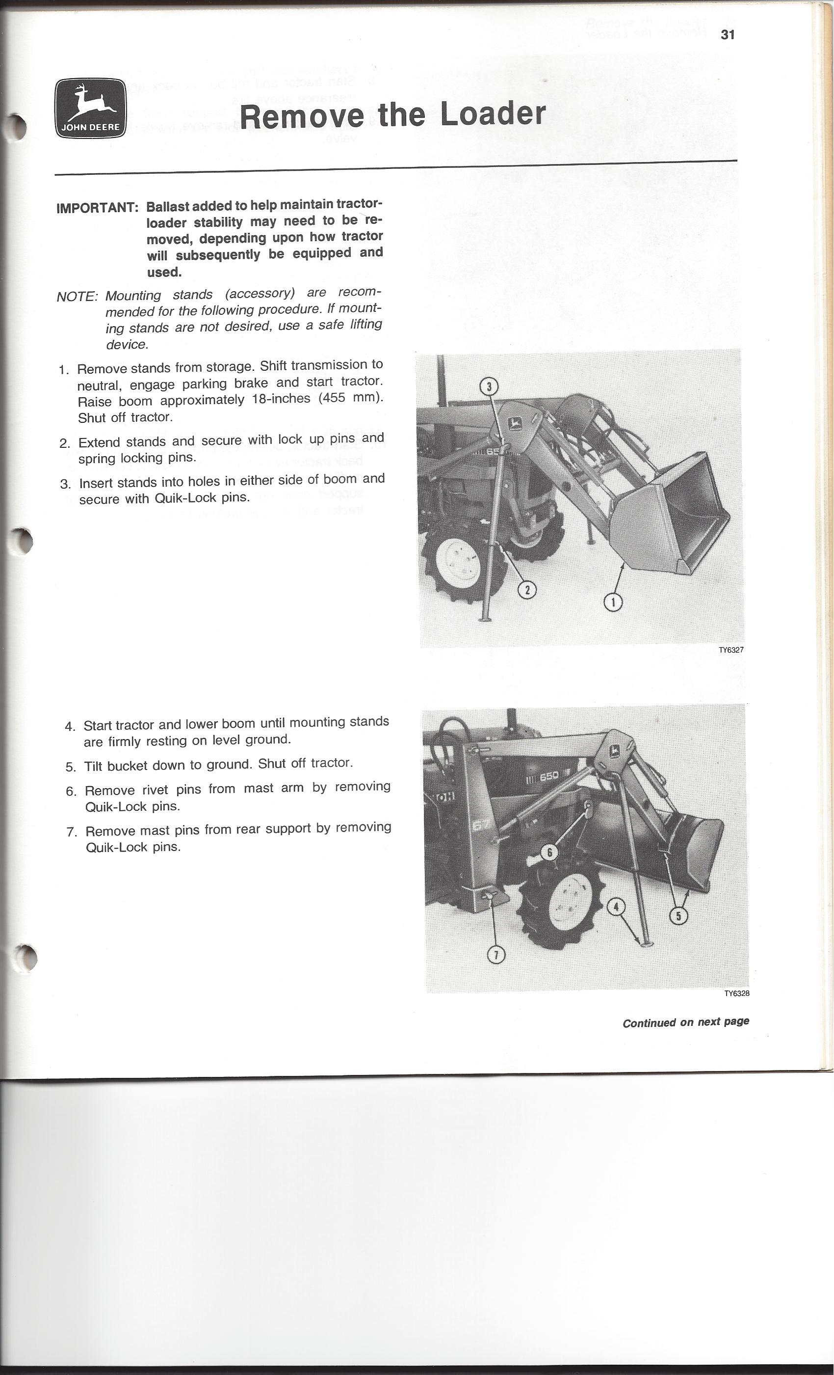

I know this is in the wrong section to ask, but how do you take the JD 67 loader off of the tractor? I know how to disconnect everything, but how do I physically remove it? I need a way to get the part up so that the front tires can clear the loader. Does a stand go with it?
   / John Deere 750 with loader #27
Two stands are needed to support the loader (1 for each side). Did they come with the tractor? Please note they did not store on the tractor, so they are easy to misplace. If you look on the loader arms there is a square hole where they go in when needed. Since I don't have the manuals any longer I can't give specific details how to remove.
#28
I do have the two stands and I did find the square holes. I'm assuming you just lift the FEL up and then attach the stands and then lower the FEL.
   / John Deere 750 with loader #29
Here is the removal pages from my 67 loader manual. Hope this will help. Scan.jpgScan2.jpgDidn't catch the one page was upside down, sorry.
