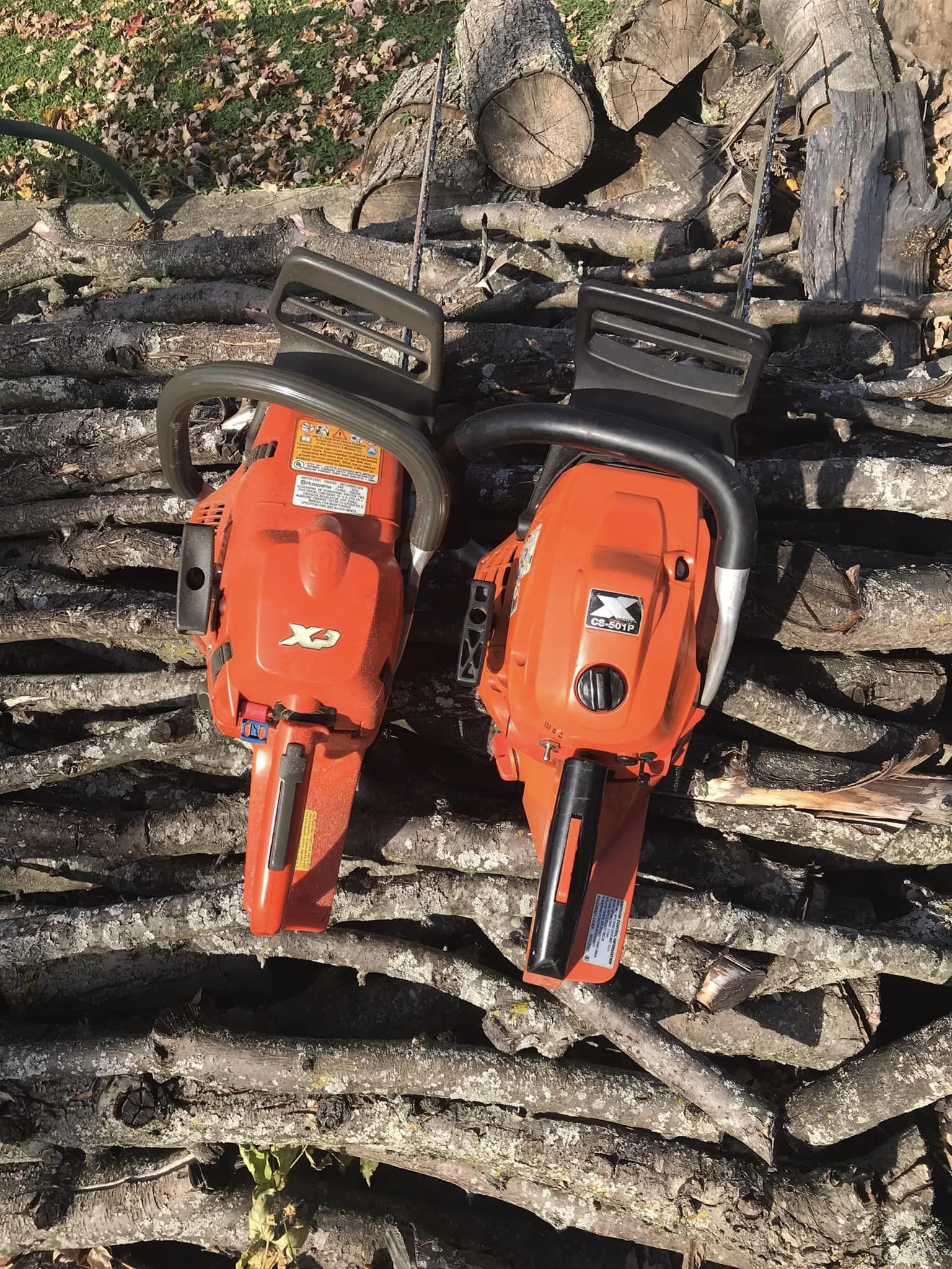

The 4910 is basically the same saw as the 501p and it’s an excellent saw, more pro saw than home line. The 590 is also very good. Avoid the 4920 if ya can. The 4910 is in my top 3 best bang fir the $ in the echo lineup. They’re going away so get one while ya can.

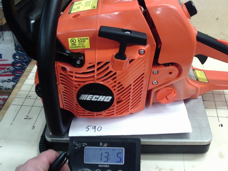

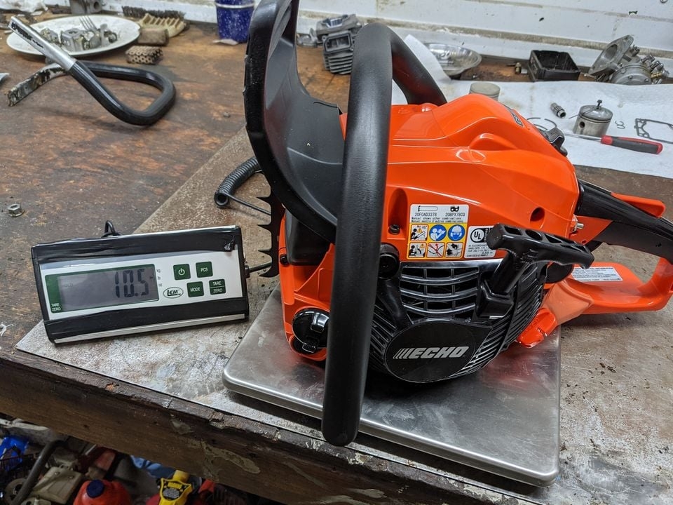

455 plastic cased saw. 4920 heavier then 4910 it replaced and 4920 plastic cased saw. Pass.
4910 is just cheaper version of the 501. 4910 came with plastic handle and black covers. best bang for the buck in 50cc.
59cc 590 best bang for the buck.
4910 590 mag cased saws.
Just got to decide whats best for your uses.
I have slowly over the years went to smallest lightest saws to get the job done myself.
PHO dry weights before adding mix,bar oil and b+c.

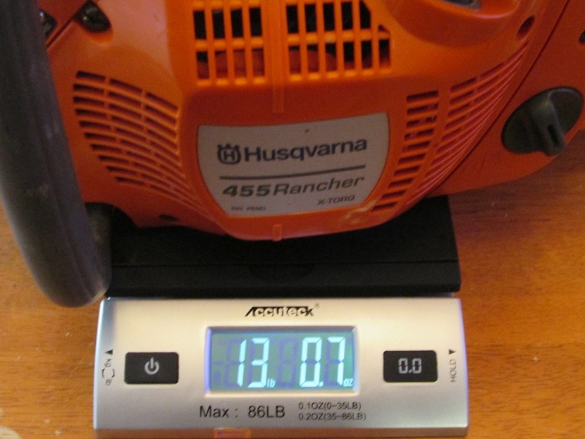

Their fine and cut alot wood for folks, even locals. I work on them for them. Strato dang saws too.
But better saws out there for the money.
I wont suggest them for the money they cost.
Pic of one tore down in my repair group. Clamshell design with plastic case.
Weight PHO

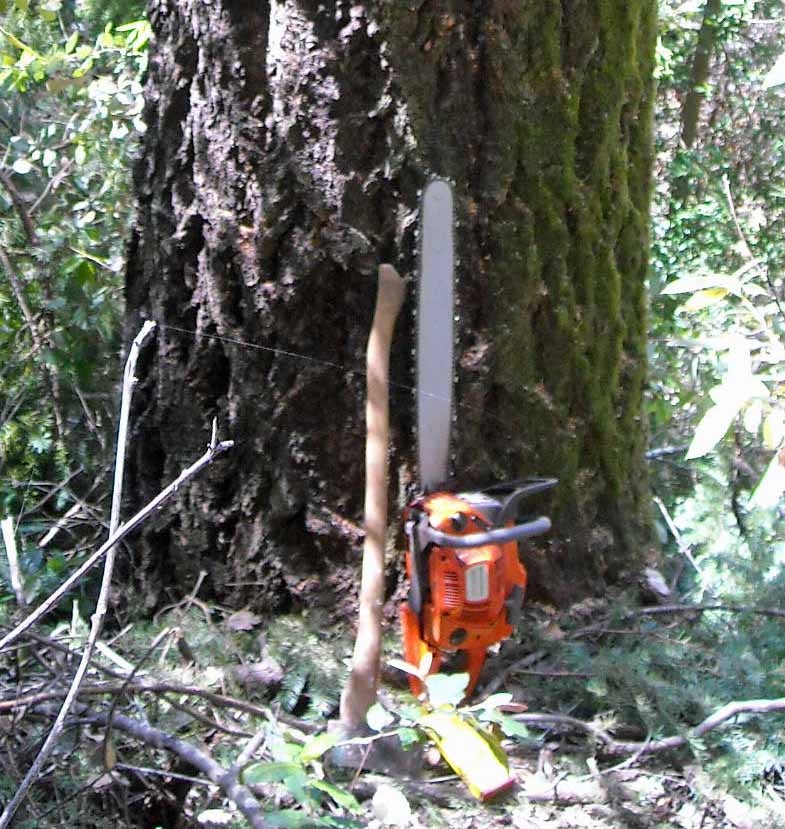

I bought my Rancher 455 20y ago, new. It still runs great and has never been rebuilt. Even the primer bulb is original. It does not leak oil, and does not even need re-adjustment winter-to-summer. Both of my Shindaiwas need readjustment.
That said, it is kinda heavy, as XYZ shows. It has a plastic hoop handle, which will hold up if you don't drop it off your truck. I got it from an internet dealer with a 24" bar, which is bigger than you can pull, fully embedded. But I got it for reach, and it has served well. I use it often, which keeps it going. Very common and popular saw.
I don't get many Echos, but I hear good things about the 590, which I would love to try out. If you can get that at the Rancher 455 price, go for it.
