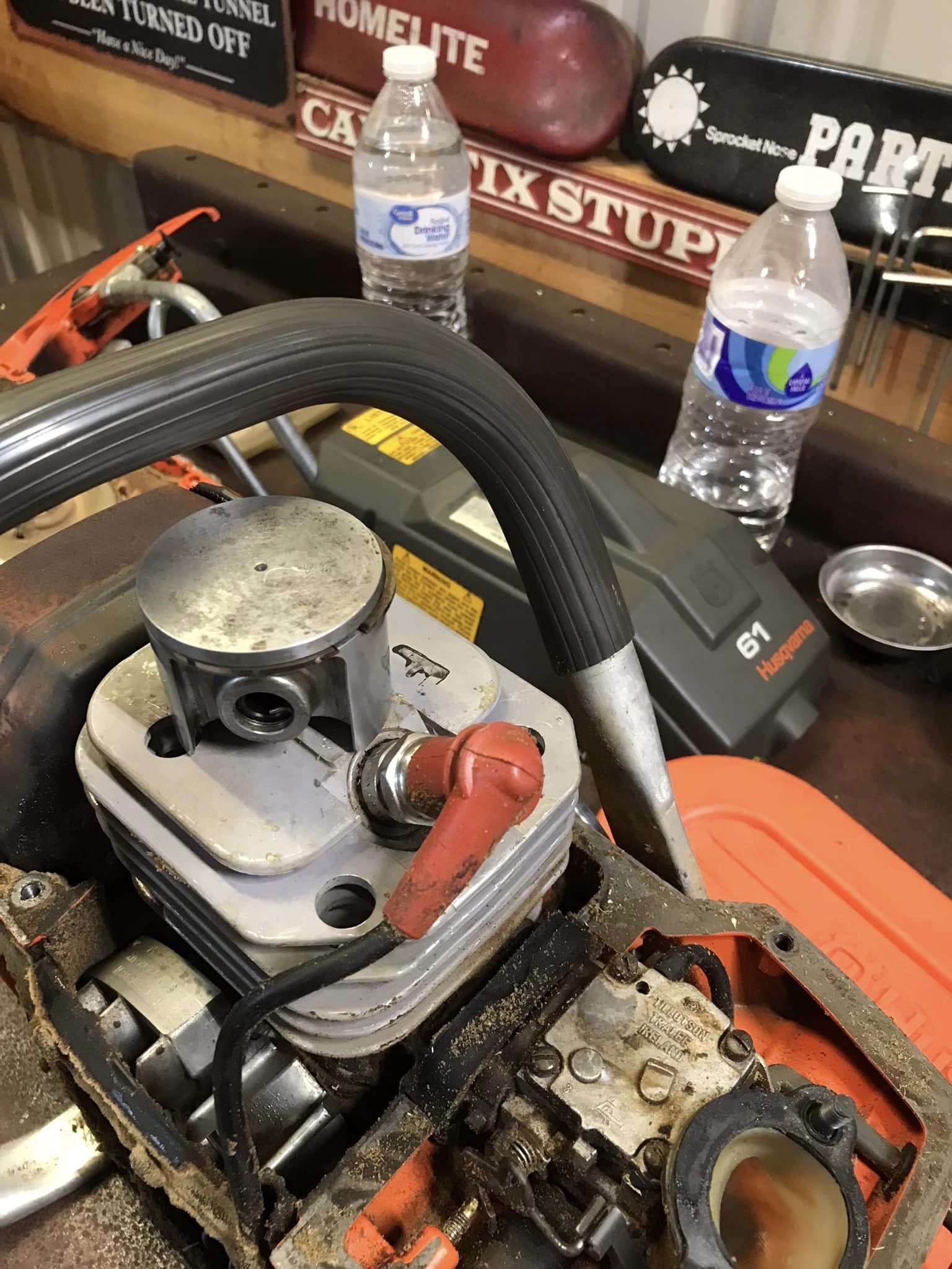

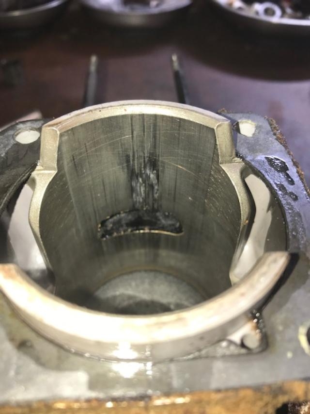

Nicer oem piston. One in it has a carbon scoring mark on ext. Pulls 160psi. But to make it nicer for next owner when I flip it.

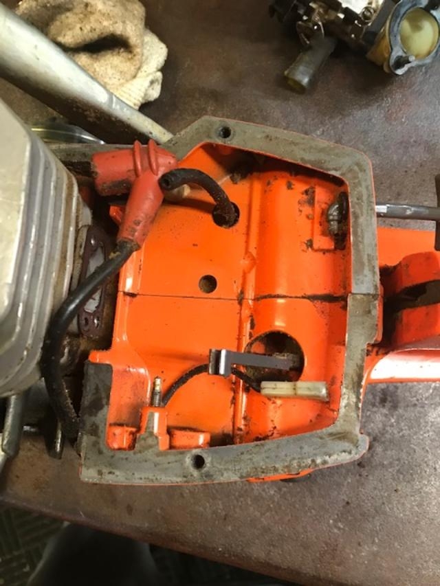

Tore down and cleaned up 61 yesterday morning.
Such a easy saw to work on. Like working on the 60's cars I had.
Before after cyl.
/ Just another junk chainsaw
#1,723
Started right back up too.

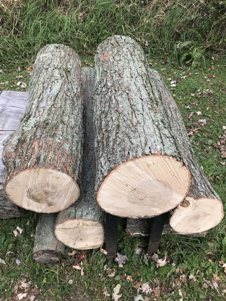

12x13 round used, one on top

Wanted to see what the cylinder looked like under the dark stale mix coating inside cylinder. Nice bore under there.
Poulan 365 60cc cylinder before and after cleaning.
Didn’t even need my first 2 steps. Just did the 3rd one with fresh crosshatch.

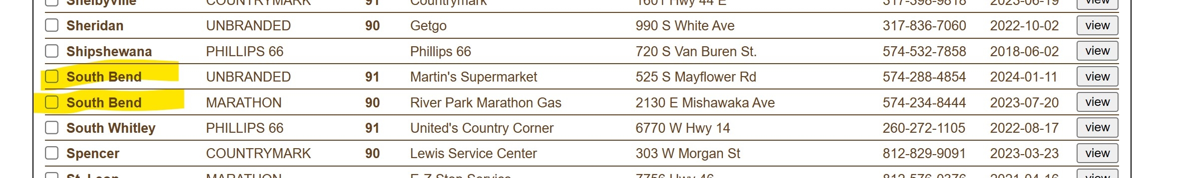

FYI, this site lists 2 stations. 90 and 91 octane, if accurate, you got the good stuff.
/ Just another junk chainsaw #1,734
The first one is the one I was talking about. I've been going to that local chain since I was born for groceries with my mom. The cashiers used to give me one of those suckers with the loop sticks. Grape! 😛
The second one is in the next town over.

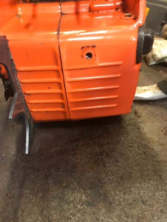

Even opened center baffle and opened the closed exit they did on these. Like they were purposely killing the flow out. 2 small holes at bottom of baffle to go through. I did just enough as I like them to look stock still.
Not with a 61 you won’t. Runs like a open port 60-62cc saw.
Surprised they were doing that crap even in 86.
