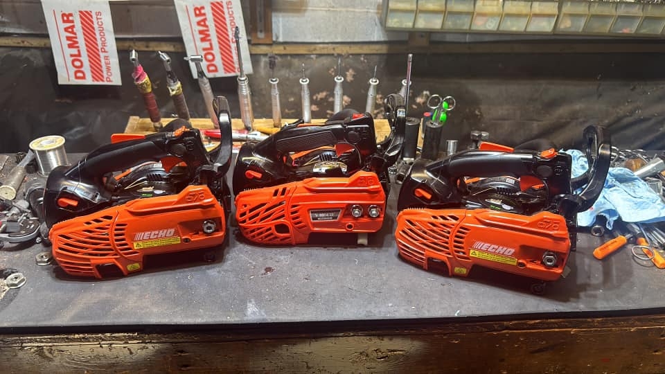

Just so you guys know thats on a budget and want a light 25cc clone of echo 2511.
Their out since last year and in states now. 149-159 gets you one it seems.
Weigh 2 ounces more then oem, so like 5lbs 6oz I think PHO dry. Have 2 bar studs instead of one. Carb venturi measures smaller. Few folks in my chainsaw repair group tearing into them to see. Also the 1/4" mini chain bar set ups with drum can be had for 50 more for them.
Just thought some might find it interesting too.

Forgot this. One of the caps were smaller too.

#1,768
Was dealing with roof repair for 2 days. So today I can get back into the saws.
Got the deflector on echo 501 to where I wanted it.
My whole reason for what I am doing is trying to keep the hot exhaust from blowing out the sides and melting brake handle.
Just using the oem deflector again 4910 501 490.
Just like 590 620 there is no reason for those pricey aftermarket cnc ones unless just being to lazy to do yourself.
This saw is easiest dang saw to start. 1 pull cold pops and 2 afterwords.
No clue why decomp as never used it on this. Maybe for folks with shoulder issues or once ported.
