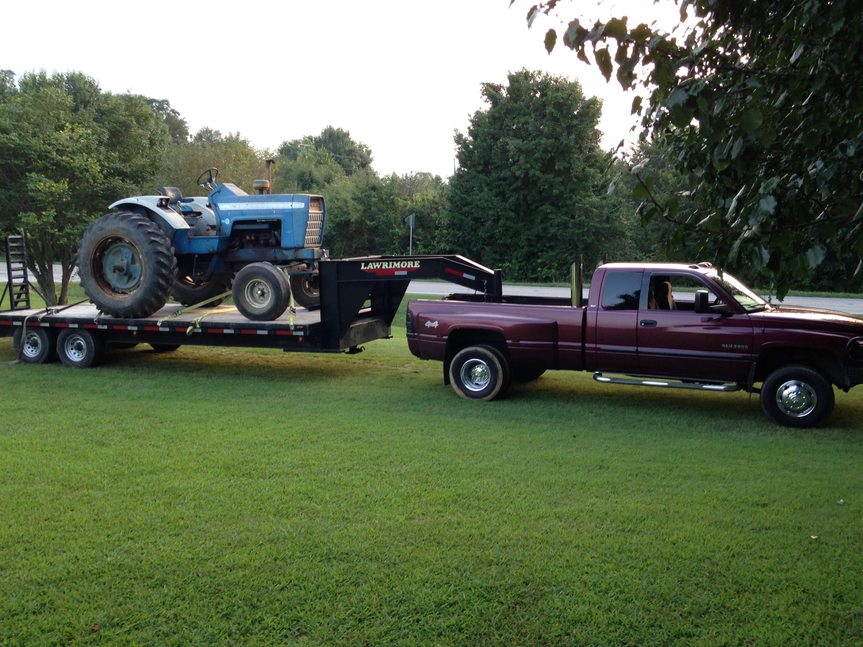

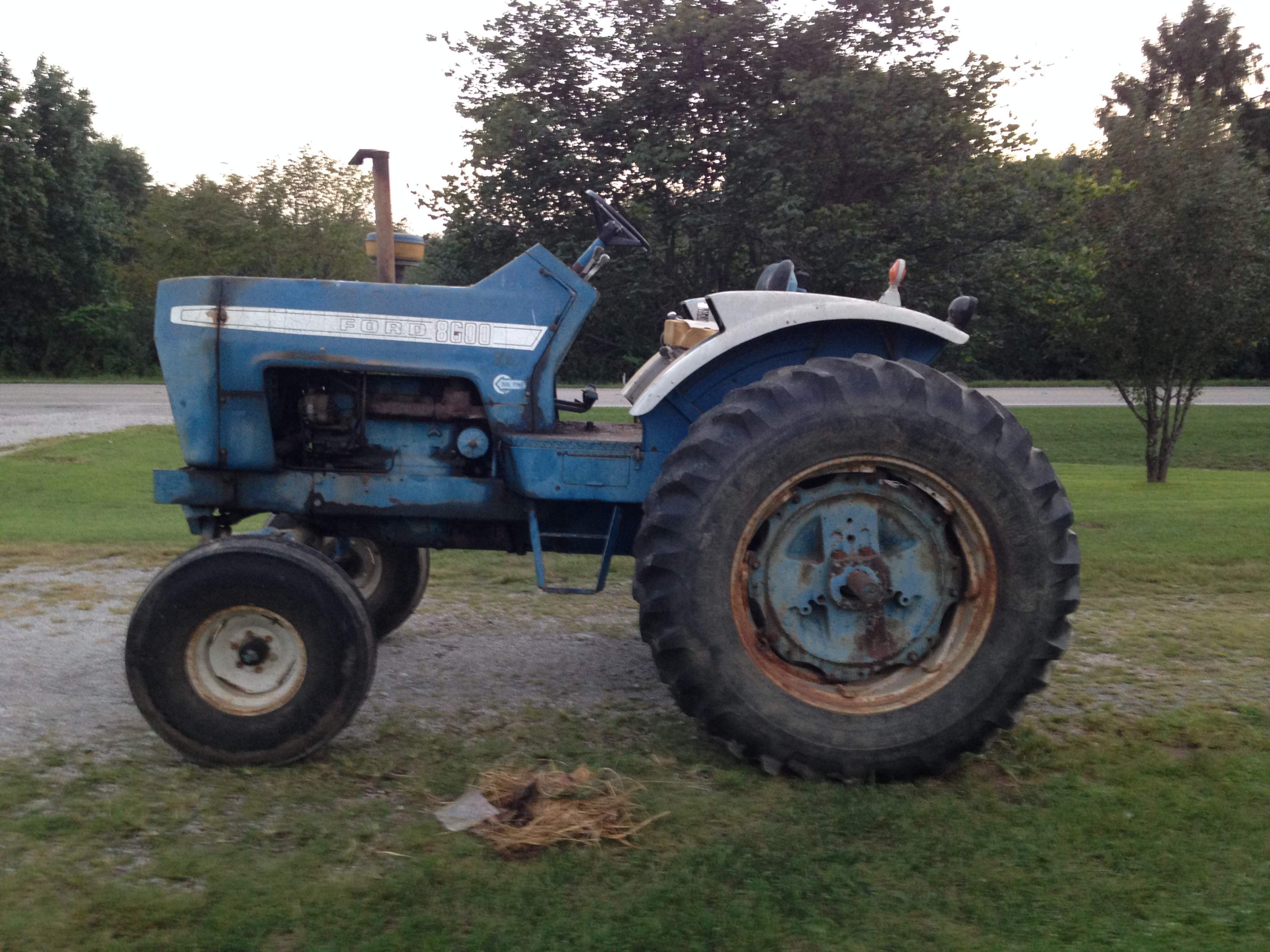

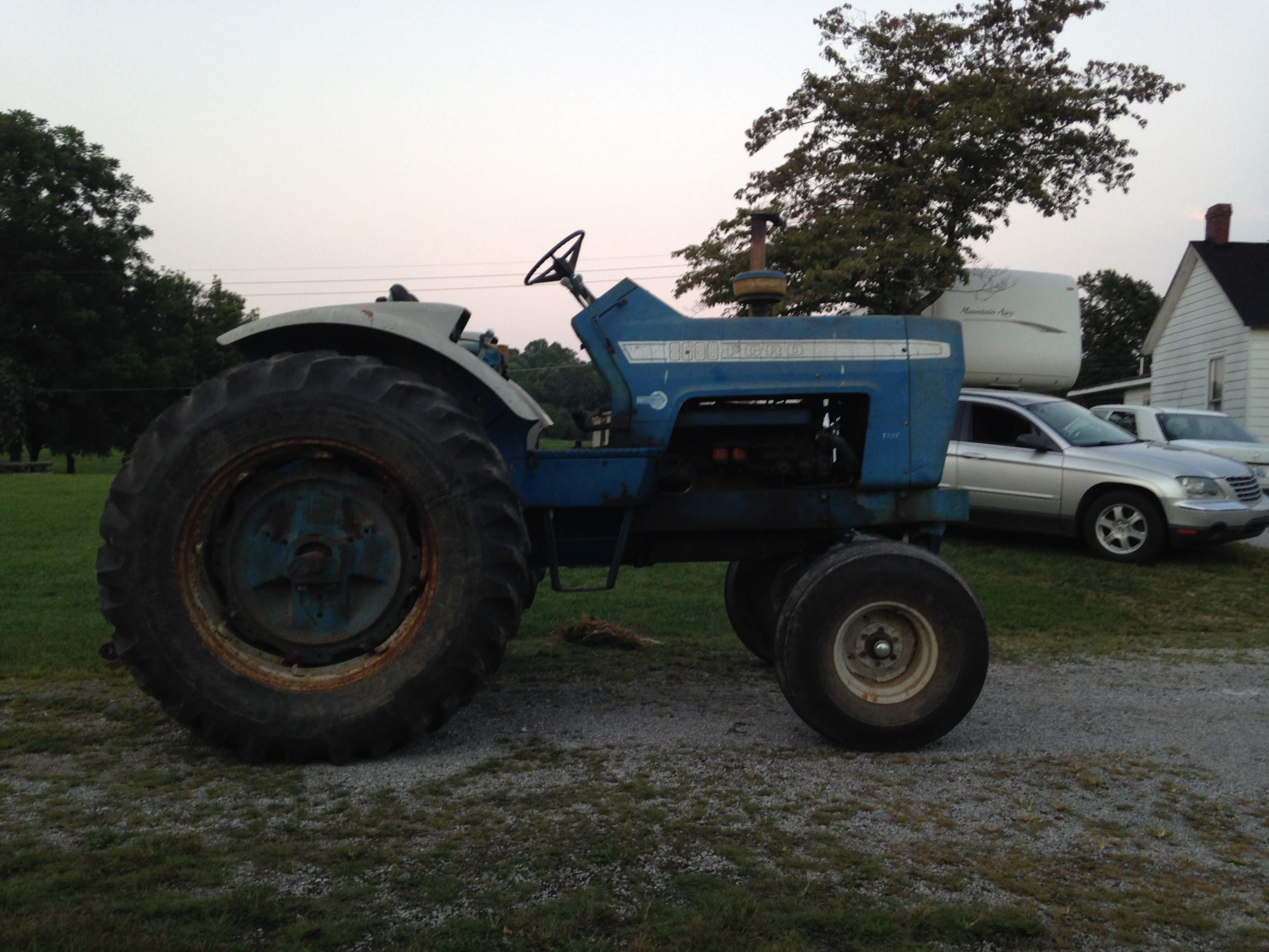

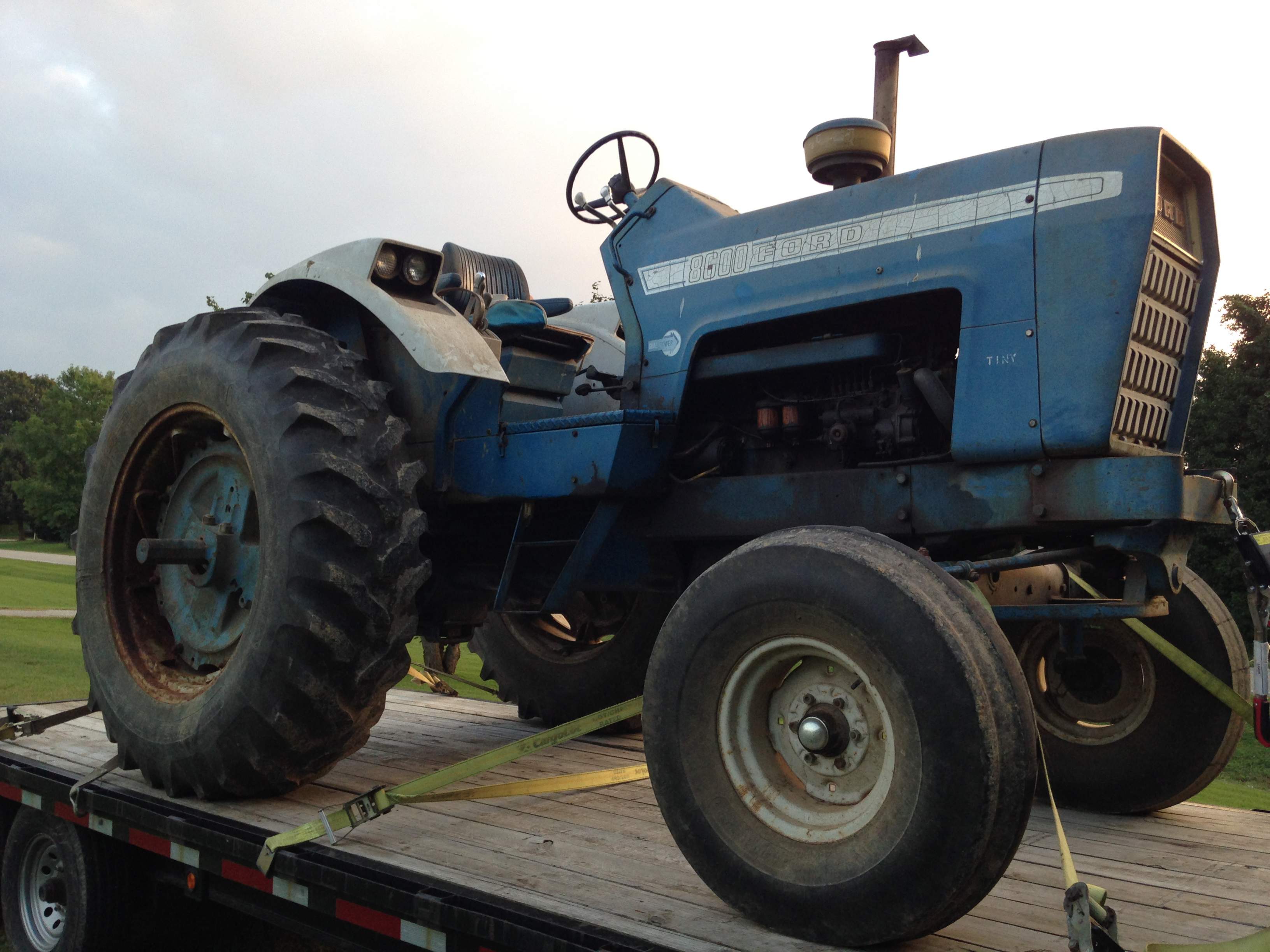

So today i went and bought my first personal tractor. Having grown up on a farm in my earlier year's and as i've said in my welcome post in the forum i wanted to dive back in to farming. So i caught wind of a great deal on a 1970 Ford 8000 in great shape. The tractor had 5950 hrs with a total motor rebuild at some point(was told but no proof). Every thing works needs a bath and a tune up (fluid's, filter's and etc.). But i got it for $3500 and it was only 25 miles from the house so that was a plus. Here are some pics will get better ones after a good wash, degrease, and wax...lol Anyone have any first hand experience i've never used one only 2-3-4000 ford's big step up lol also someone messed with the decal to make it look like a 8600 new decals soon!! hehe

Congrats! That's one BIG tractor. Hope it serves you well.
   / Just bought my first Tractor #3
Nice looking tractor!
That should get some work done.
I see someone named it Tiny.

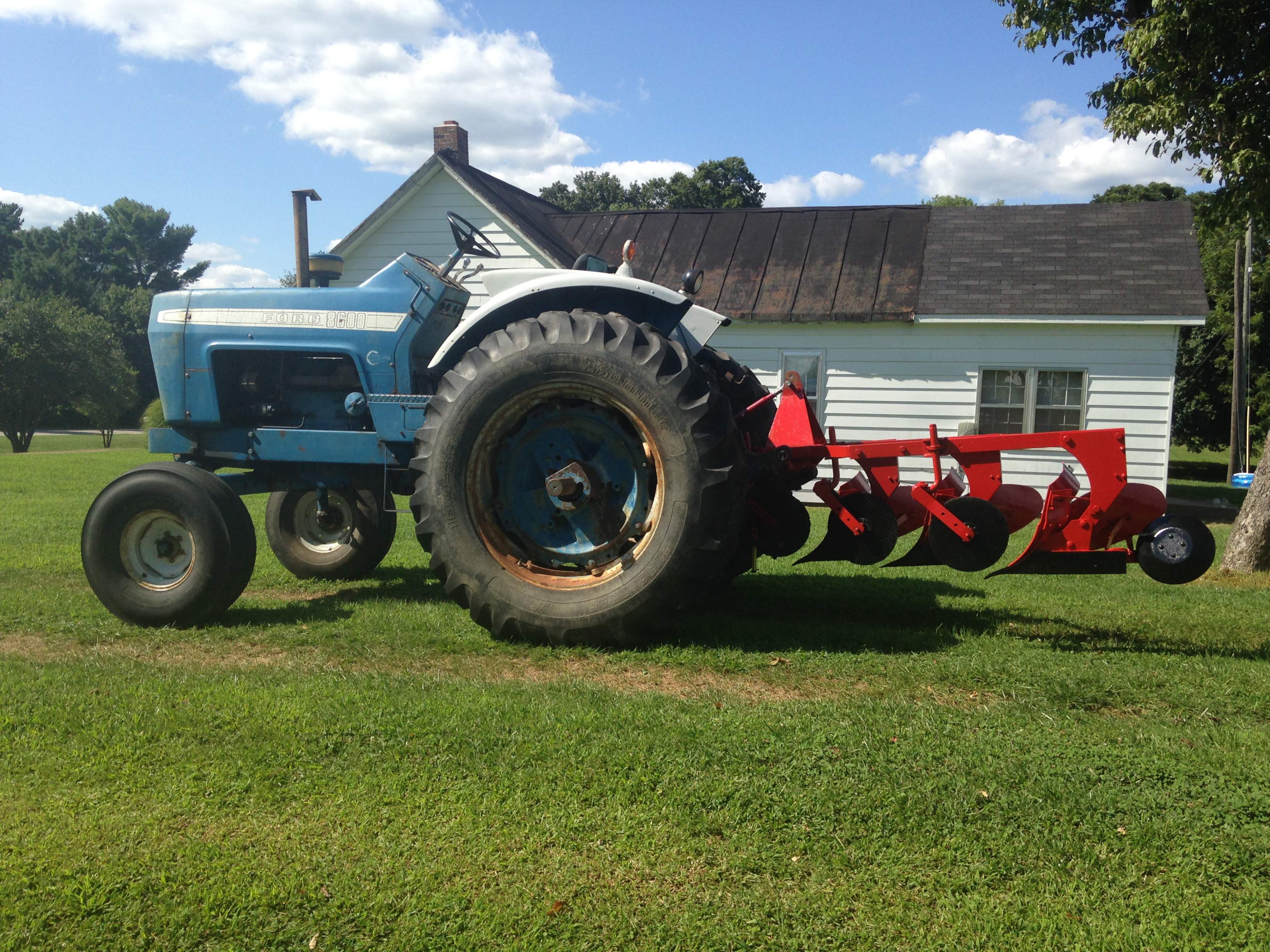

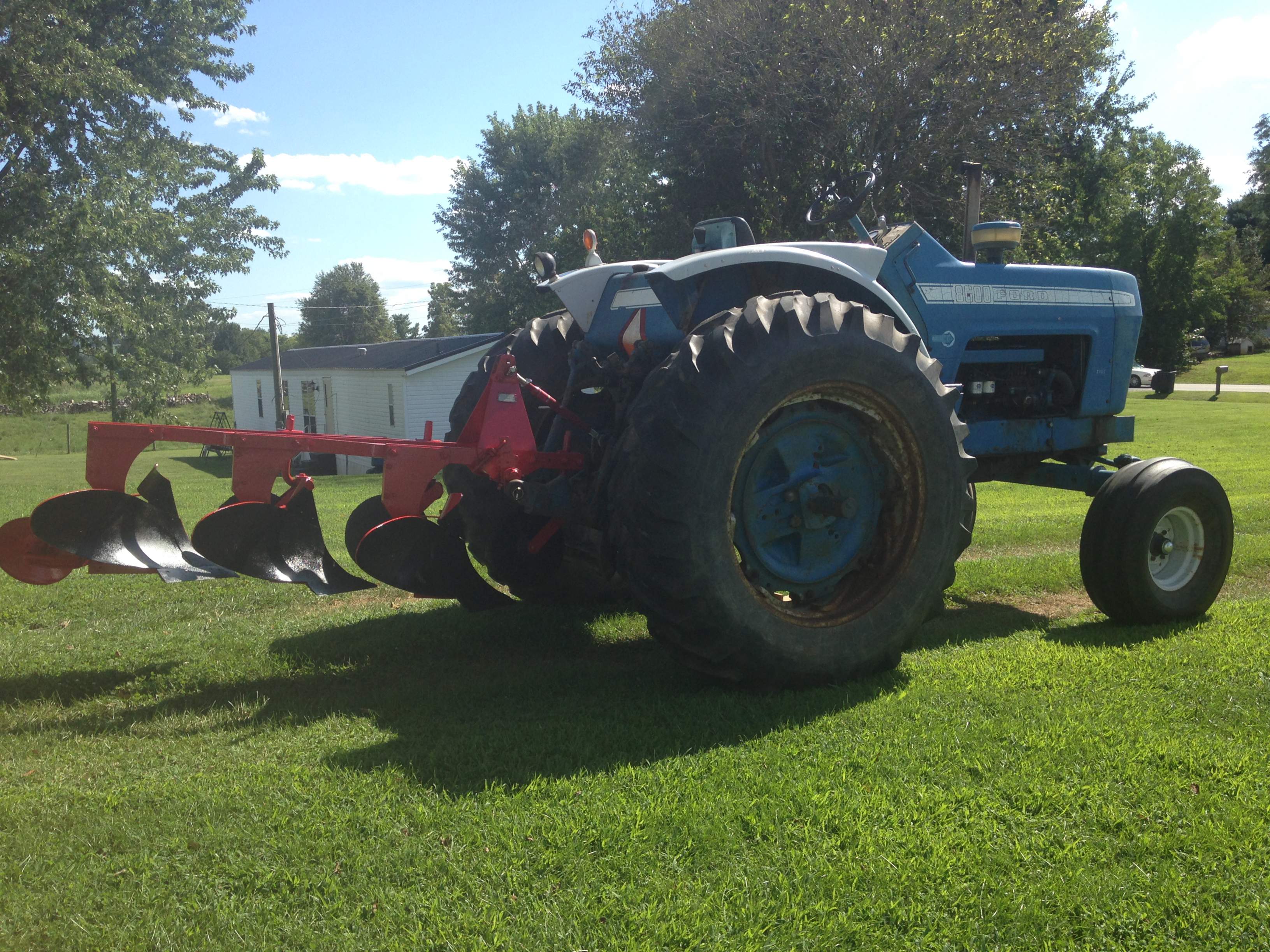

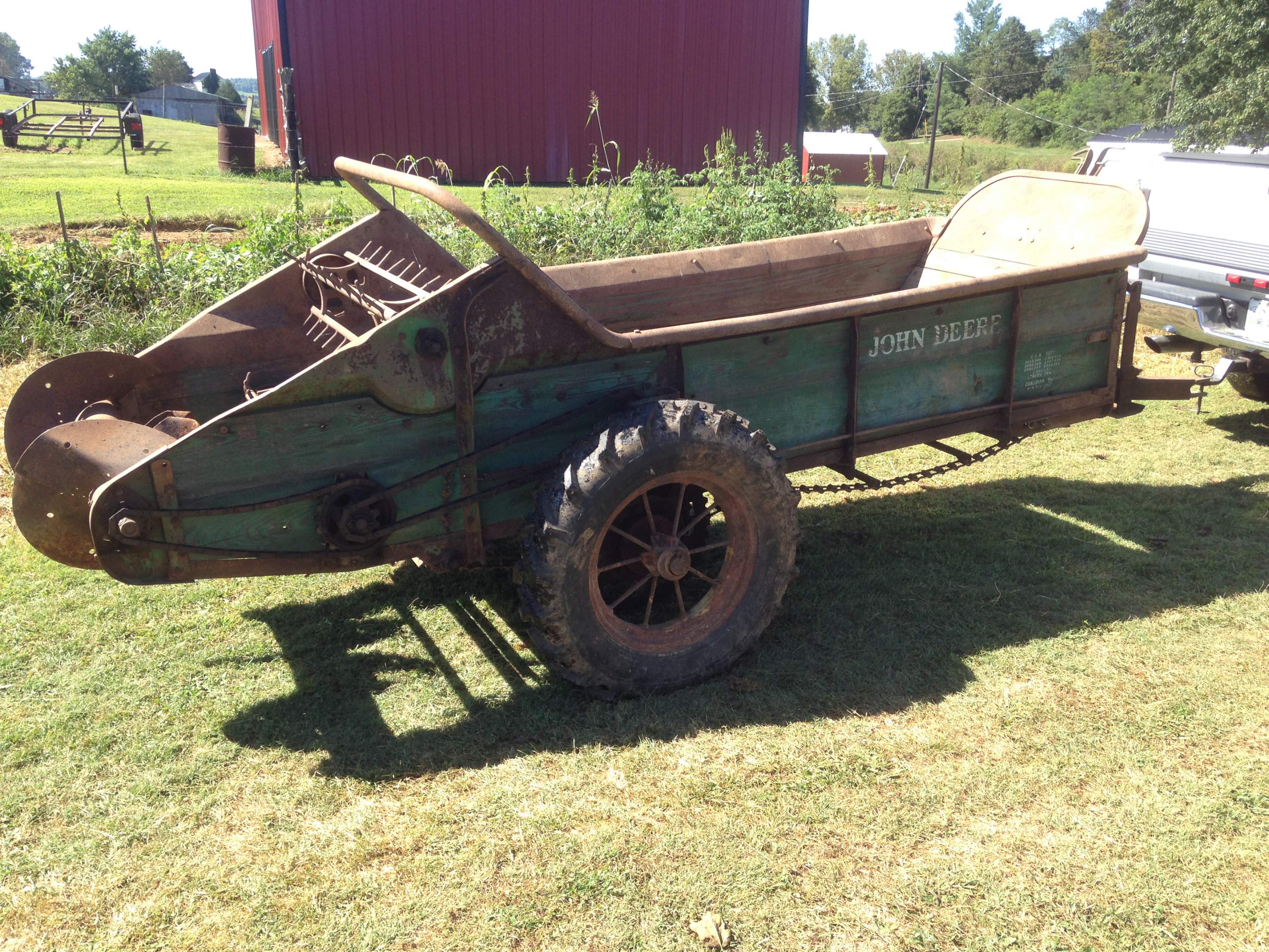

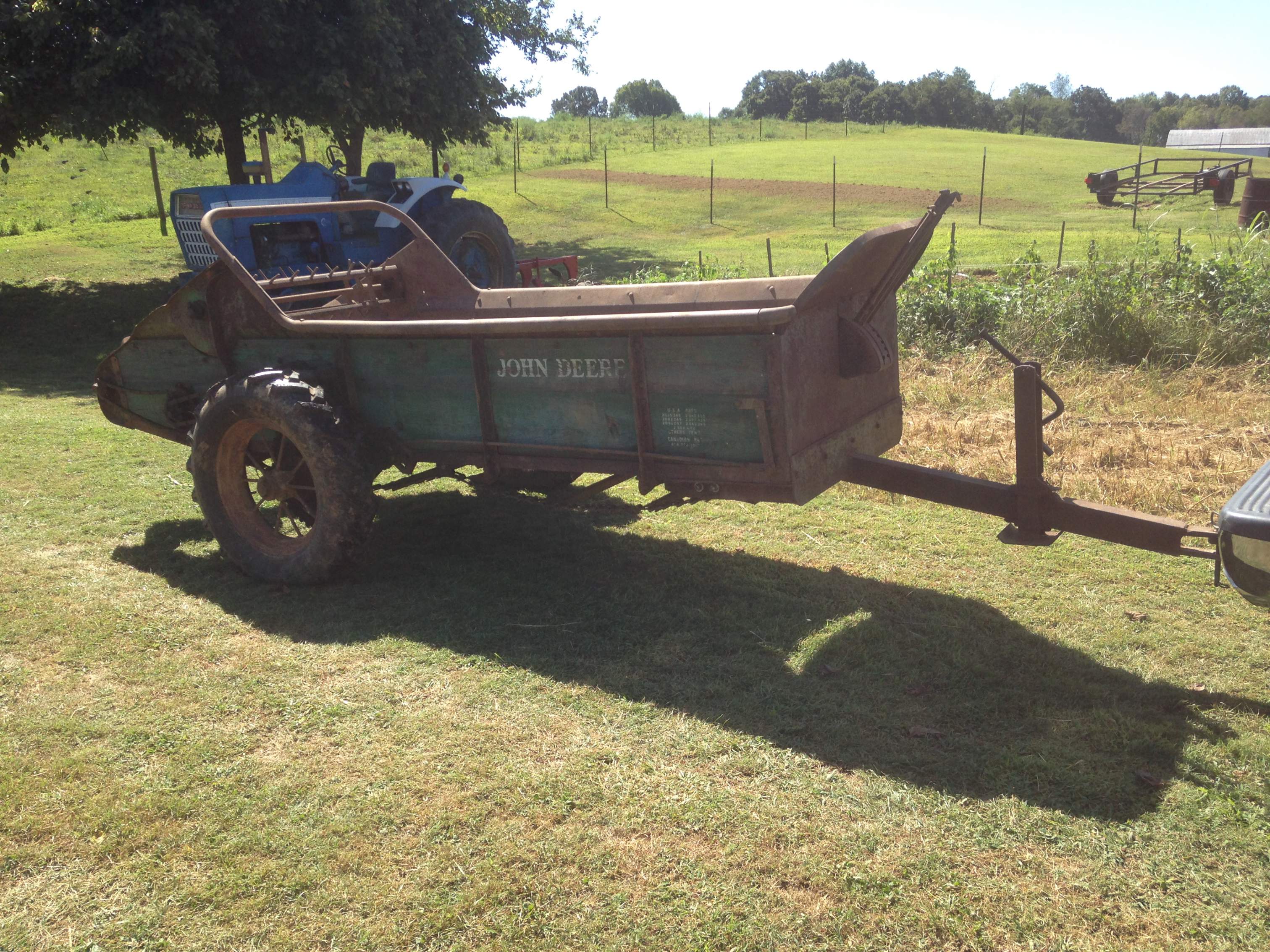

Thanks all and yeah it was there premium hydro fluid for tractors. I plan on changing the fluids and filters soon. Just did filters for the moment to catch the big stuff next paycheck i'll change everything. I gotta replace the points on the 101 or grind them. I dont like how the new points are made. We did use it today just on the garden and only the front one dug the others clogged up with corn stalks since we only bush hogged not disc the field which we had never tried i see why now. lol But on a side not i picked up another piece of equipment to a John Deere Model L Series 51 Manure Spreader in great shape for a good price!! Now to repaint it and put it to wrok hehe IMG_0162.jpgIMG_0163.jpg

Your spreader is wayyyyy cool. Brings back lots of memories. I grew up with manure spreaders of various brands. Lost track of how many tons of straw and manure I've forked into a spreader similar to that. :)
   / Just bought my first Tractor #12
Forgot to mention, load from the front toward the back. Stacking the straw/manure as you go. It unloads much better. :)
