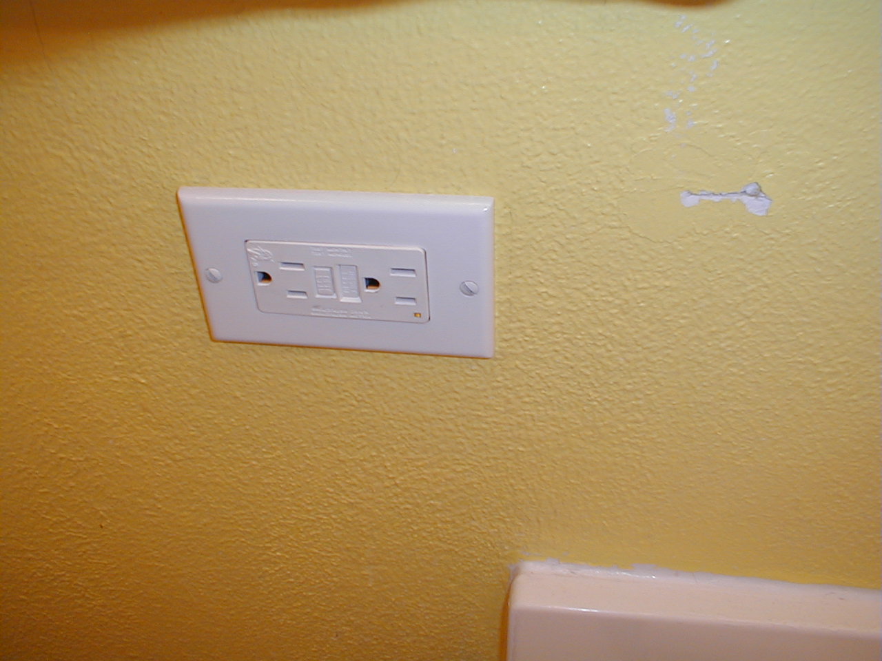

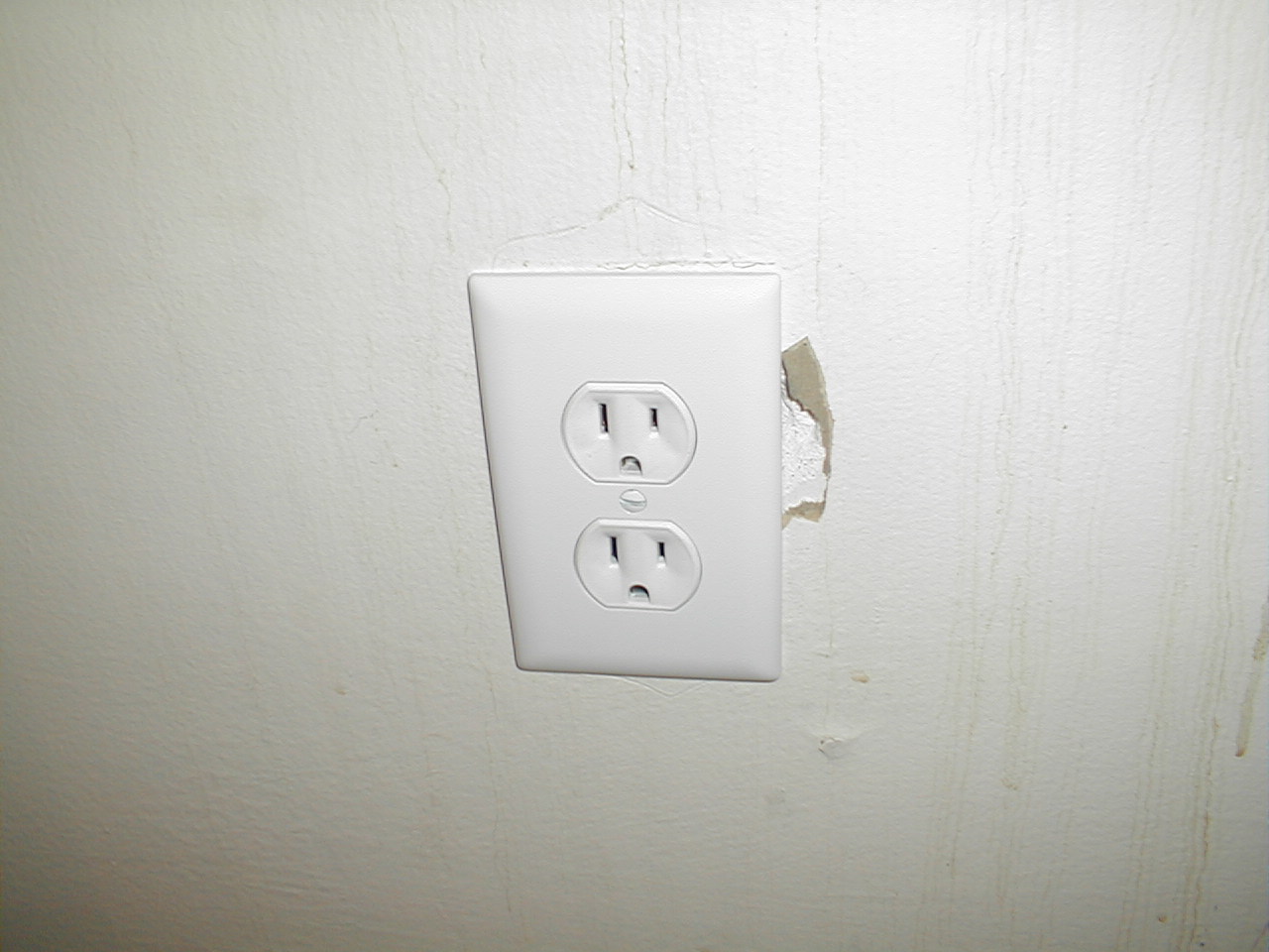

I am now done pulling wire. I finished at 5:00 today.
It has been a long drawn out portion of the project, but I believe it was worth doing myself. I may have only saved a few dollars, but it's done the way I wanted it done. Money can't buy the kind of job that I fell like I did.
I now will learn the delicate art of patching drywall... See attached Photos. These are a few examples of the damage I've done throughout the process.

That's damage?!
Hardly!
Second photo looks more like the wall needs to be cleaned and then painted.
