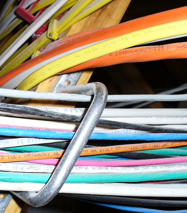

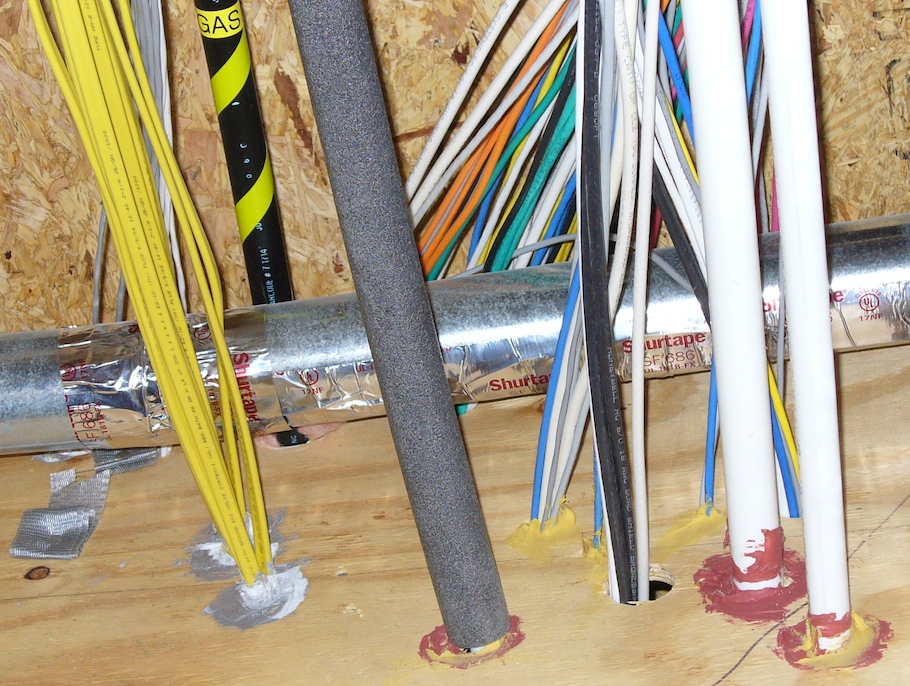

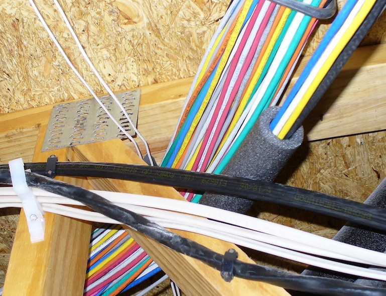

Here are some pictures. My helpers when I wired my place got the low voltage on both sides of the AC in a spot. So I took a piece of pipe insulation and went from 1/4" apart to about .75" apart or 1/10th the coupling. And that is over a small area.
You can put the pipe insulation on either wire (AC or LV- you can see examples of both in the pictures), but if it's more that a short piece of insulation I'd go for the Low Voltage and not the AC wiring.
Finally, you can see where I came through a smoke block and had separate holes for LV. Note also that I kept some of my coax away from everything (by about 4 inches). In fact, I tended to group my wiring into these groups:
CAT5, speaker wires, wires that ran relays, coax, and AC. All those types had some separation between them. If you look in the upper left of the picture, you'll se a bunch of gray wires. These go to coils of relays for turning on lights. I also had a run of two coaxes from the attic to the basement. These went to my off-air antennas. I had those 1' away from everything up until the last 12' before they came into the room with all the connections. I also ran an 18 gauge wire for powering amplifiers for these antennas so the signal levels would be stronger both for interference and signal loss reasons.

You can also use the wire staples to pull the AC away, or put in a wire staple and use a tie wrap to pull the LV away.
I also like those holders that hold up to 4 AC wires. They can help hold things out and away. You can see a white on in one of the pictures where I put the hose insulation on the LV wires to get a little distance to the big black kitchen range power wire.
