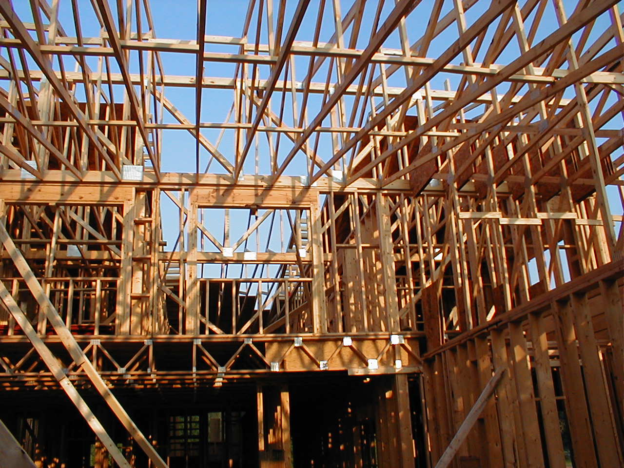

At least here a "smoke block" is when you take the floor truss and nail at least 1/2" plywood on to it. These are the gusset plate engineered trusses. For every 1000 square feet of floor space, the "smoke block" is needed.
The name is odd, since smoke doesn't cause problems. The theory is that fire will be stopped instead of spreading all out under your floor.
The plywood makes the truss "solid" and so it does not bounce as much. The engineered trusses tend to bend and stay bent with time. We has some drywall stored on the 2nd floor, and the 24' span 2' deep trusses sunk by about 3/16" and when the drywall was installed (they did the 2nd floor 1st so I could see what was going on) the truss ended up staying with about 1/4" of deformation at the middle. The truss with the plywood did not measurably sag.
Cross blocking (as I understand it) keeps the trusses from "kicking out" to the side. It's used for traditional (i.e. 2x10 or 2x12) floor joists. For engineered trusses, they run a 2x4 down the bottom of the truss at certain intervals to keep the bottoms from kicking to the side. The plywood on the top of the truss keeps that from kicking out.
So the challenge is to look at the design of the house and figure out what the loads on the floor will be. Then you can guesstimate if you want to do a little bit of extra "smoke blocking" on the truss to pick up the rigidity. This might be where you will walk, might be where there are cabinets or furniture.
If you look at this picture, you can see the 2nd floor truss with some plywood on it (center, 1/4 way up from the bottom). This was the beginning of adding some strength to this truss. You can see the wall that was on this truss. In this shot, I'm in the living room which has a vaulted ceiling which is why can can see the floor truss and why the wall was on it. Adding the plywood was my idea, the design of the house did not include that.
Pete
