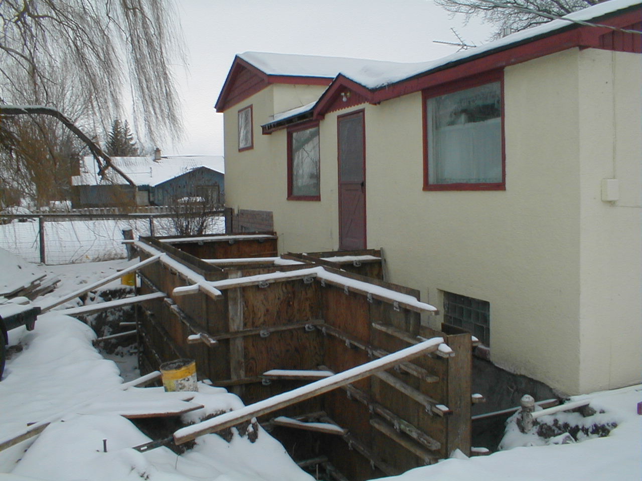

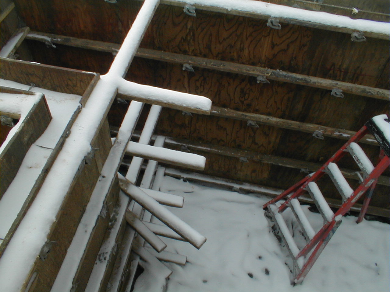

I'm trying to figure out how you maintain frost protection for the now-exposed portions of the footings?
In the midwest, we have to keep the bottom of footings at least 36 inches below grade per code.
Obviously they're unprotected temporarily.
I think the big concern with the 36 inches below grade is to prevent the lifting that can occur from chronic freeze-thaw cycles.
At least that's what I hope. Projects like this are not uncommon around here this time of year. If the temperature drops much below 0 degrees F they'll cover and insulate, but warmer than that they just rely on a little extra calcium in the mix and other accelerators. I've never heard the concern about the footings freezing.
Here are a few pictures of what it looks like today. We got some snow overnight.

It should pay for itself and then some. We refinanced the house to do this project. Due in part to the current financing situation in the country, our house payment after the refinance will only go up $7/month over what we were paying, and the payoff date is within a few months of what we would have had before.
I'd have probably had to commit the Bride if I stirred up that much mud for me and the dog to track in the middle of winter. :eek:
In all reality, there's very little mud. It all freezes, so there's nothing to track in.
Even still, I have my speech already prepared about how this is her project for her hair salon. She's pretty good about that kind of stuff, though. She understands that the comfort and peace of living in the country comes with a little mud on the floor.

The porch will extend over the actual doorway for the walk-out basement but not the stairs. I don't know if I can explain it in words. I'll post pictures when it's done. We'll eventually cover the outside stairway, but we won't do that until later. We don't have any plans for a cover over the porch.
