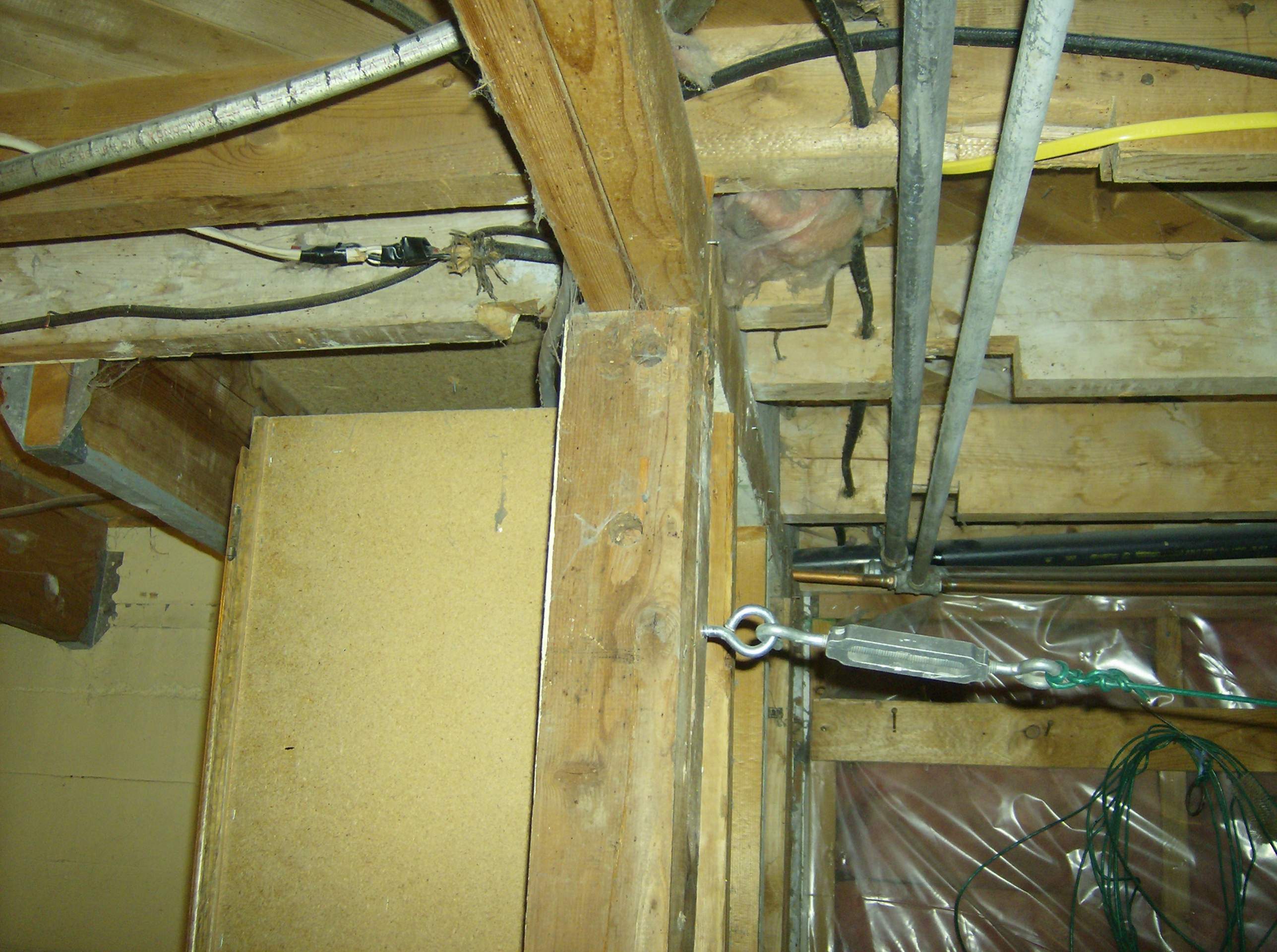

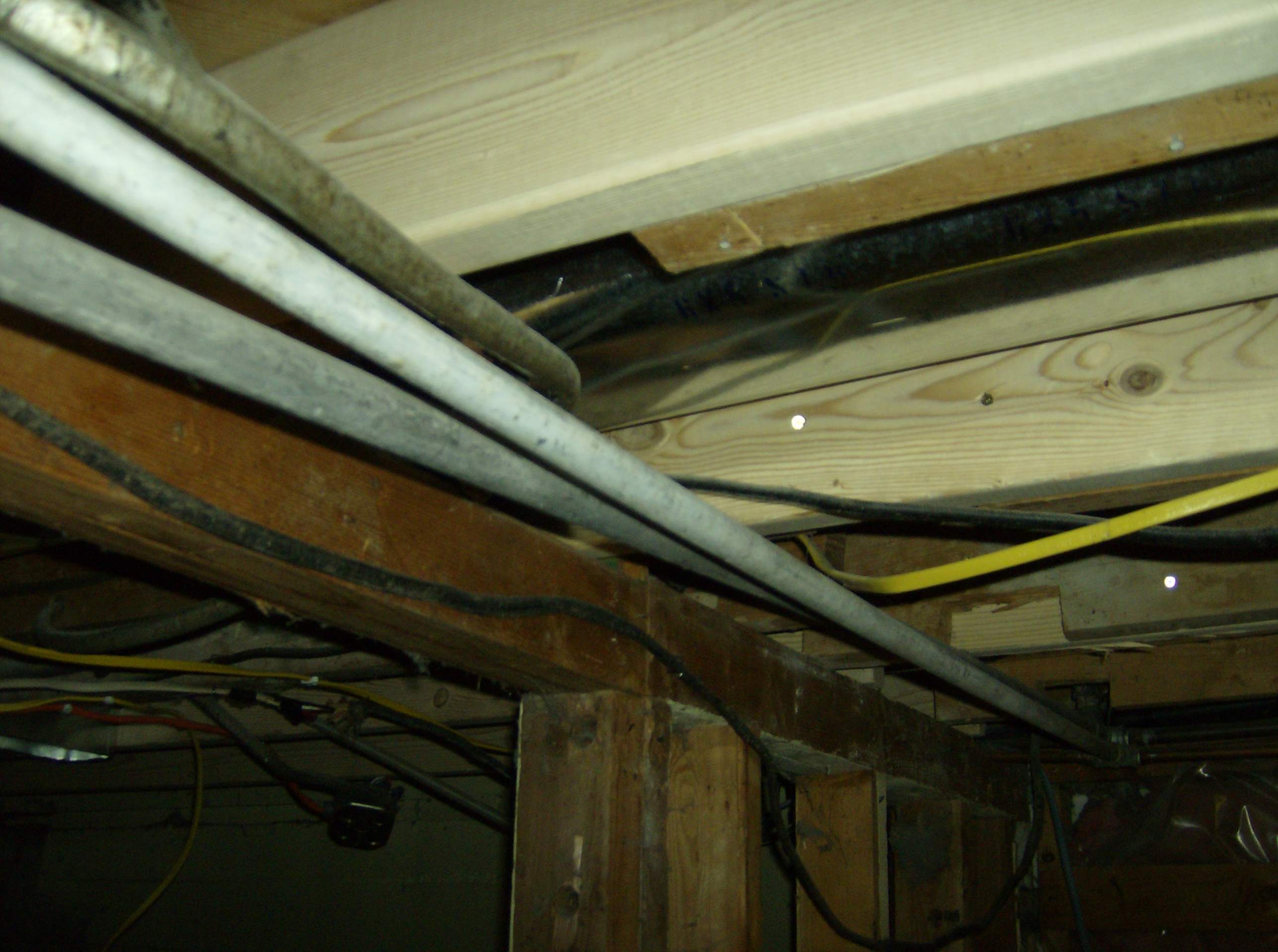

If anyone was wondering, adding a few joists is not as easy as it sounds. The only way I can figure to put them in is to put the joist in flat and then rotate it into position. This creates a problem because when the new joist is still at an angle it's taller than the space it has to fit into. I've put in three now, and every one was a fight.
I did learn it goes in easier if I put the top in place and pound the bottom to straighten it. This way there are only a few inches of friction on either side vs. the entire top length of the board if I try it the other way. Another trick I learned about midnight last night is that if I smear a bit of construction adhesive on the part of the board that has to slide accross the sill plate it acts like a lubricant. It makes it slightly easier to beat into position.
I plan to finish the joist project tonight so that the plumber and HVAC guy can come finish their part tomorrow. I think I'm going to try something new tonight. I'm going to cut a piece of angle to screw to the bottom of the new joist. The point here is to create a wear plate that I can hammer on without bludgeoning the board to splinters.

As far as smashing the edge of each 2x6 new joist, are you using a hammer or a sledge? If you use a scrap piece at the edge of the joist and hit it it will take the wear and tear instead of your joists. If you don't have someone to hold the 2x6 joist in position, at the middle as you hit/force it into place, you could screw a scrap piece of 2x6 into the end where you need to pound it to give you an extra 'hand', then unscrew the scrap after. Or you could jack up ever so lightly on the area from underneath to allow the new joist to fit better during installation and then release pressure/lift once the joist is securely in place.

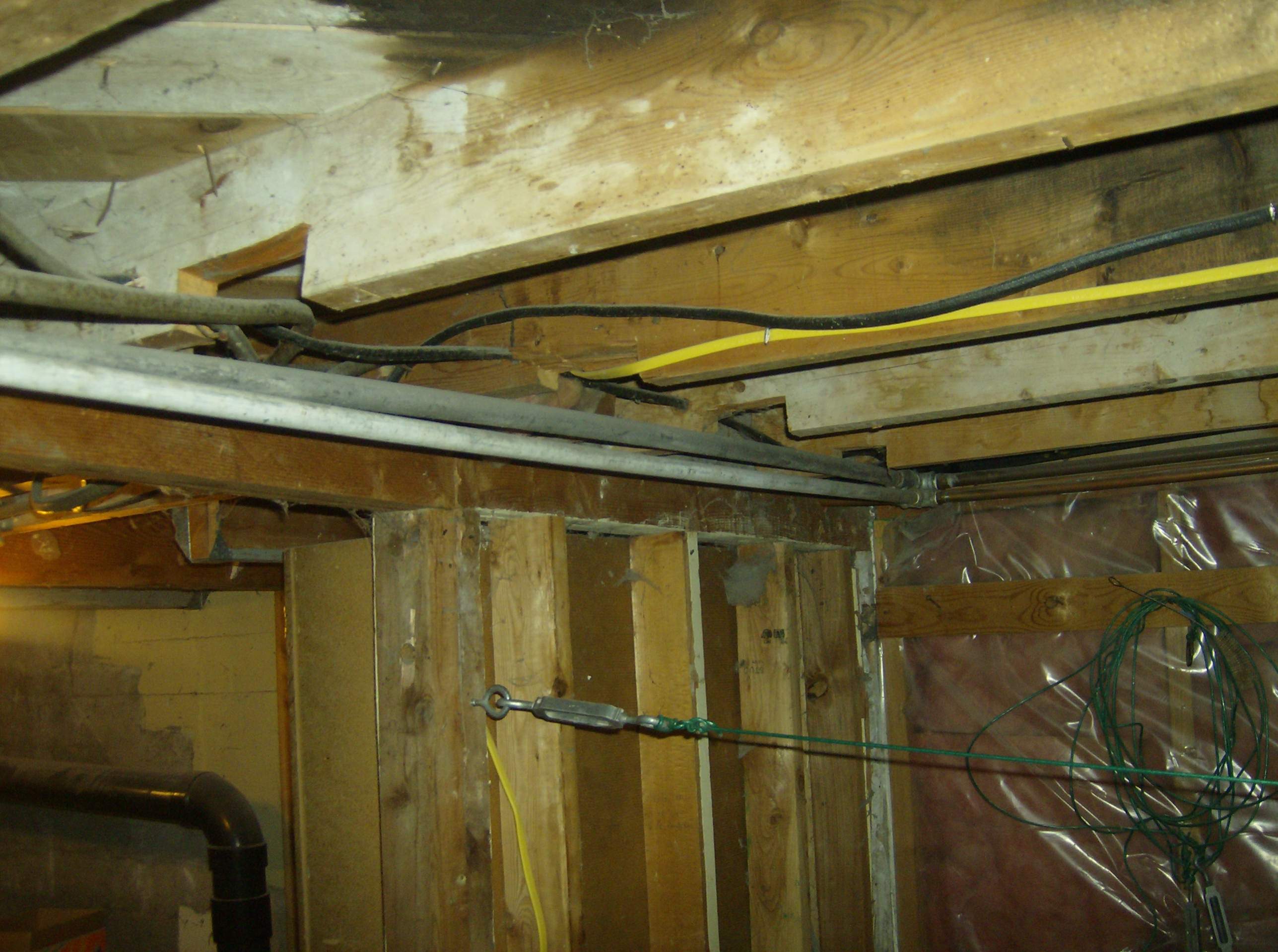

Here are pictures of the before and after of the joists. The first two pics are before shots, and the second two were taken tonight. It may not be perfect, but it's a whole lot better than it was. It will hold the house up. I have one more joist to do, but I have to wait for the plumber to remove all of the old line.

Nice job sistering up the joists. I didn't think to mention before, but if you have a 5ton bottle jack, you can put it under the existing joist with a 4x4 to raise the joist slightly to help allow room for the new one to go in.

I ended up using a 2 ton floor jack with a 2X4. It helped a lot. The additional benefit to this whole exercise is that I have eliminated all of the squeaks in the floor of the kitchen that is directly above this area. Now I'm thinking about jacking up some more of the floor and running construction adhesive between the joist and the subfloor.
