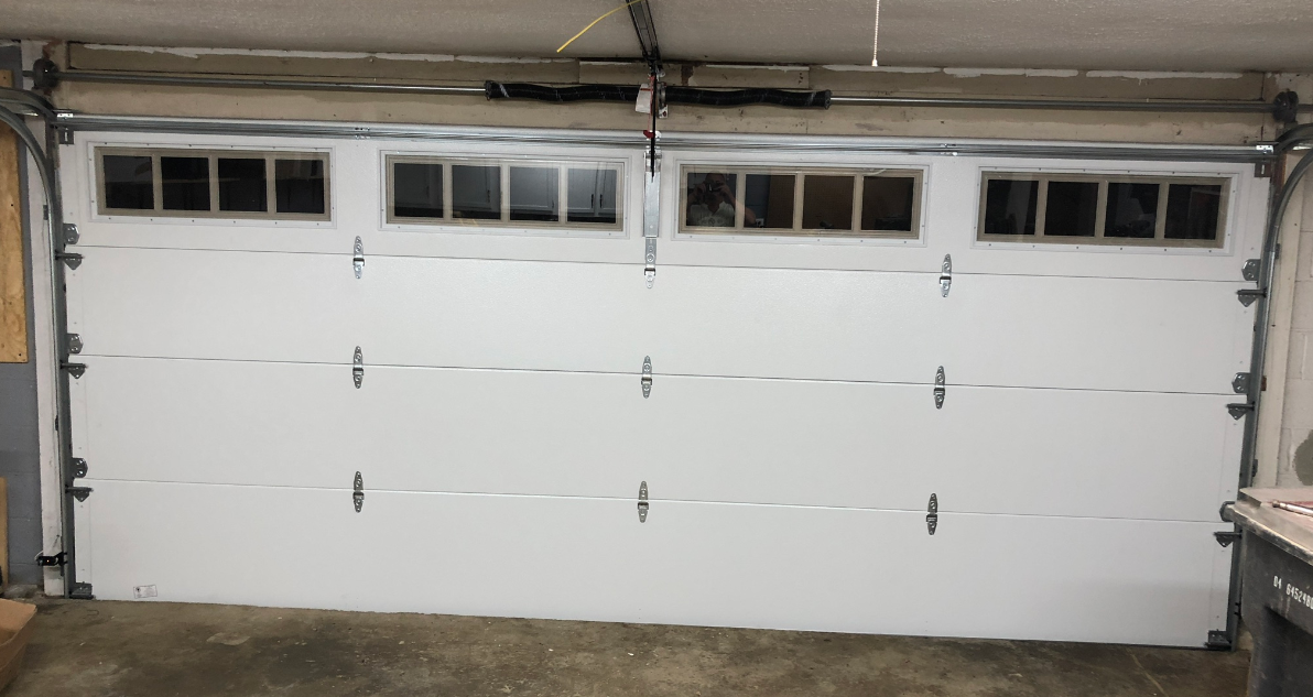

I figured it out and boy do I feel stupid. After reading these post, I went to check the extra hardware. I know I am going to have some since I got the low headroom kit which came with more hardware. There were 6 brackets that link each panel together. See the pictures. The directions never even mentioned these brackets. My wife read the directions as I was putting the door up and I even looked after the fact.
I appreciated every ones help with this. Every time I have an issue that I can't seem to solve, I post it on this forum and you people always get me pointed in the right direction. Thanks!!!

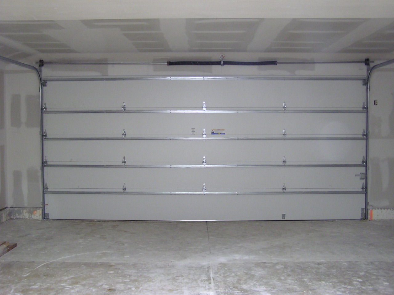

Our 16' insulated door had a stiffener on every panel:

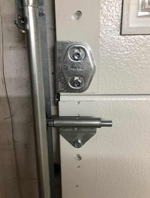

End of door hinges will have numbers stamped on them. 1 is the top of bottom section . 2 is the top of 2nd section. 3 is top of 3 rd section. All hinges in the field of the door are Number 1. Make sure your struts are on the right panels. You can not add struts with out changing the springs which are matched to the door by 10lb increments. Most doors do not have the extra parts to aid in your confusion. Nice door but you are lucky to not have bent panels.

I’m not the only one who would be up **it creek without my wife. Glad it’s an easy fix. Btw all of the standard sized 16’ insulated doors I’ve had don’t have extra ribs in the middle. Yours may need them at some point- but I haven’t seen them.
   / Just replaced a garage door and have some odd issue's. #19
One rib/stiffener for EACH panel in Florida.
