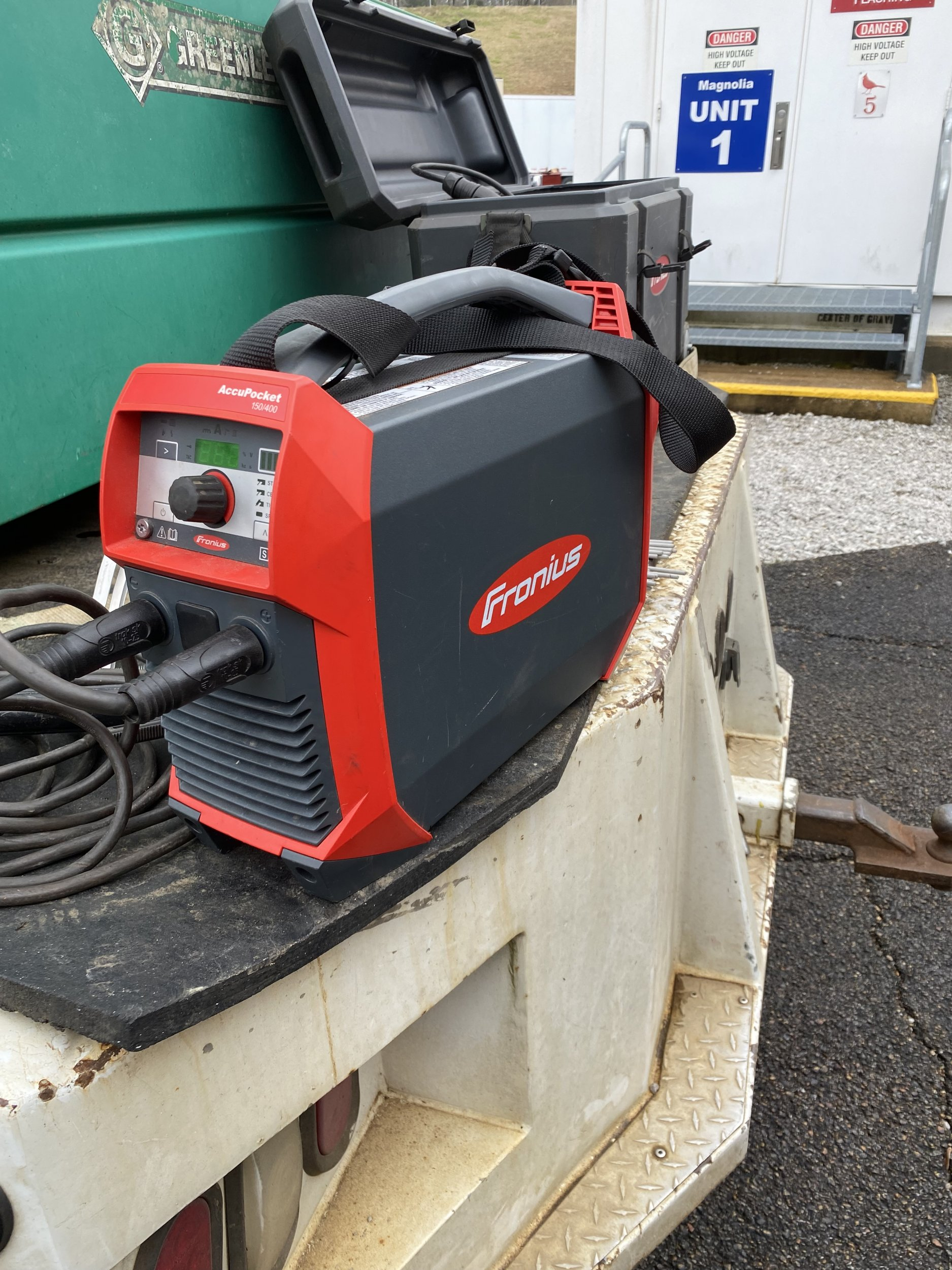

Compared to the size of the ground clamp, the welder looks tiny. Maybe the size of a car battery but taller.
Yes. Full sized high quality clamp and a lunchbox sized welder.
Here is a pic of 7018 at 165 amps. 1/4" wall pipe to 1 3/16" plate

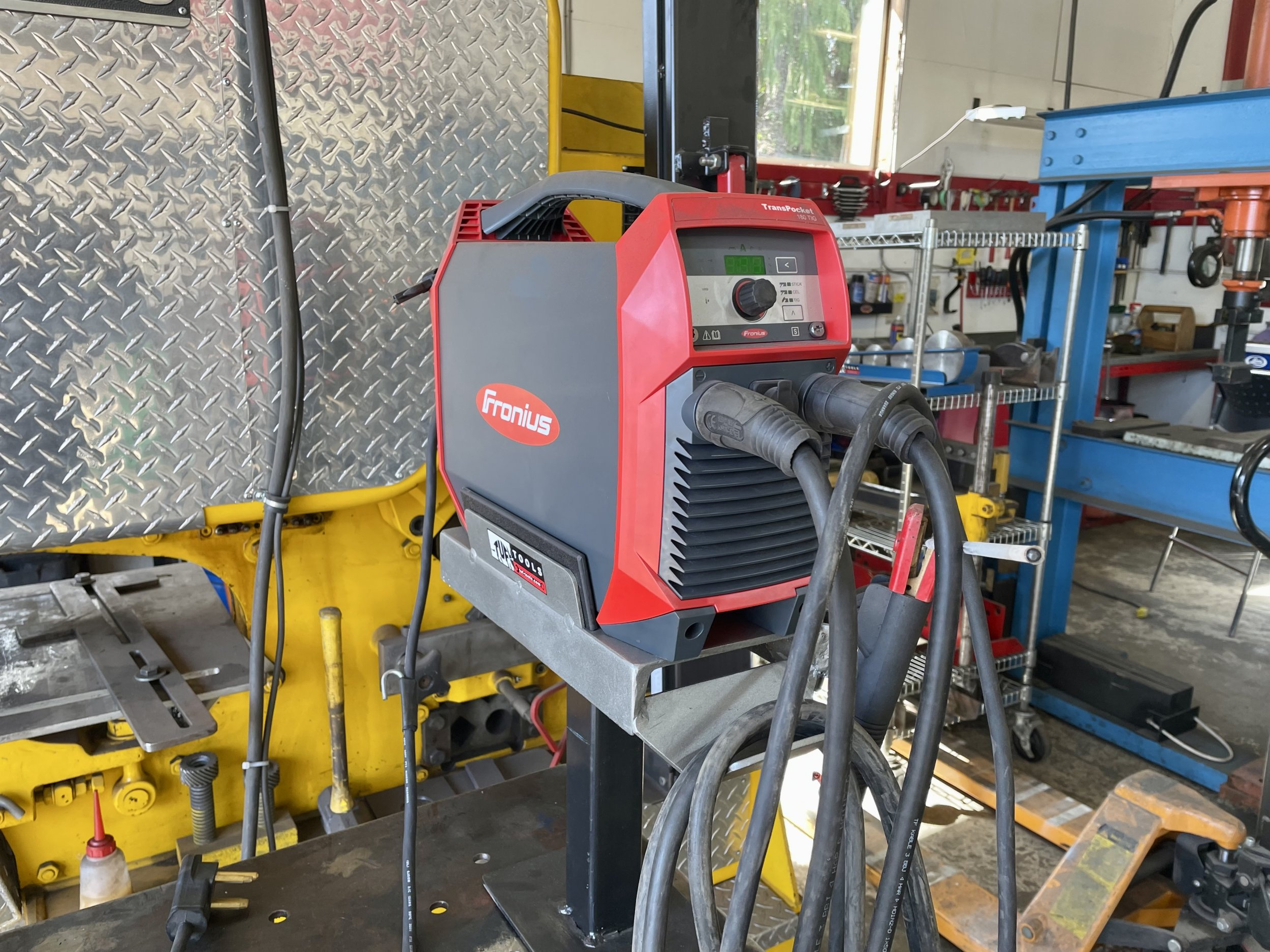

We have shifted to Fronius from Lincoln and ESAB at work. High volume manufacturing. I have personally integrated 12, 500 amp Fronius power supplies into equipment. 8 are burning 0.52" and 4 burning 0.45" wire. Controlling them over Ethernet via a PLC. 500 amp multi-process power supplies, think they weighed 78 lbs. Inverter.
