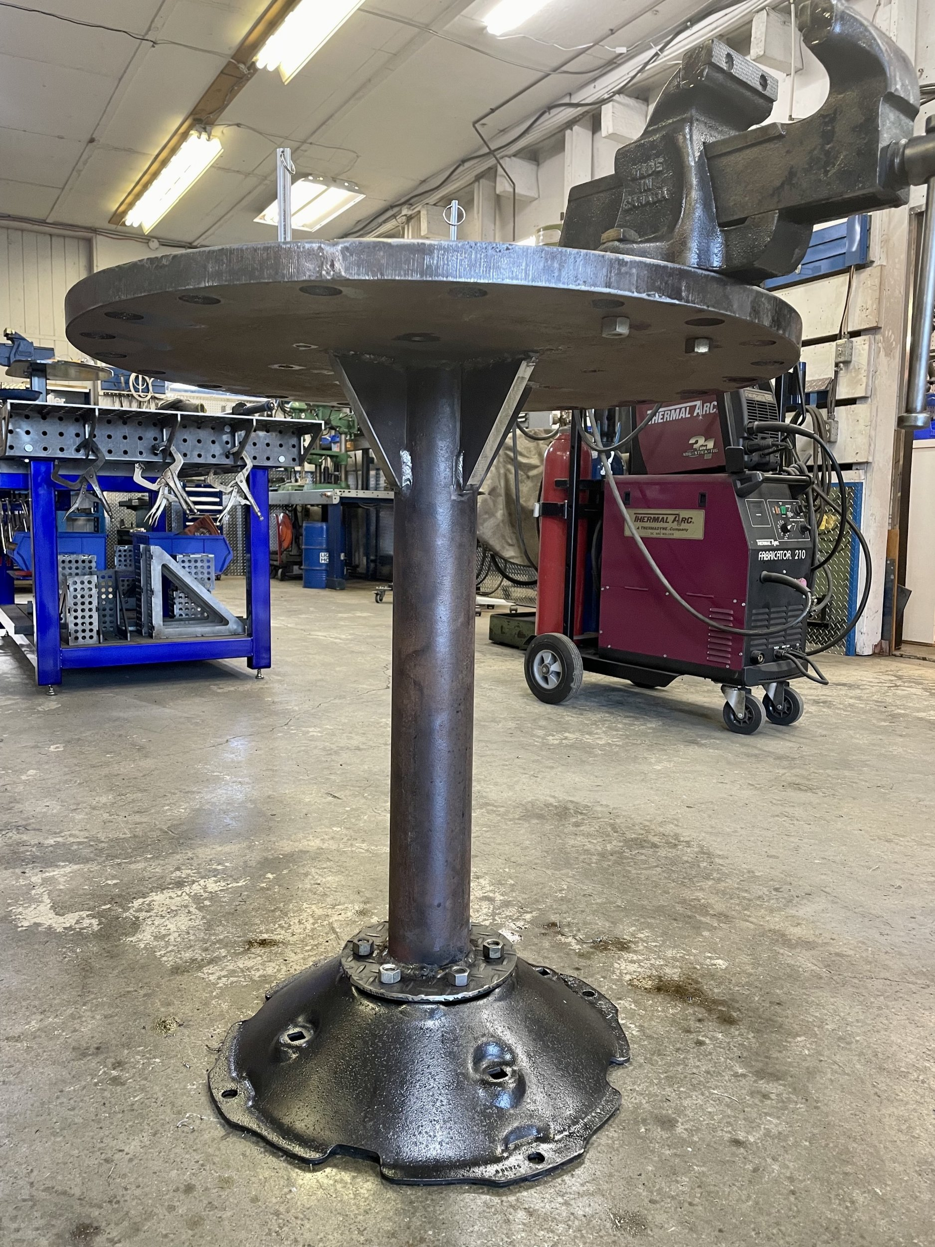

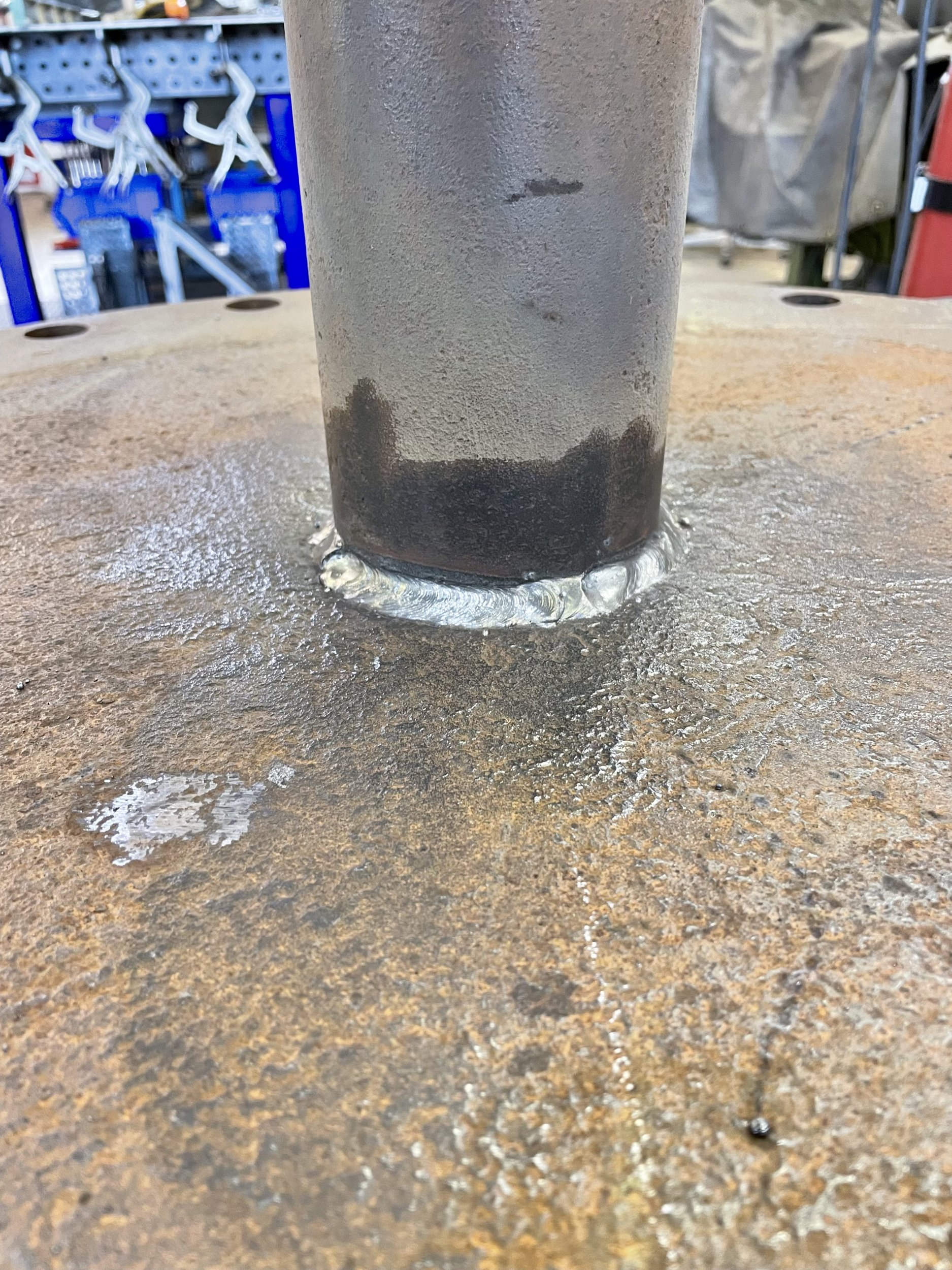

Here is a pic of 7018 at 165 amps. 1/4" wall pipe to 1 3/16" plate
   / Just Used One of These Welders #32
3/4" gussets
