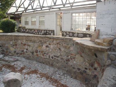

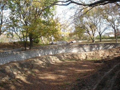

One of the things that's had me anxious was how the east side planter would look with coping.

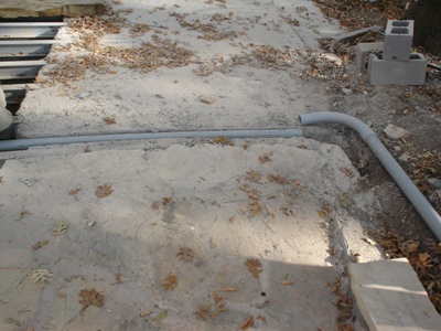

I didn't lay in the conduit for the submersible pump that's going to provide the water from the pond to the fountain system.
So we cut a three by four trench in the concrete so we could put in a two and a half inch PVC pipe.

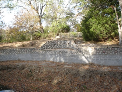

The client and the guys have complained about the existing cinderblock shelving along the front of the greenhouse.
Today the guys took care of it.

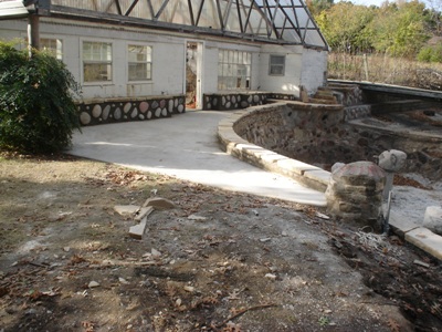

We talked about it this morning. Then while I was getting the excavator they had it started and so most of the day was spent in that area.
They did good.

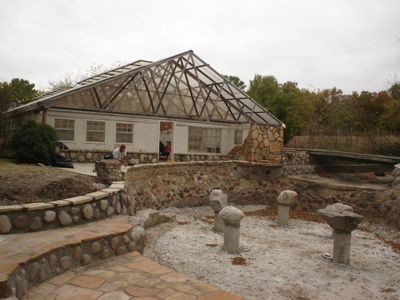

Here's what they've done to the greenhouse. I guess they just didn't think good enough was good enough.

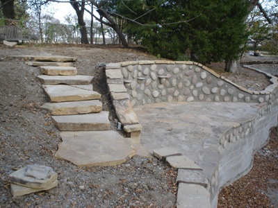

We used large slabs for stairs down to the grotto from the path above.
