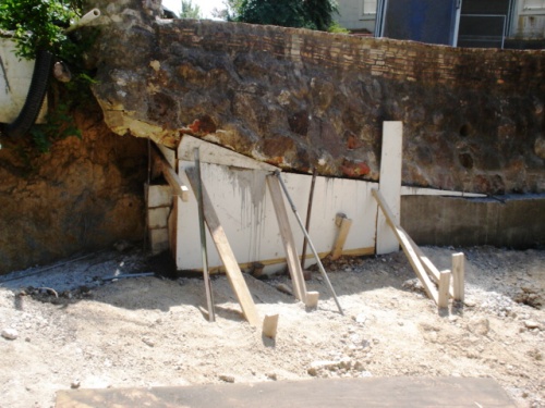

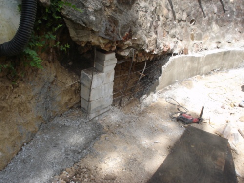

One of our big problems was the original wall tapered up opposite of the spillway. I wanted to bring that wall down to the new floor level of the remodeled pond.
That involved rebar.

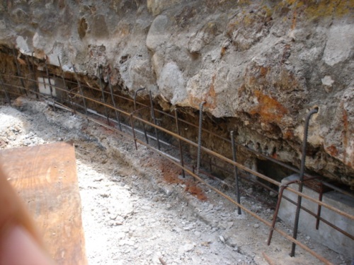

#52
And then there was some forms for the concrete.....

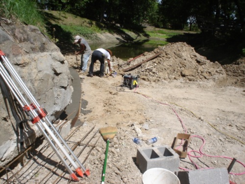

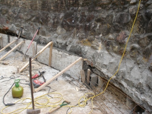

#53
Then concrete.....

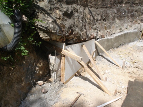

#54
This was the end of a very long day.

This is what it looked like this morning after we'd pulled the forms.

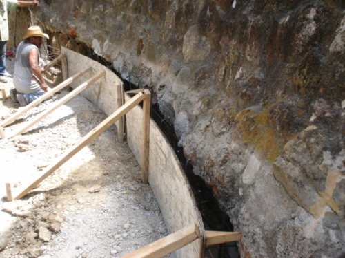

#56
Then it was forming up the next section.
The idea is to get a good concrete beam under the wall between the haunches and piers.

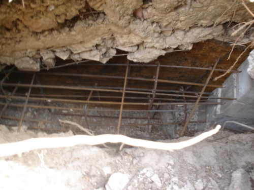

This is a view from on top of the wall looking down into the cavity after it was formed up.

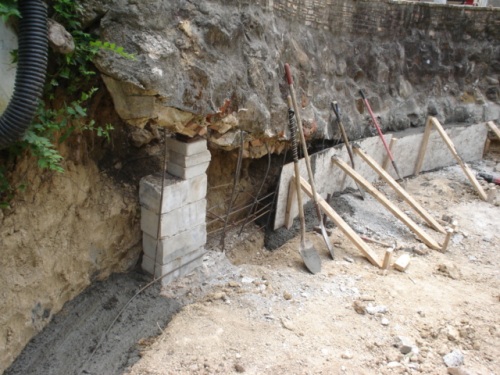

#58
Here's what it looked like from down below after we'd finished forming and pouring.

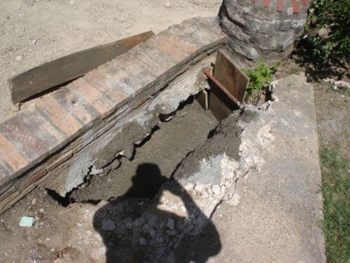

#59
And here's the view from above.
