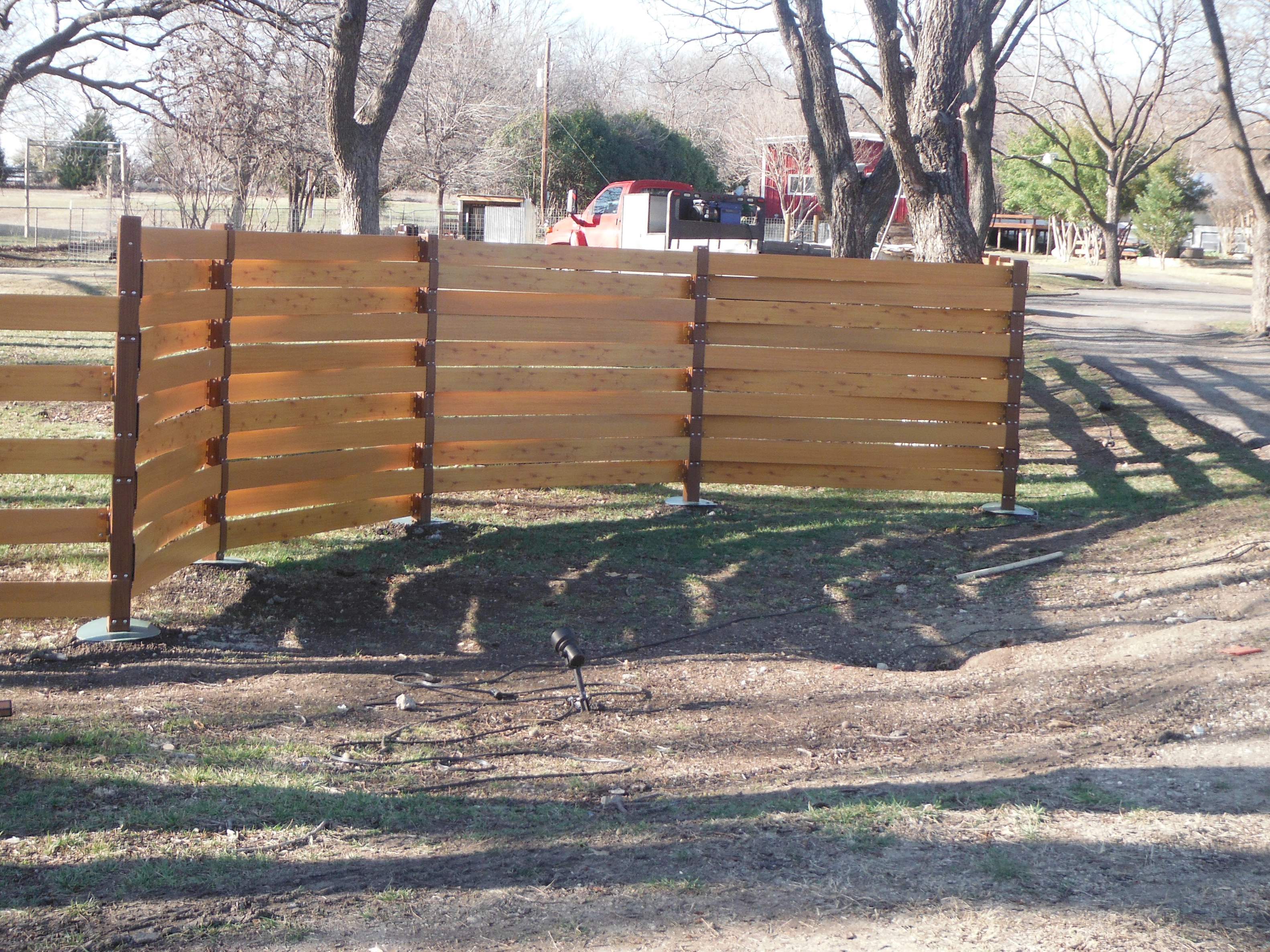

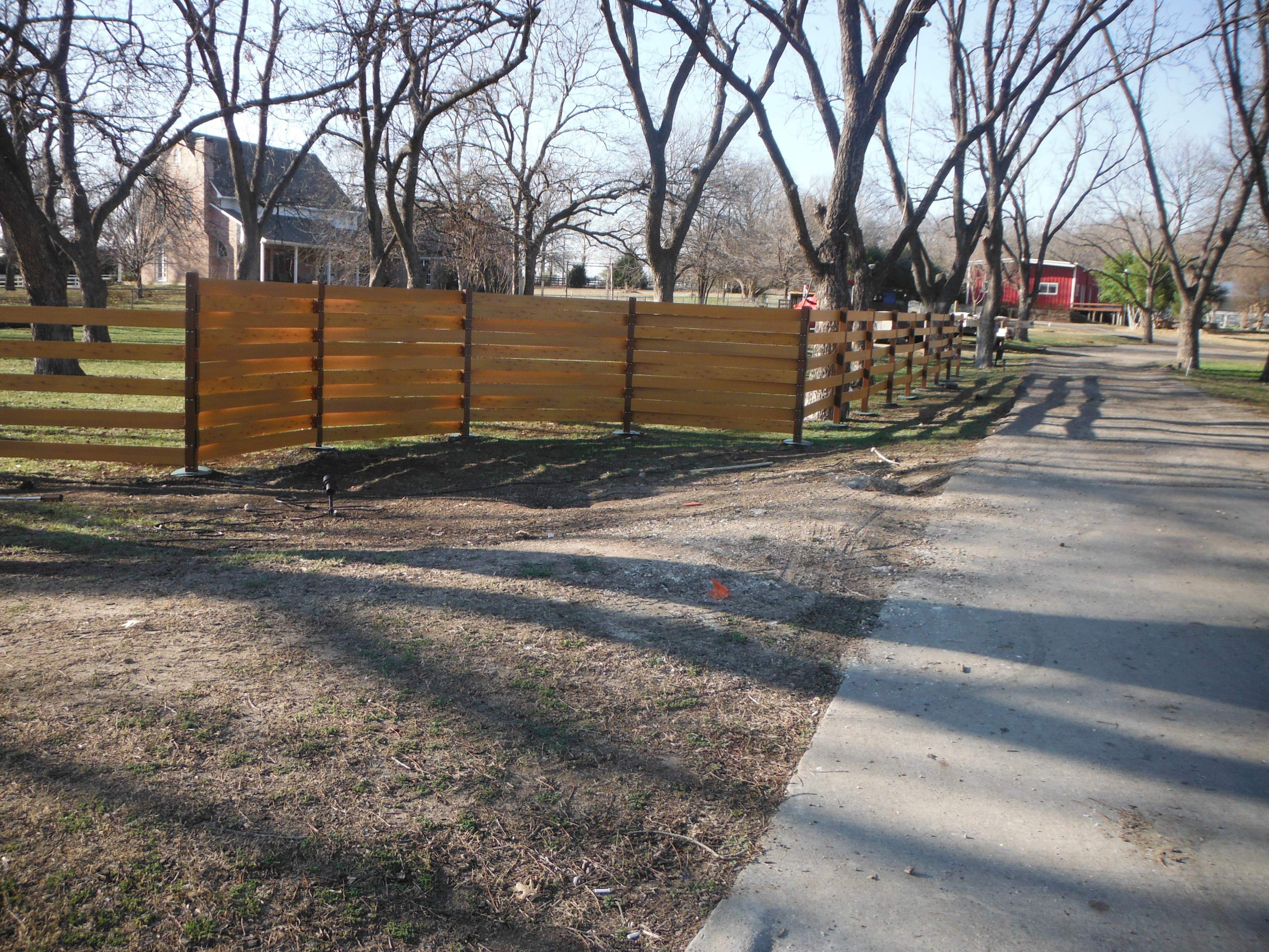

I wanted to accent the entryway leading to the gate. I did this by making the panels in the arc solid.
It is a total pain in the butt. Working by myself it takes a day to do one panel. Keep in mind every cut has to be done with masking tape on each side of the cut, plus masking tape on the foot of the saw. Then the cut has to have two coats of cold galvanizing plus a color coat applied. The tolerances are less than an eighth of an inch on some cuts. This is one job that couldn't be done without the new steel steel cutting blades in a worm drive saw. The beauty of these saw cuts is the accuracy, the finish, and the lack of heat transfer. I can keep the cut within a sixteenth in a five inch cut and great plus, no blistering of finish, pick up cut piece and it is cool to the touch.

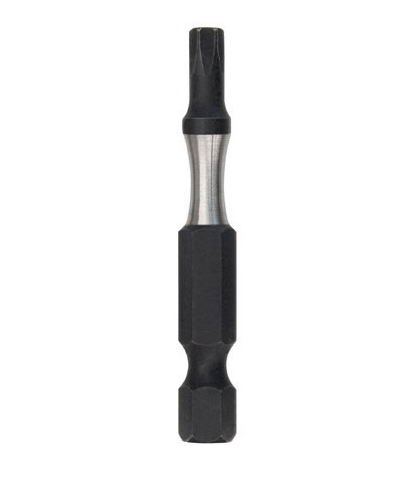

Even at 64 years old I'm still learning about this work stuff. I went with stainless fasteners, Torx head, because I wanted to avoid rust issues over the years. I knew that one of the downsides of stainless fasteners square head self tapping is rounding out the head of the fastener which means vice grips to remove plus the cost of the fastener, thirty plus cents per each at least.
The Torx head has its own problem, nut setters. The ears break off, sometimes after only a couple of fasteners installed. I've tried the new Milwaukee impact ones, $2.75 each at American Tool in Plano, TX, $3.79 each at HD if available. They don't last any longer than the one inch inserts I can get for $.75 each at American Tool. I thought it might be the DeWalt 20 volt impact, darn thing doesn't have a feather or impact feature. I went to my trusty 14 volt Panasonic with its three impact selection and had the same issues. I imagine I will have over a hundred dollars just in broken bits by the time I get through.
I've found that Bosch makes the best Torx bits that I've been able to find.

Harvey, are these the torx tips you are talking about? They sure sound high-tech in Milwaukee's online description. I guess the "shock absorption zone" is just something else they can charge you for when you buy them. Maybe you need to send them a few broken ones for Christmas and ask them what good their shock absorption zone is if the darn tips break? :confused2:

Jim and Eddie, I think it is the design of the head of the fastener. The ears/wings of the nut setter are just too thin to absorb much impact. That is the puppy with the bad name Jim. Torx 27. A know it all at HD told me no one sold them individually. He was wrong of course.
It is a pain in the butt. But I would rather have broken nut setters than stripped out fasteners.
