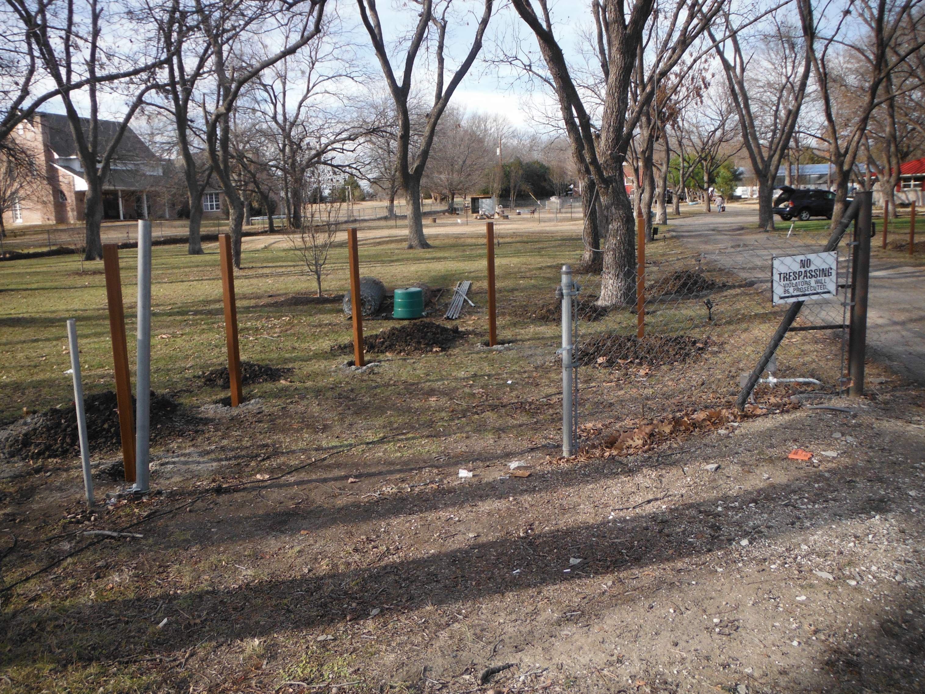

Harvey, is keeping the cement 4" from the top of the hole have something to do with a weed eating sleeve?
I've started keeping the concrete down because of the clay soils around here. I've found it doesn't seem to jump up as quickly if there is a layer of top soil around the top of the posts.
Scott is picking me up 100' of aluminum coil for making discs that will slip over the posts. Hopefully a 12" disc around the post will stop the grass from growing next to the post and maybe that will give the yard maintenance guys some inspiration not to weed eat the texture and color off of the post.
We got fifteen more posts set today so tomorrow morning I've got to pick up another pallet of posts for working this weekend. I won't be working tomorrow because I'm off to the VA hospital to get on record for the Agent Orange thing.

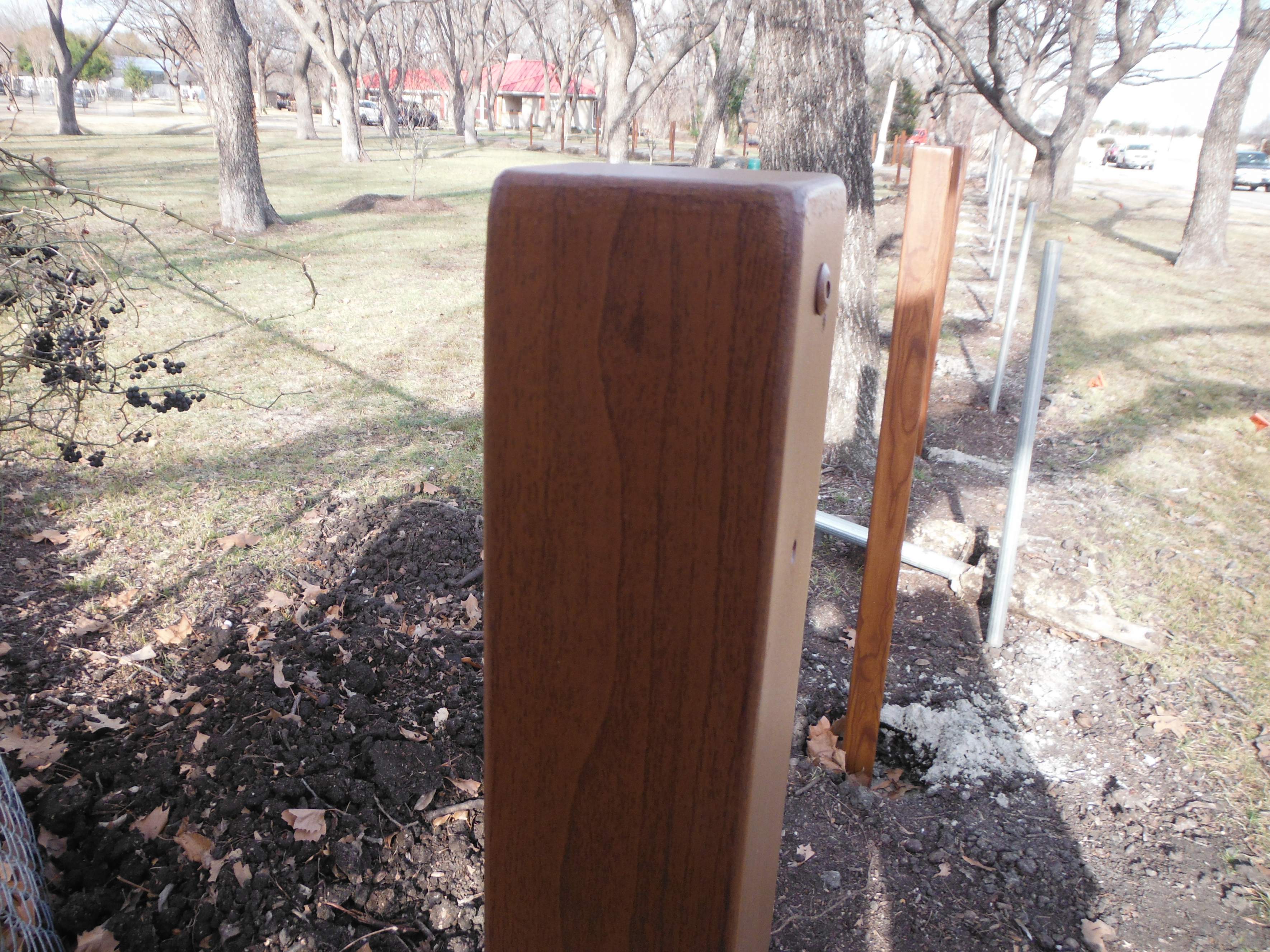

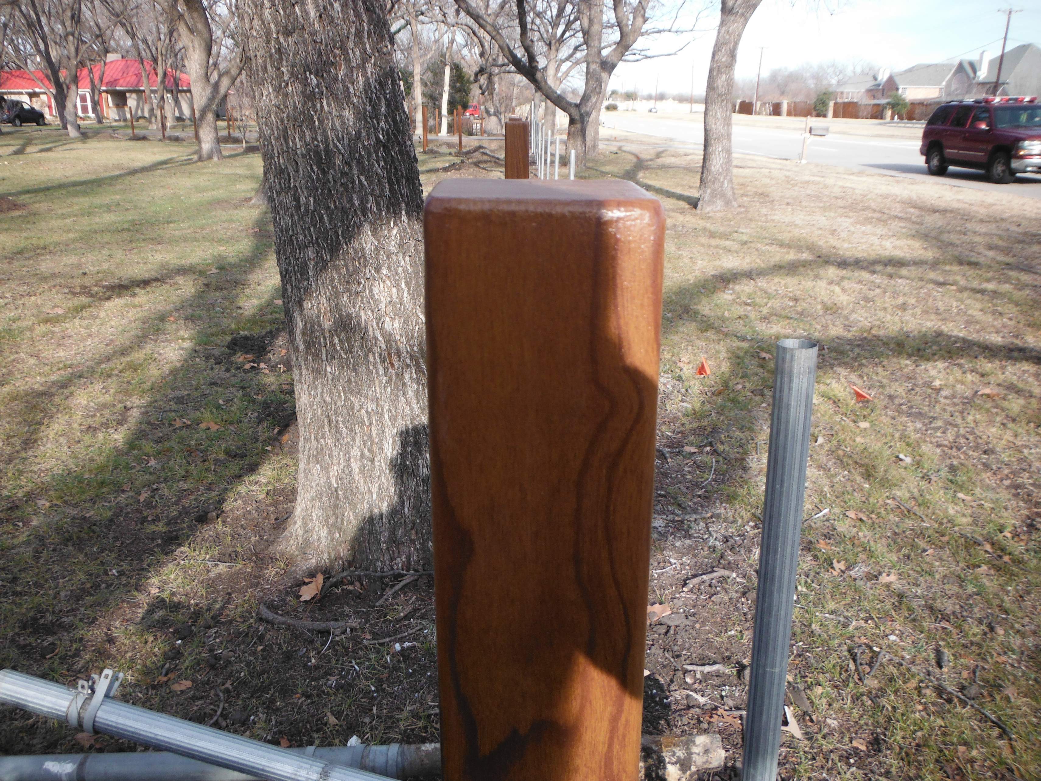

We picked two different dark wood patterns and mixed them up fifty fifty. One has a tighter grain.

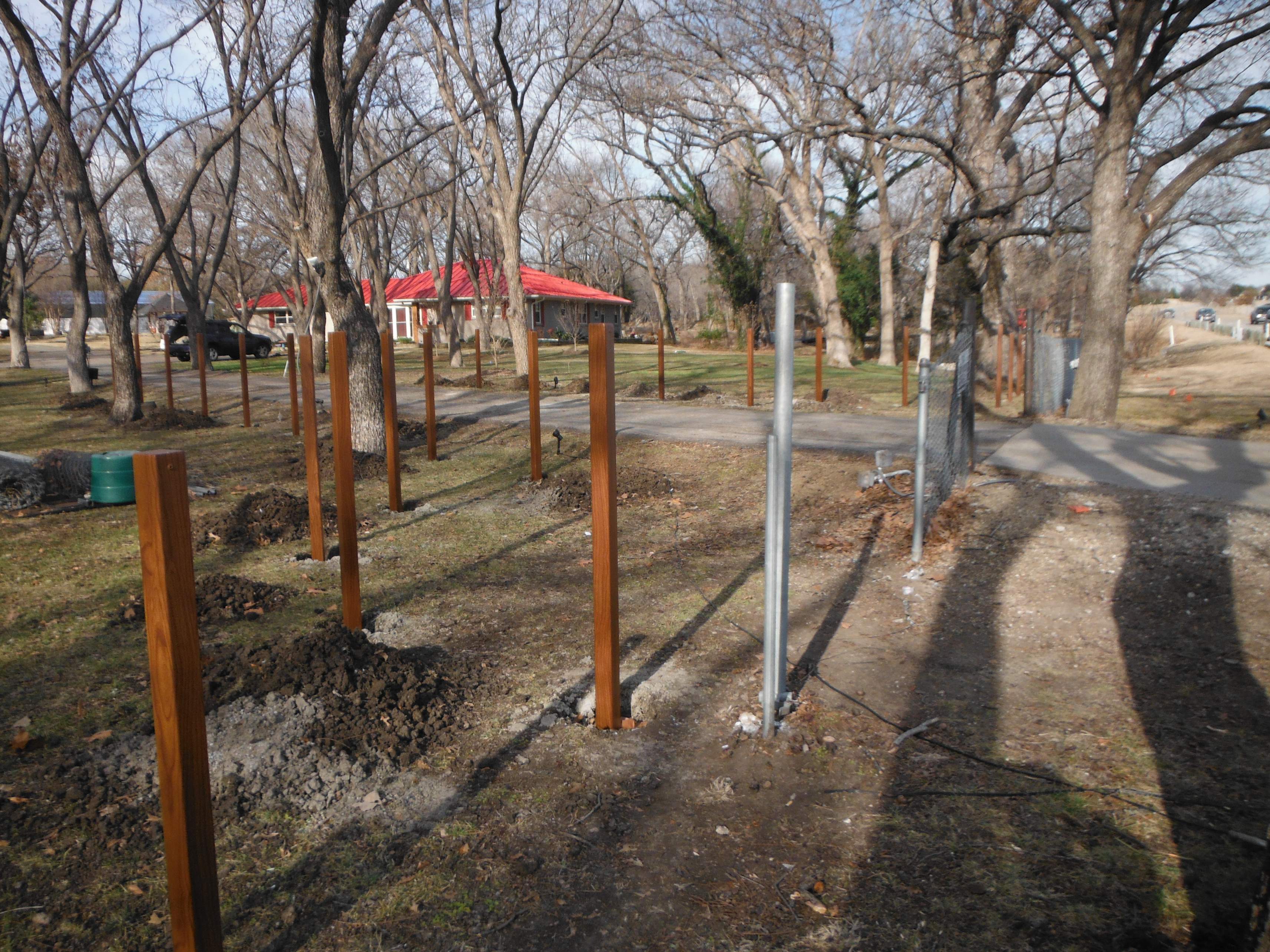

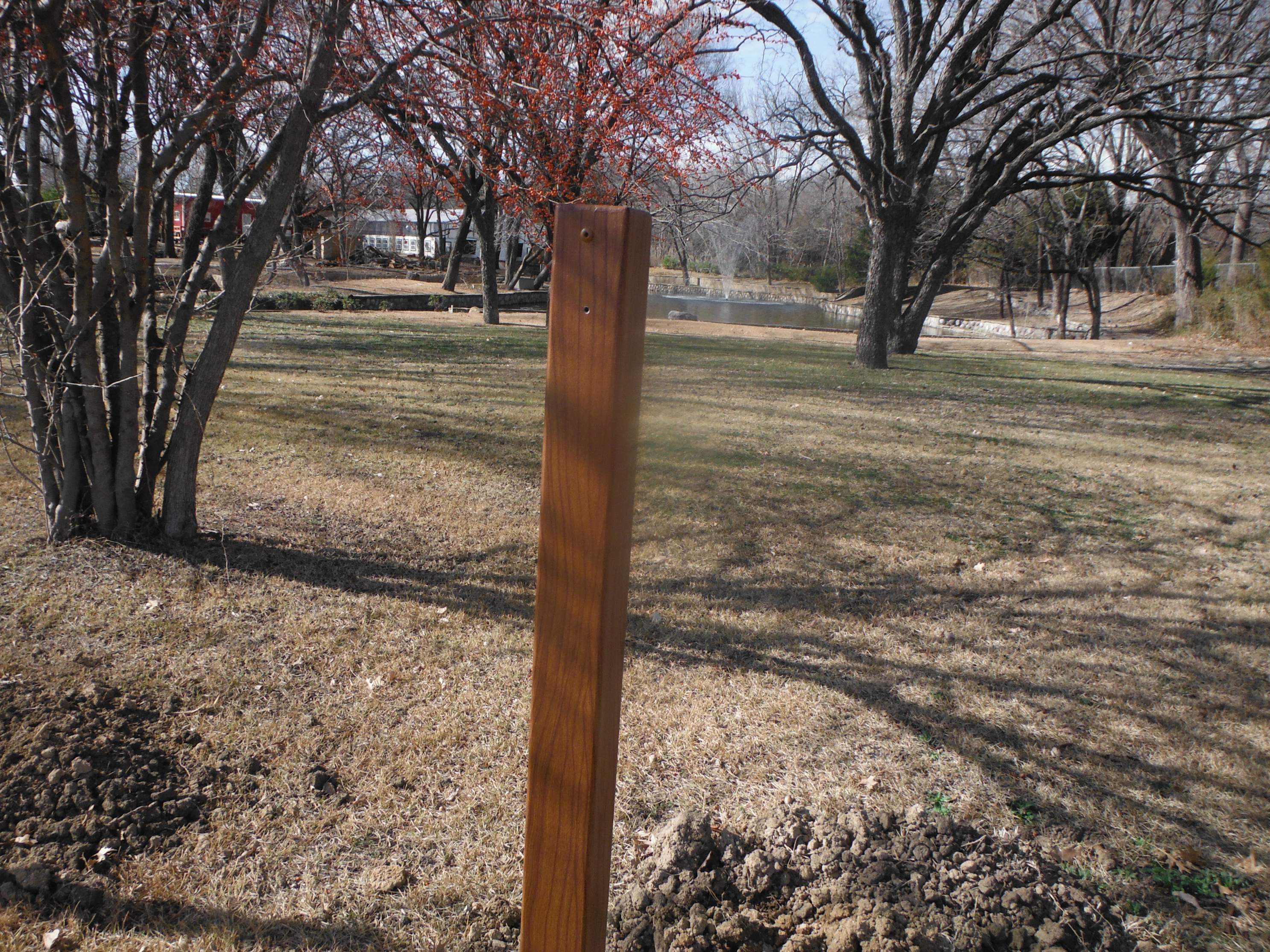

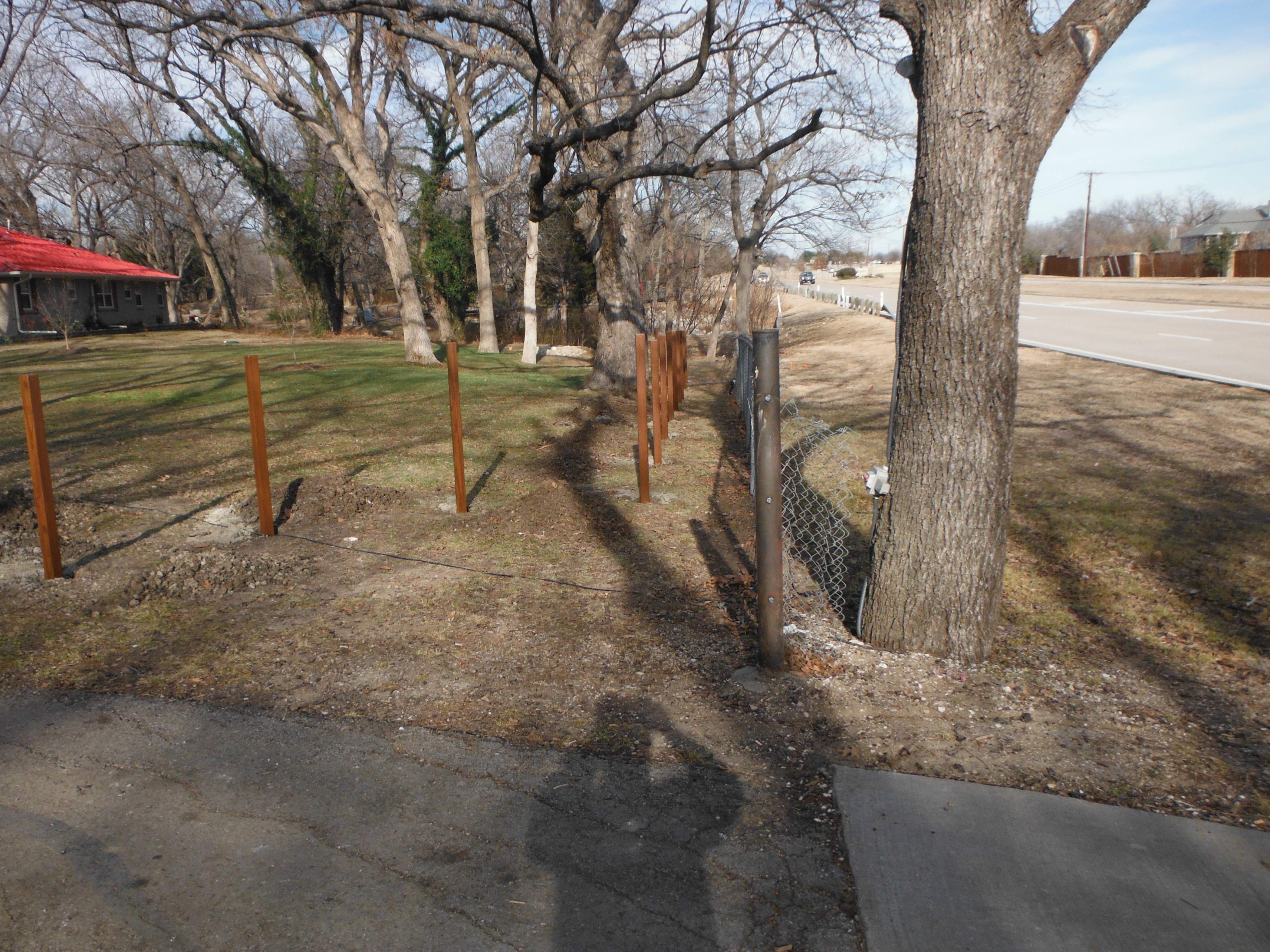

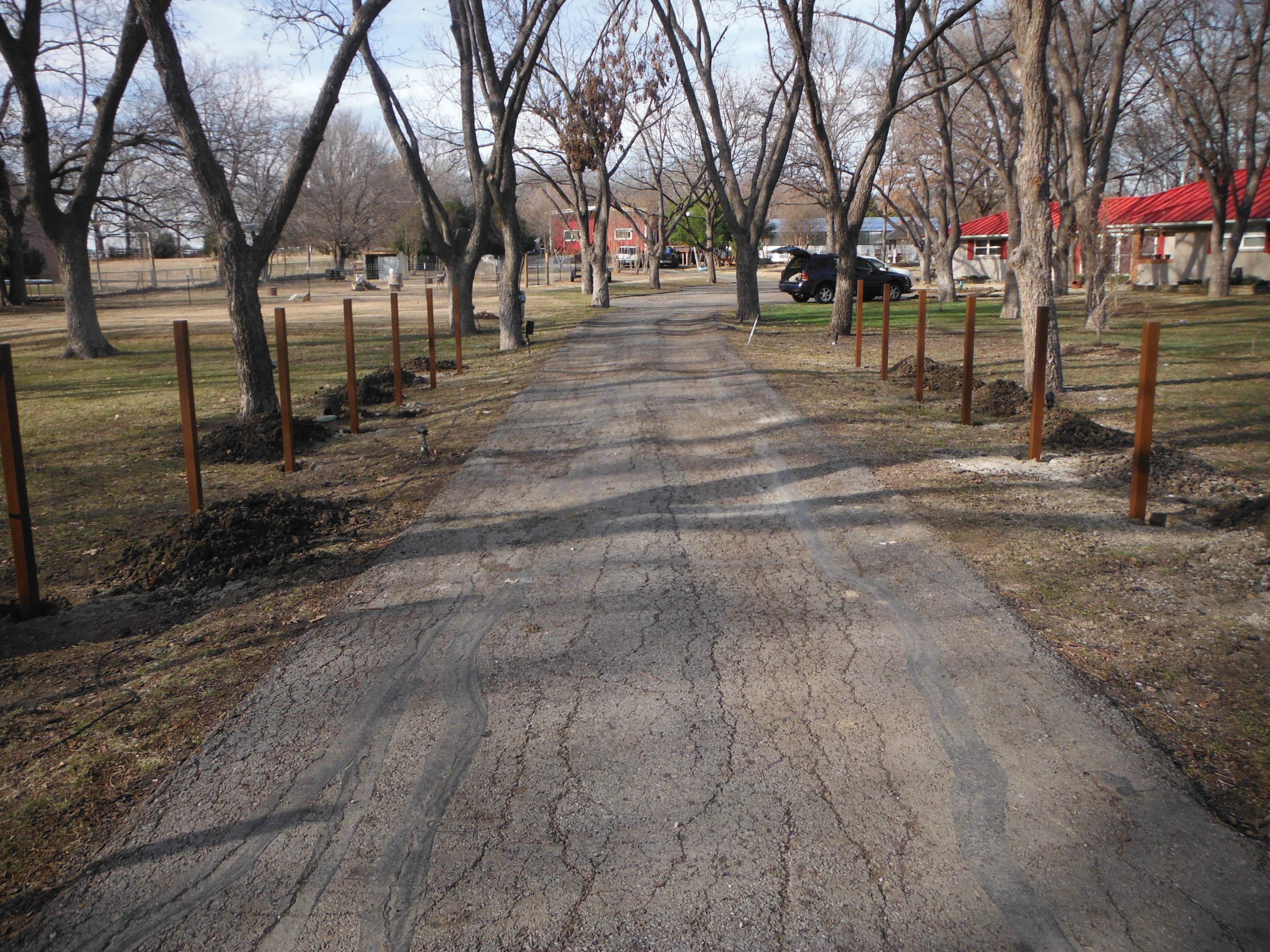

017 shows the driveway and where the gate will be located. The gate will be located about fifty feet inside the property and slide open to the left in the photo. The opening is just over twenty feet, driveway width, 22 feet actually. The gate hasn't been made yet but will be fourteen to sixteen wide and be motorized. The gate will be a woven basket, with handle even.
I wanted to do something at the entryway that directed your eyes down the drive to the gate. The other photos show the radius' for the plant areas. There is one on each side of the drive. The rest of the fence is ranch fence five rail basket weave pattern. Five inch rail, five inch space, five inch rail, five inch space, five inch rail, five inch space. five inch rail, five inch space, five inch rail, and then space to grade. But the two arcs at the entry way are higher than the front fence line and have a solid pattern, basket weave. I believe this will accent the plants and vice versa. I also believe it will frame the gate.
I was facing two options when it came to grade change, lots of it here on the property. All the rails could be level which would mean lots of stair stepping in ten inch increments, not enough grade change for that for the most part. Or I could run the lines straight and not level. I chose straight. The brackets I had made for attaching the rails to the posts are over sized enough for me to have an inch per foot of spacing drop or rise. I don't have that anywhere on the job.
I pointed out earlier that the keystone post was the one at the base of the tree, the first post set because its location dictated all the rest of the posts spacing. I'm going to have to make some more posts and we want to have some extras for the homeowner in case an auto accident takes out a post.
Friday one of my older friends saw the truck and stopped to see what I was doing. He grabbed a post to shake it and exclaimed, "my gawd, these posts solid teak?" Between the thickness of the steel and the depth and width of the concrete footers they do feel like they are a solid post.
The west side of the property's posts are set, 54 each. Monday we start setting the east side, 31 posts.
The powder coater has most of the rails powder coated and ready for the texture finish process. It's going to take awhile for them for this part of the job. Most of their work using this process involves stainless, aluminum, and occasionally thin steel materials. It takes less time in the oven to get the material to the right temperature and they can handle it sooner because it cools down faster when it comes out of the oven than our project. Ours is thick steel and it is big, five inches wide, three sixteenths inch thick, and twenty feet long. Our project is going to take them at least fifty percent more time to handle than their normal projects do.

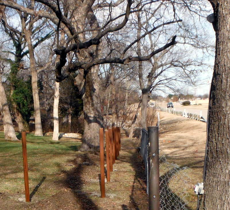

Harvey, those posts sure look nice. That fence is gonna be another stunning standout in your collection of unique jobs. One thing does concern me. I've seen those trees and most are pruned up or have few low-hanging limbs. The one in the photo below would have me concerned. One spring storm with wind and that limb could be down right on top of your client's new spiffy fence. I could sure be wrong, but if that were my fence, that limb would have to go. You can't make the fence 100% safe with all those trees, but that one limb seems to be courting disaster.
   / Keeping character, or restoring a pond #698
I'd bet that if anything tears up that fence, it'll be on 4 wheels with a drunkard or kid behind the wheel. But I agree about the limb trimming.

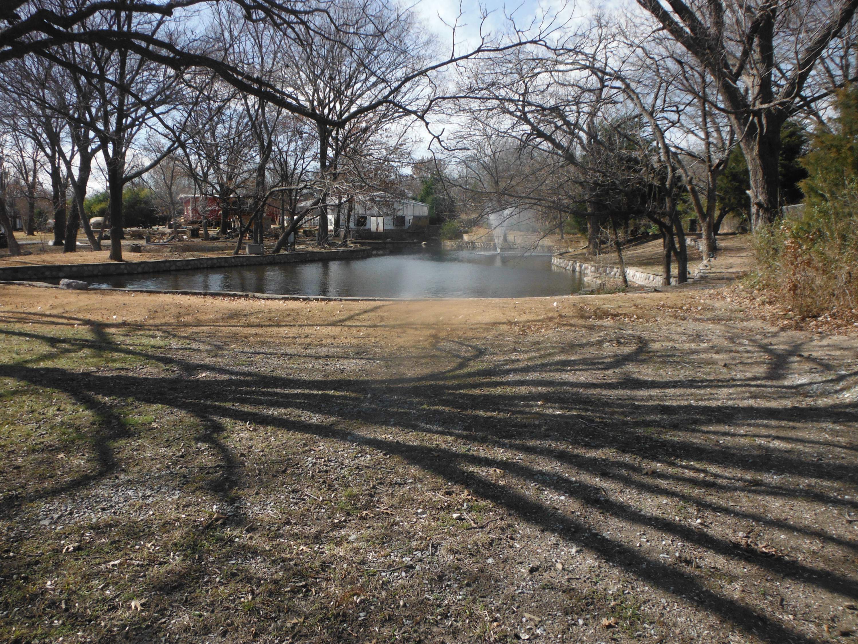

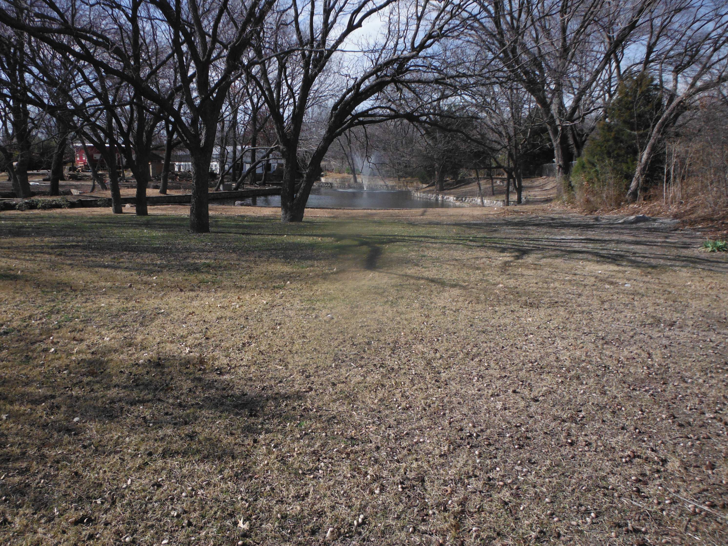

Jim, they are having their landscape architect arrange for the tree things. They are adding trees and going to maintain the existing. Kyle, the guy finally pulled the fencing. He got it for pulling and removing.
This is what the pond looked like Super Bowl Sunday.

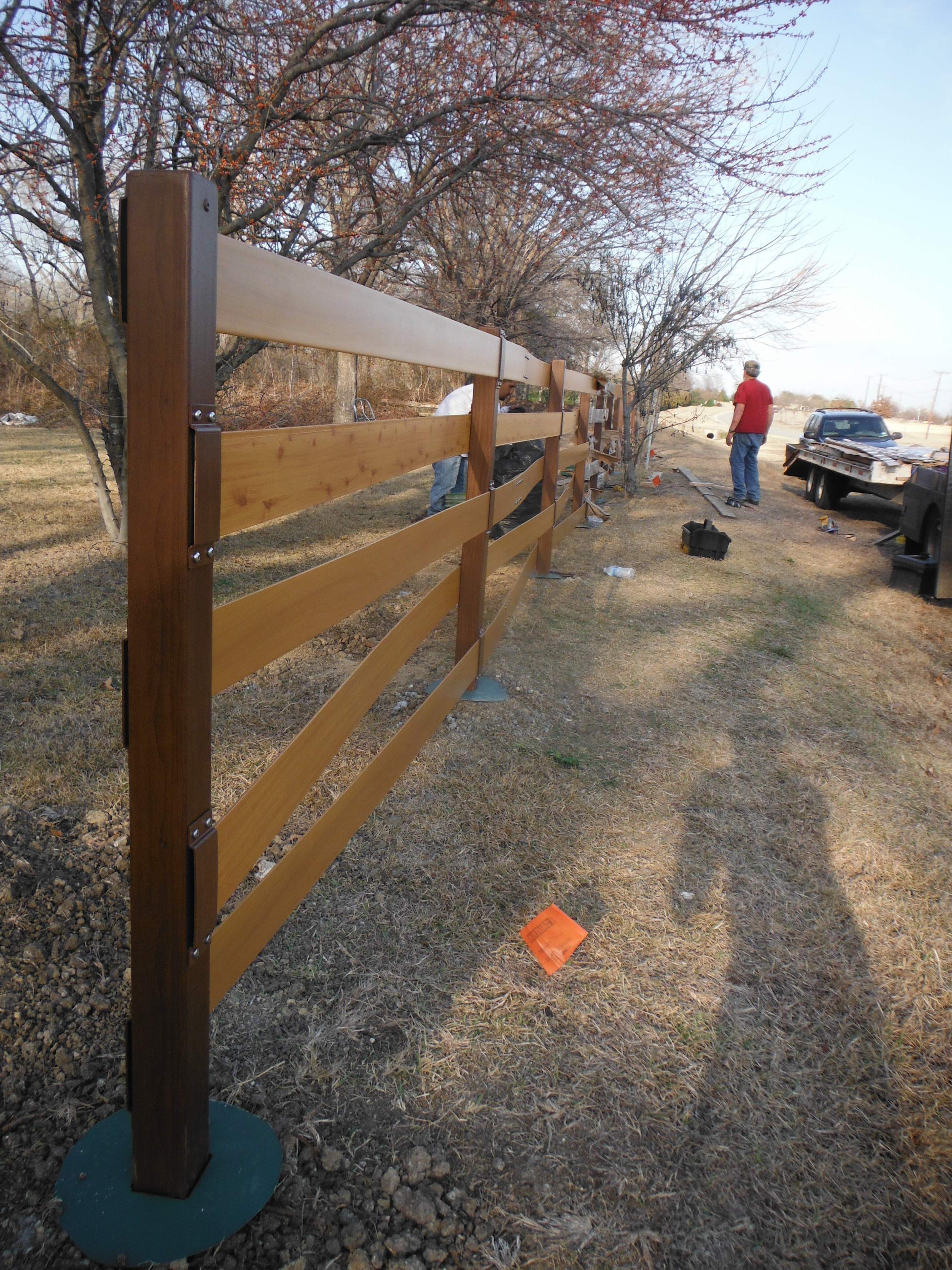

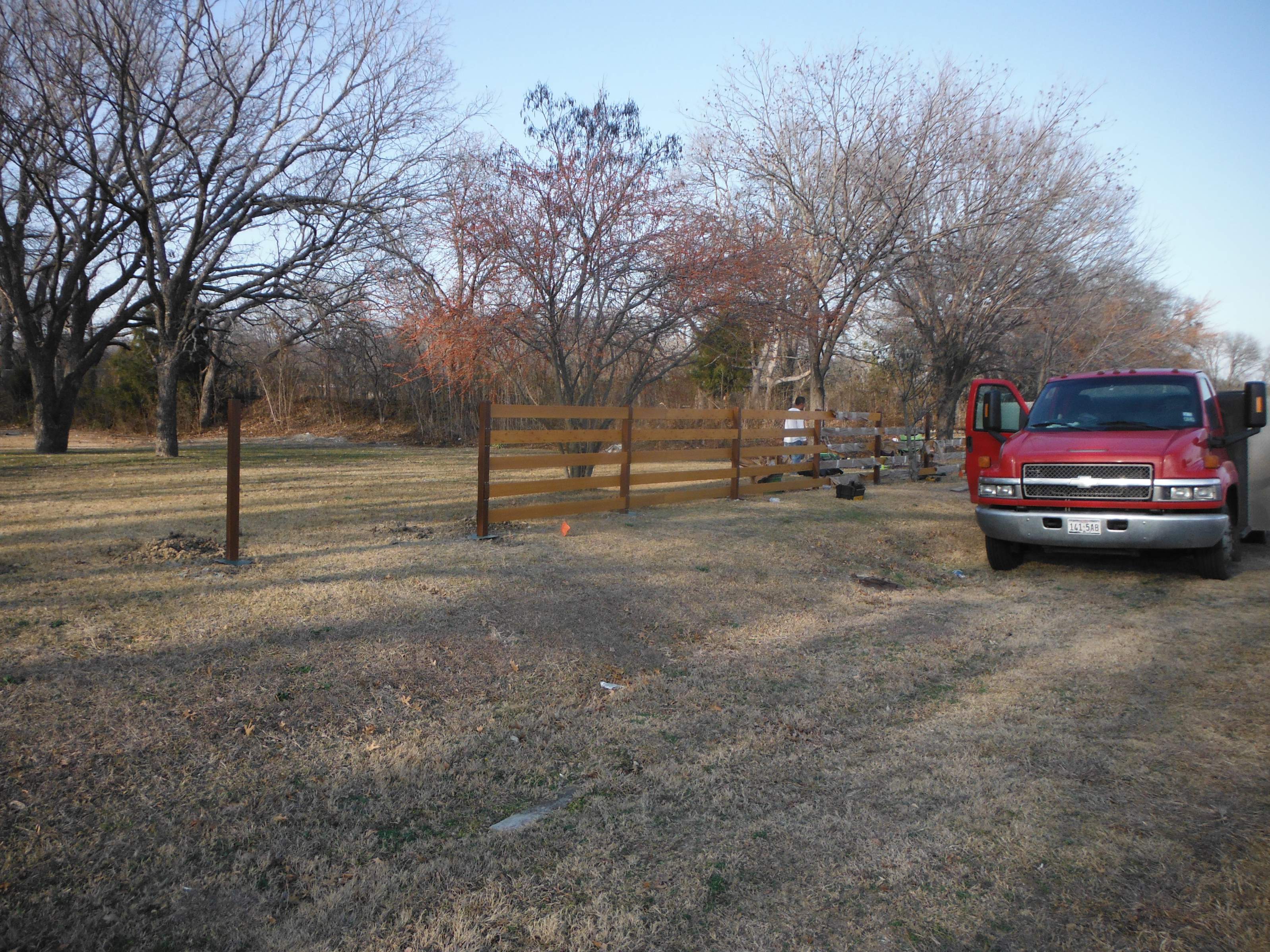

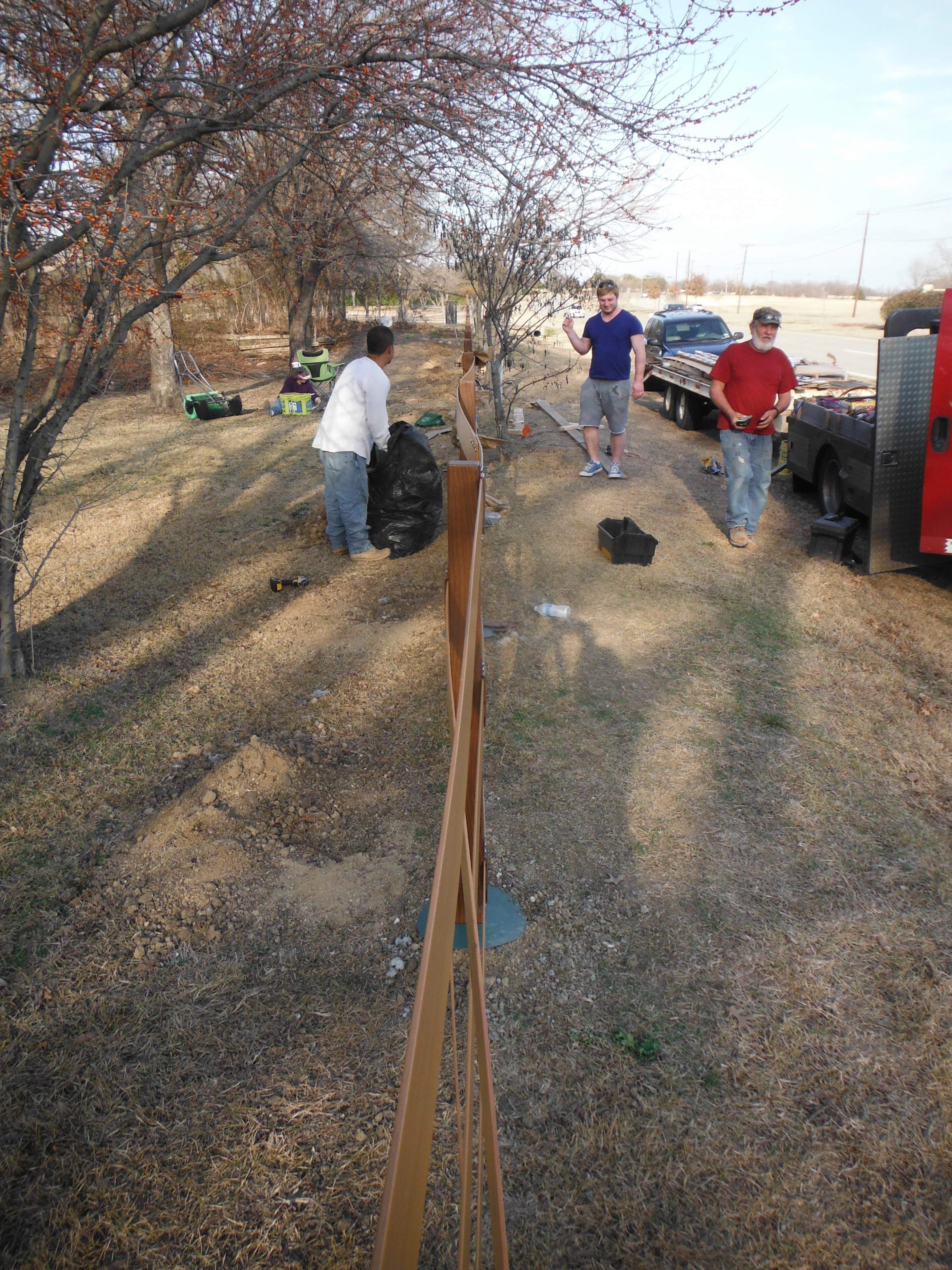

Yesterday morning we picked up 45 each 20' rails and got to start the installation of the rails on the fence. It is trial and error because I don't know of another fence like this one. We have literally hundreds of components and they are multiple colors and patterns.
One of the interesting things that happened to us was the clients and friends stopped by to tell us how great the fence looked from the highway. We only took time for lunch and could only see the fence from the fence line where we were working. But when we left at 6:00 we drove by the fence on the way home and it does pop from the street.
There is so much hand work on this project. The weed eater beaters are seamless gutter aluminum that has been hand cut into shape and had the hole placed for the post in the middle for instance.
