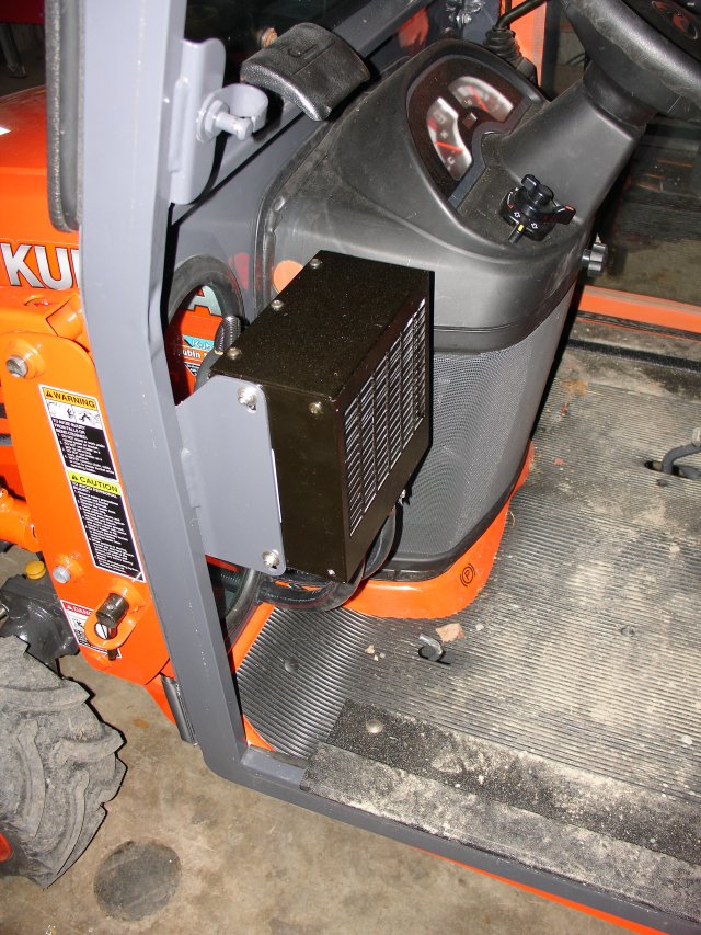

I wired up a small ceramic fan/heater on the right cab support post. I can move it to point towards the w/s or towards me. I works extremely well in keeping the cab warm, and the w/s fog free. Here's a pic:
Here's where I think I ordered it, this is similar to mine, which I dont think is offered anymore.
12-Volt 150 watt Ceramic Heater/Defroster
Regarding your wiper falling off, are you sure you have it pressed down all the way onto the shaft? Mine fits very tightly.

Heater, the propane unit is a great idea, before you add an electric ceramic heater make sure u have enough amps to run it. They can suck up a lot of power and drain your battery. If u go with the propane heater add a fan to blow air across the windshield.
I installed a heater off the engine, if I had to do it again I think I would have gone with the set up above. The heater stays on the tractor year round since it is connected into the engine. The rest of the cab comes of in the summer. Here is thread I did last fall on how I get my BX ready for winter.

New,
Find out what the amp output of your alternator is before you hook up a heater. Ask the dealer or check the specs out on your tractor. To determine how many amps take the heater output in watts and divide by 12 to get amps. So a 150 watt heater will need about 12.5 amps to operate. Do not not forget to add up the other lights you have going at the same time. So if you have say 2-55 watt flood lights on the front of the cab and 1- 55 watt flood light on the rear you have a total of 165 watts or 13.75 amps, PLUS the heater of 12.5 amps and you now have a draw of almost 27 amps. Add a fan and now you maybe over 30 amps. Get my point??
On my BX I had to go to a bigger alternator to 40 amps to carry the load of all the lights, and other stuff a cab adds to the "need to have" stuff. Lights, fans, flashing orange light, etc etc adds up quick.:D
To give you and idea, I have 2-55 watt lights in the front, 2-55 watt lights in the rear, orange strobe light, fan for the heater, windshield wiper motor, chute rotator, chute deflector, and hazard 4 way lights all going at the same time when I operate at night. They have to see you and you have to see what u are doing.:D

NY_yank,
Thanks and good point. Also something I would not have thought of :)
One of the things I learned early on from this site, is the standard alternator on the 2305 wasn't that impressive. I had the dealer install a 35 amp alternator prior to delivery.
That said I have 2 55 watt lights on the front of the cab, 1 55 watt rear light, factory headlights (which don't work worth a **** in my mind and not used when blowing snow), hazard lights (only occasionally used when driving on the road to get to and from the house and barn) and the windshield wiper if that works. The chute rotor on the 2305 is hydralic.
Adding the heater/defroster that jdgreg mentioned should keep me under the 35 amp limit.

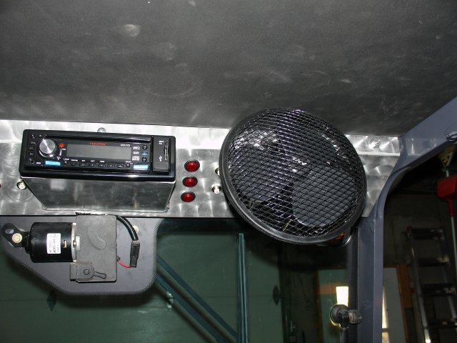

I install a cab heater and a fan in my cab, those 2 functions very well all the windows are clear.
