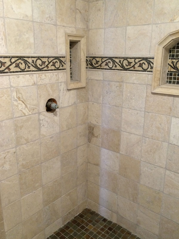

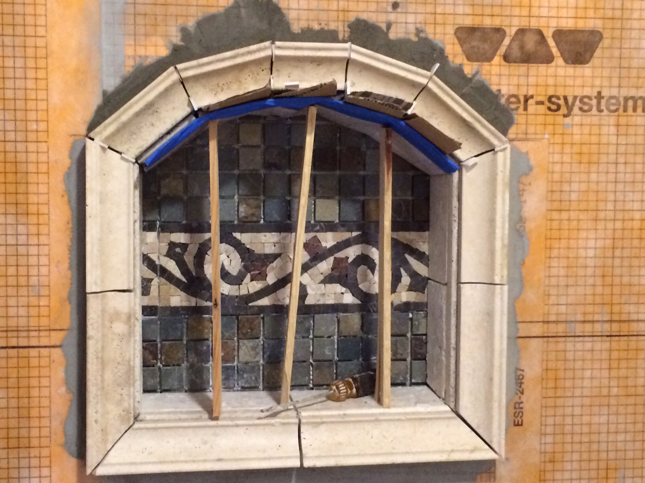

Kerdi claims you can use drywall. I wouldn't. I'd use cement board.
As for the floor, just do the mud bed floor. You can buy a plastic guide that you lay on the floor and it has the correct slope to the drain. Then you put down your mud mix and screed it flush with the top of the plastic guides.
As for Kerdi, its a great product but you have to use unmodified thinset mixed loose that you trowel on the wall surface. Then you apply the kerdi membrane and use a trowel to press it into the thinset while trying to remove all air bubbles from under the membrane. You also use unmodified thinset to adhere the tile to the kerdi.

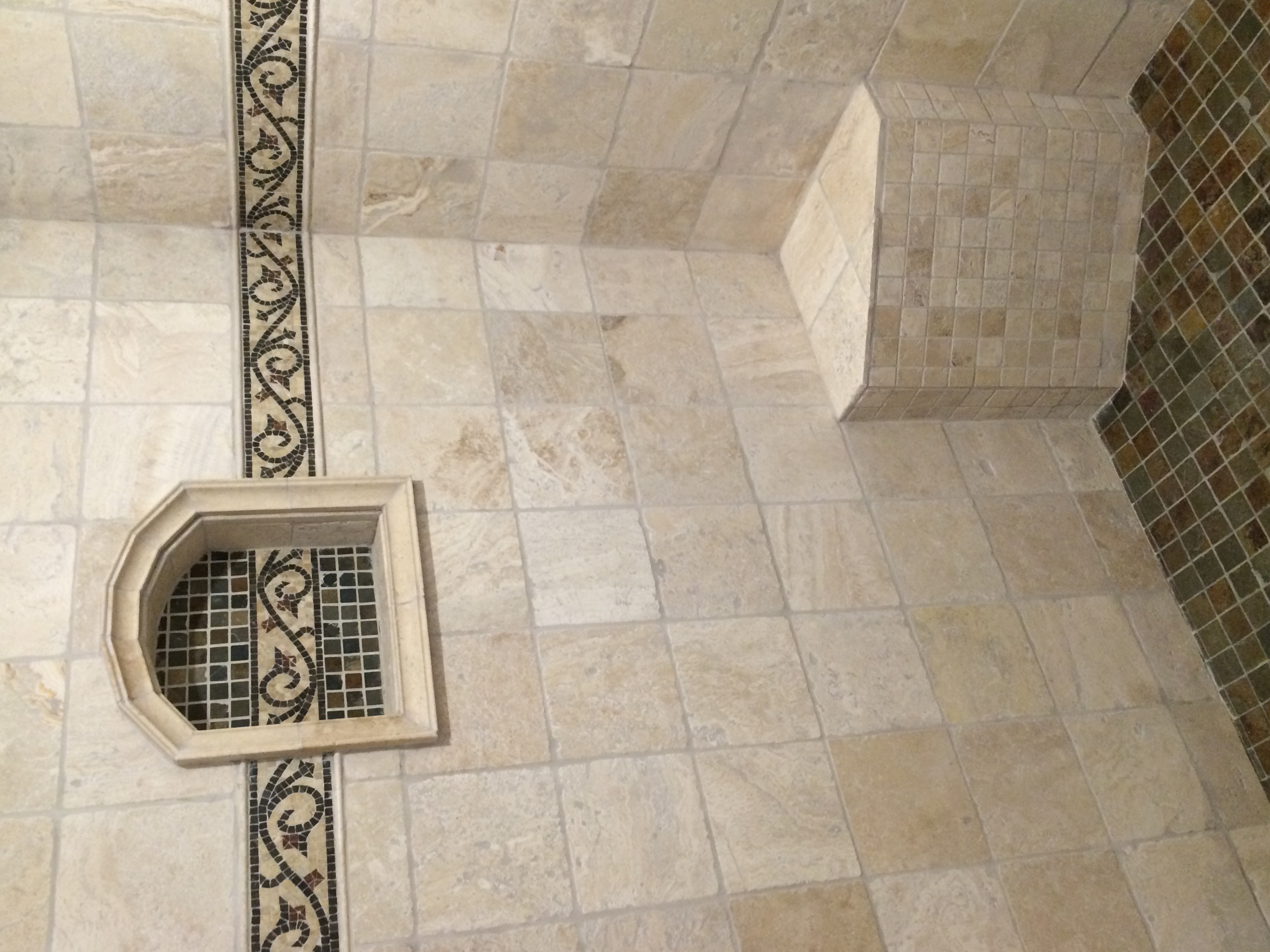

It can be done by a do it yourselfer but its a total ***** to build a shower like that including all the tile work. I spent about 6 months doing mine. But then the tile isn't your average do it yourself tile job and I have a tiled seat in the shower as well. If I had it to do all over again I'd hire it done. I'm not exaggerating when I say its 50 times the work you think it will be.
Oh, and I wouldn't even attempt to tile it without a rotary laser or without having my own tile saw.

Thanks. Yes, if you like doing the work it makes a difference. I hate, absolutely hate tiling. I messed up the first time I put up the wall board. After it was up I found out how badly the wall bowed. I had to rip it all off and buy a power planer to plane down the higher studs. The low studs I sistered another stud along side it.
On a wall not in the shower, a wall I didn't build and because of plumbing limited what I could do with it, I had to buy special drywall mud that can be put on thick and float on 1/2" to 3/4" of drywall mud to get the bow out of that wall.
The second floor room in which I installed the bathroom didn't originally have plumbing. So I guess all in all it was a lot of things that added up to it being a ton of work. I guess an existing bathroom might be easier to start from.

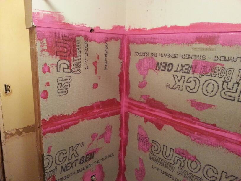

Redguard is the toughest stuff once dry that I've ever seen. This stuff is amazing. uploadfromtaptalk1461870210417.jpg
   / Kerdi shower system, a do it yourself project? #18
Redguard is the toughest stuff once dry that I've ever seen. This stuff is amazing. View attachment 466531
Warning, cement board (specifically Durock) is NOT waterproof. Per the Durock literature:
Water Proofing: "...if a vapor retarder or waterproof construction is specified, a separate barrier must be applied over
or behind the USG Durockョ cement board. If waterproofing is desired, use USG Durock Brand Tile Membrane or
USG Durock Waterproofing Membrane." http://www.usg.com/content/dam/USG_...durock-cement-board-system-guide-en-SA932.pdf
When building a shower, you want a "water proof" installation. If that was a tub alcove, then the installation would be acceptable. For it to form a water proof barrier, the membrane must be applied continuously.
