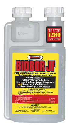

trying to figure out what to use to kill algae in diesel fuel ... this is in a massey 2705 tank [no algae in slip tank] .... the tank does not come off readily as far as i can tell, and this is the only plastic tank on the place ..... i know i will have to blow out the fuel line, clean the transfer pump screen, and change both main fuel filters ,,,
i am in canada and my options are limited, the one option [kill'em] no longer shows on ebay, or on amazon...
what else can i pour in, ?? the tractor gets used very little

Killing off the stuff is only part of the problem. All the goop will remain in the tank to plug things up even after you kill it. Draining the tank & sucking everything out might be enough.
"Diesel biocide" will be the magic term to search for. Personally I use Power Service Bio Kleen Bio Kleen Diesel Fuel Biocide - Power Service in my big 300 gallon & couple of smaller tanks. Never had a problem even with it taking a year or so to go through the tank. I'd rather waste money on a biocide than waste my time & fuel cleaning tanks. There are other brands that should perform similarly. The other big thing is keep water out of the fuel, that's generally the catalyst to start the microbes growing.

Biobor JF Diesel

Yup.....Biobor is great stuff, and is usually available at marine supply stores.
West Marine sells it, but they closed their Canada stores.
The OP might look for Biobor in a Canada marine supply store.
Best idea might be to try to have the local Home Hardware store order it.
Perhaps also check with a Canadian Tire store.

I found Biobor JF on ebay, went and ordered it ... eight ounces [treats 640 gallons] for US 21.11 with a ship cost of US 12.25 ...
I do have a ATF pump with two micron filters that I can sacrifice for this, and just let it pump for a while ..

I already have got some Biobor, just waiting for the road to open up to the farm, a mile and half is plugged ..

I couldn's get it in canada, not at fuel dealers, nor at Case or JD .. I finally got it on ebay, from a boating dealer in New York, price was [I thought] reasonable .. it came in fairly quickly, no hassle or fees at customs ..

I couldn't get ANY brand of biocide [specifically to kill algae], from local fuel / farm equipment dealers ... I'm in a small town of about 20,000 population ....
That particular brand I couldn't find in canada [just from using ebay and search engines], but I did find it in the US
