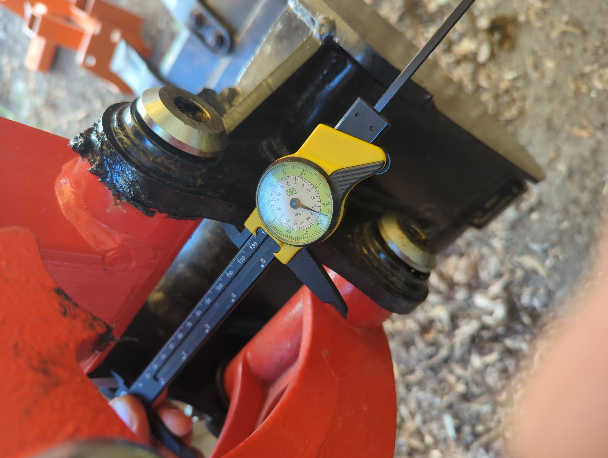

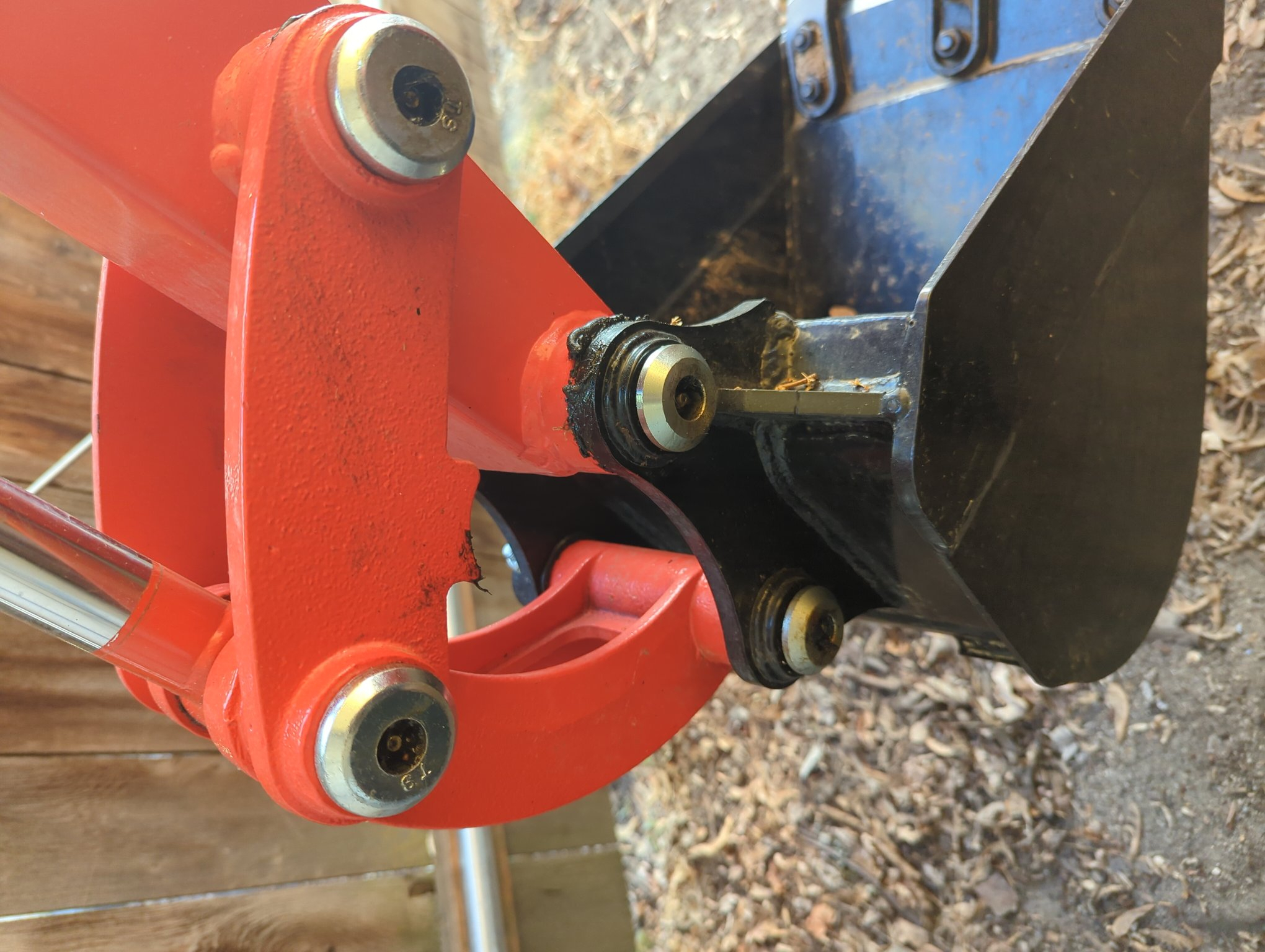

I am looking for the same - a narrow trenching bucket for my kb2475l (ck2610 hse tractor).
Can anyone with the NH, LS etc confirm theirs against the Kioti?
here's the spec's of the kioti bucket:
  1. 1" pins
  2. ~136mm / ~5.35" between between the bucket bracket / ears
  3. the pins on this bucket (the Kioti oem 12") are approx 5.25" apart on center (this is not a fixed distance, due to small link arm)

see my last reply over in this other thread..
Backhoe - Backhoe bucket interchangeability between brands
I would have a pretty high confidence that the buckets will match with similar size backhoes from at least LS. I am trying to match the larger size hoe buckets (Kioti 2485/LS31XX) and found that they are the same. If you open the webpages for backhoes on Kiotis site and on the LS site, you can see the specs for each backhoe to see which models are teh same from each brand. LS lists a lot of variations, but they aren't real. Anything that starts with a 31 is the same hoe and matches the large Kioti "85" backhoe. Anything that starts with a 21 is the same hoe. etc.
