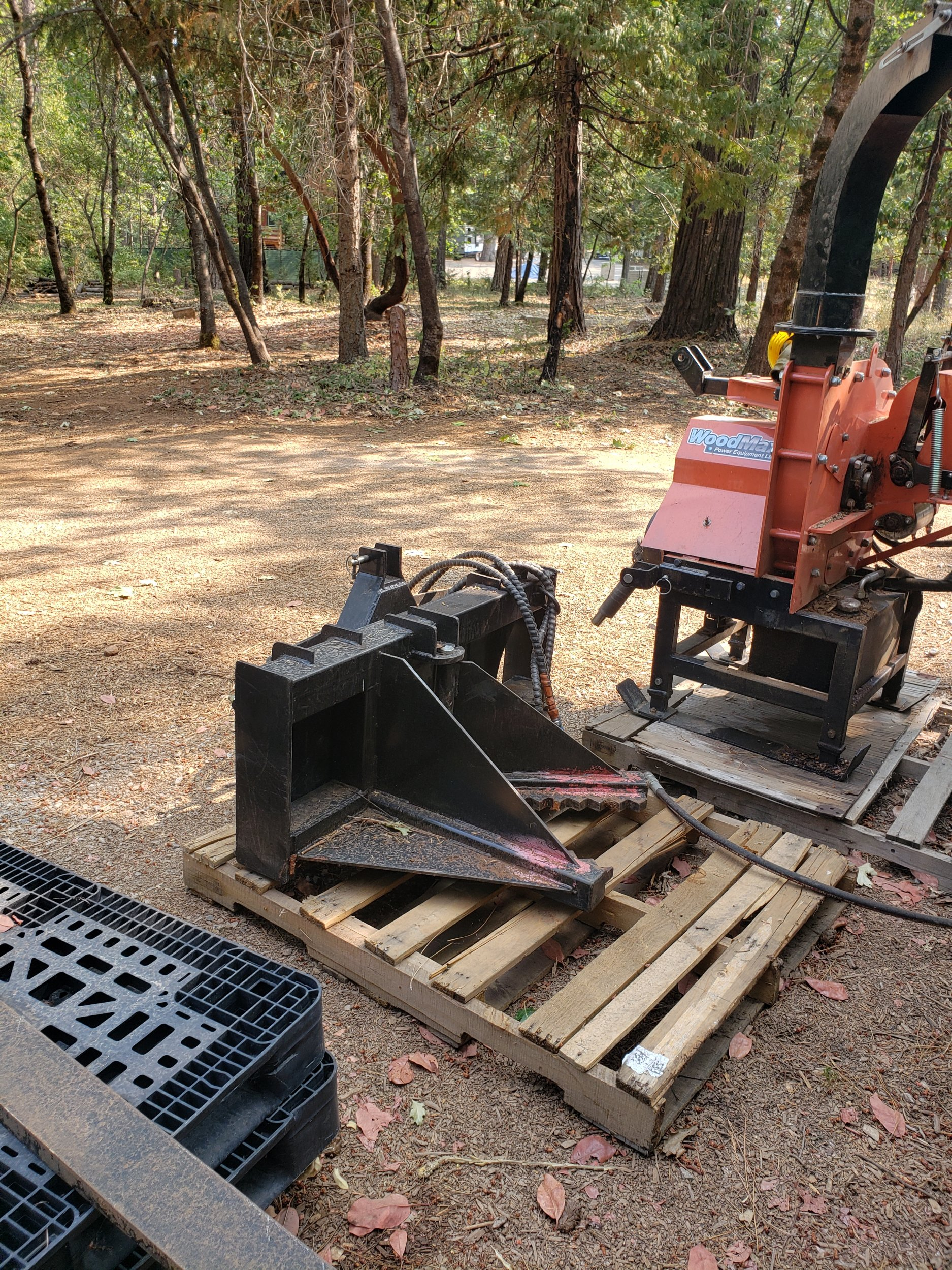

Here ya go. (Go bully the dog after you take that reference pic for us)

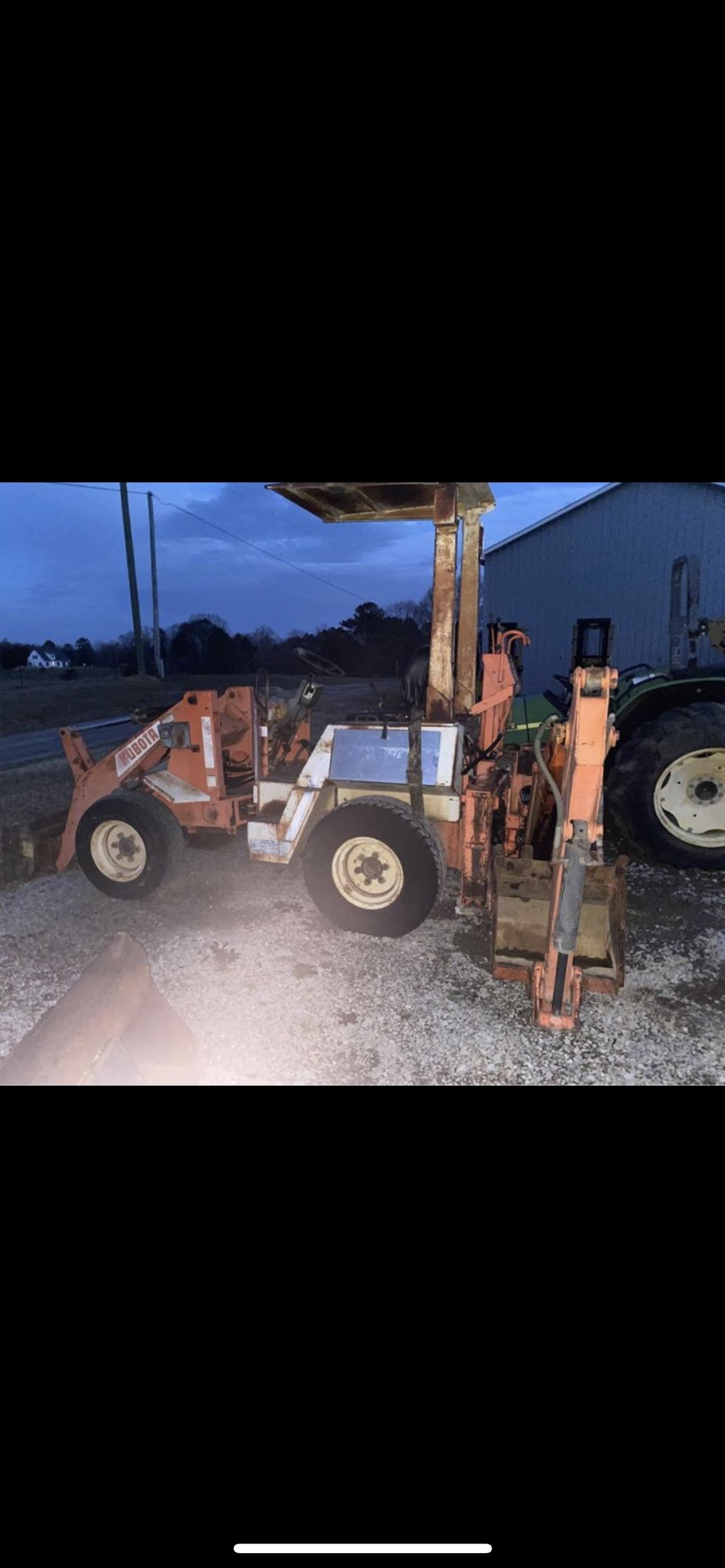

I just saw this machine on market place. I’ve seen some track loader backhoes but that’s the first articulated backhoe I’ve seen especially that small. They were ahead of their time with a mini articulated loader with the ability to work off both ends. They could have had something with that.

I was trying to pull a 6" diameter oak tree out of the ground with a fel mounted post puller. Push, pull and lift. It was probably the 100th tree I pulled. It just caught up with me and the tractor. Its pictured with a 3 point adaptor attached

I was trying to pull a 6" diameter oak tree out of the ground with a FEL mounted post puller. Push, pull and lift. It was probably the 100th tree I pulled. It just caught up with me and the tractor.
"You scarin' me." :oops: I'm gettin' ballasted and loaded rears off the ground often with a similar grapple doing the 'push-pull' on my T1520 w/110TL and on 3-4" trees in light soil. While I'm adding SSQA to the TC33DA's more powerful 14LA not sure anymore I couldn't bust the tractor. Elms have 'side' roots/runners and might rip a lot of sod coming out, but oaks have tap roots. They're no joke and why I bought the DR stump grinder.

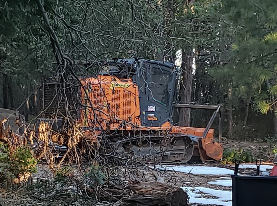

I bought the tractor used with 1800 hours. I have no idea what it was used for before I got it. The fel it came with was the wrong one for the tractor. I had to do some reinforcing of the mounts to get it to hold. Thats probably one of the reasons why it broke. I broke it with about 2100 hours. I freely admit I abused the poor thing. To complete the tasks I had, I made the decision to replace it with a Kubota M6060 and have the property professionally masticated. Now I wont have the need to abuse the tractor and, I have enough tractor to the jobs I'll need it for.
