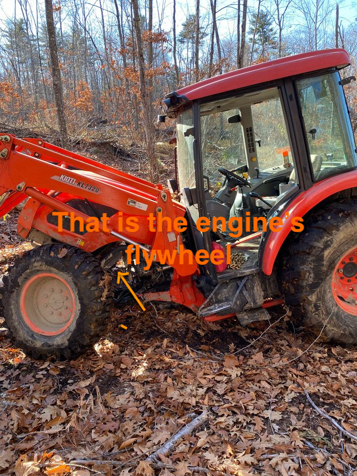

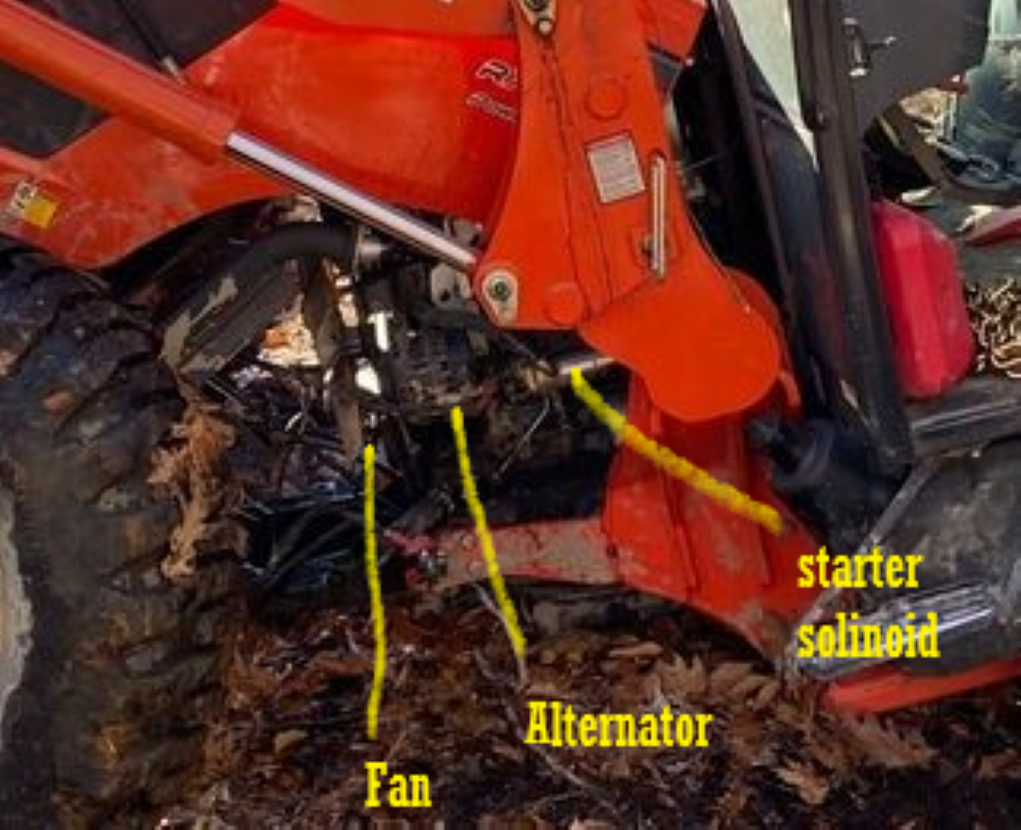

Obvious abuse. Using a little farm tractor as a piece of heavy equipment. That grapple is ridiculous mounted on that loader/tractor. Anyway, 30 pages of discussion, phew!

For my own amusement I brought up this machine at my local Kioti dealer, and wouldn't you know it, the machine has been sold and supported by their other branch. Not only that, but the gentleman I was speaking to had seen this very machine on numerous occasions. The conversation was enlightening; this machines demise was inevitable, having seen a short but rough life of abuse. It seems both the dealership and Kioti were cooperative with previous issue(s!) that could be argued as abuse, and by the time he broke his machine in half they were done with him. I don't know what more to share, but if a Moderator or Administrator would like the remaining details I will fill them in; I'm just not about to publicly post specifics that could very well be wrong, given it is still just one side of the story.
I will say this, between this thread, the photos, and my talk at the dealership- I absolutely believe this was abuse, and that Kioti makes a damn good product.

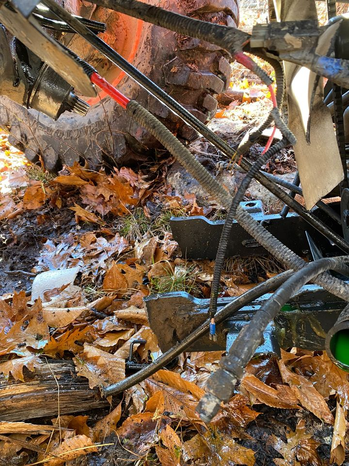

No. Not even close. Treating a farm tractor like a piece of industrial dirt/logging equipment will get you that result. Every time.
Though I will say I noticed additional factory steel welded (small patches or gussets on both sides) on the px9020 frame vs the DK90 frame right where a stress concentration occurs. I am not worried about my DK in the least. I don't operate it like a dozer or forestry skidder.

shouldn't that be under warranty
A lot of people think that since they paid so much money for their tractor that it should be indestructible. That’s not the case. A tractor is really a pretty delicate piece of equipment. A loader is designed for loading, not ramming, prying or dozing.

In defense of the tractor, it was being winched by the crane, and the crane jerked it, which broke it.
   / Kioti Broken in Half #314
Whenever I have a tractor that's stuck when pulling something, I ALWAYS put my chain under the tractor, back to whatever IT'S pulling, and pull on that.
If it's a hard pull, I NEVER hook on the front of the tractor!
