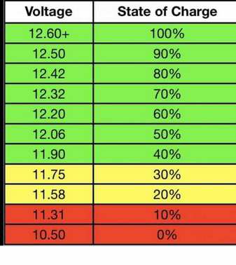

Remember we call them 12V batteries, but if your actually reading 12V or less without any load, you have a weak battery at 50% charge level, and the starting problems is probably your battery not responding to load. Just cannot turn over your engine. So you may just need a New battery. For lead acid batteries 12.6V+ is 100% charge at no load. AGM reads 13.6V at 100% charge and no load. Lithium reads 14.1V at 100% charge Screenshot_20210115-172459_Google-picsay.jpg
/ Kioti CK20s starting issues #11
What ambient temp is that chart for?
/ Kioti CK20s starting issues #12
I don't think FLA battery voltage is affected so much by temp. However, capacity certainly is. Batteries will loose voltage quicker at cooler temps.
/ Kioti CK20s starting issues #13
I really searched for the ambient temp but there was no citation given. Another paper on lead acid batteries, suggested the chart used a 77F or 25C ambient temperature.
/ Kioti CK20s starting issues #14
I did also, and believe you are correct with that temp. It took some digging past all the pay to play sites to find some useful info. Wow, what a cut and paste marketing circus this internet has become.
