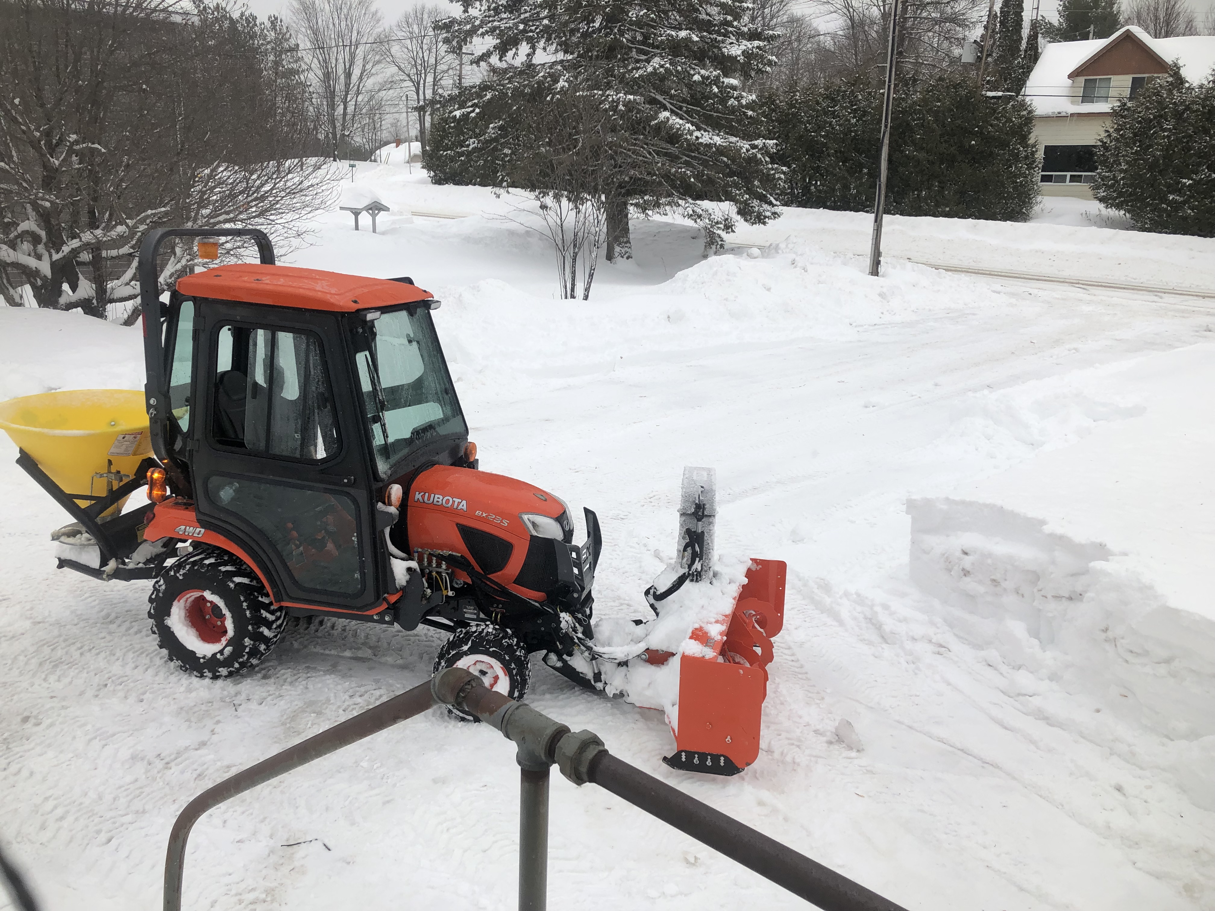

Here's what I bought (OEM cab)
Its small, but that's what I wanted!
Had absolutely no problems moving all of this.
Got video of that too.
