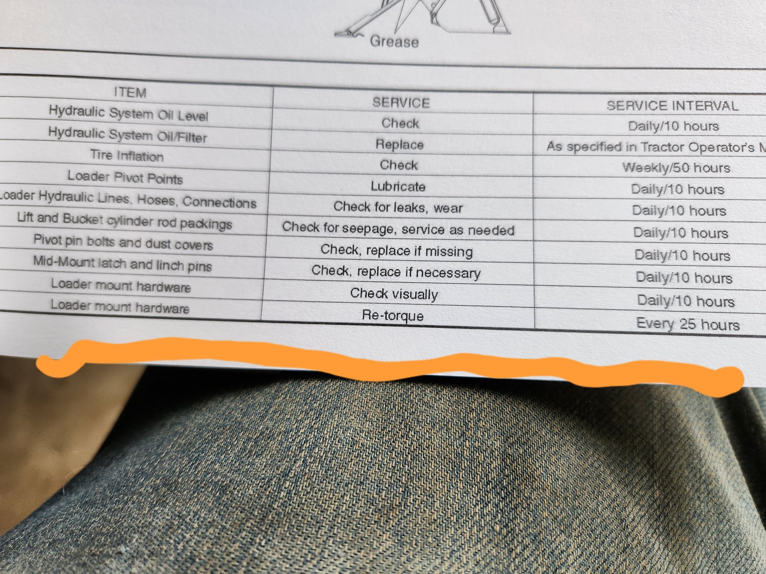

So, I know we went Way off the OPs question, But. Anyways, I had kinda kept an eye on my loader bolts, as well as wheel bolts, but after this, figured I should check. Now, keep in mind, I'm only at like 78 hours or so, and maybe 13-14 months of ownership on this machine. Grap a 22mm (maybe thats wrong, it's bigger than 21mm, but 22 felt a bit sloppy but worked); set torque wrench for 90 ft/# after all, I was just checking, and didn't expect any to be loose, and didn't look up numbers. Of 14 loader bolts, I got rotating at 90 ft/# on like 10 of them, some of them a good bit. Then check, and it's more like 140 ft/# (Google, not manual, that's inside).
Point being, all of us should check more often. That coming from someone who was talking crap a few posts above...
So, what's the best seasoning to put on crow when forced to eat it? :)
