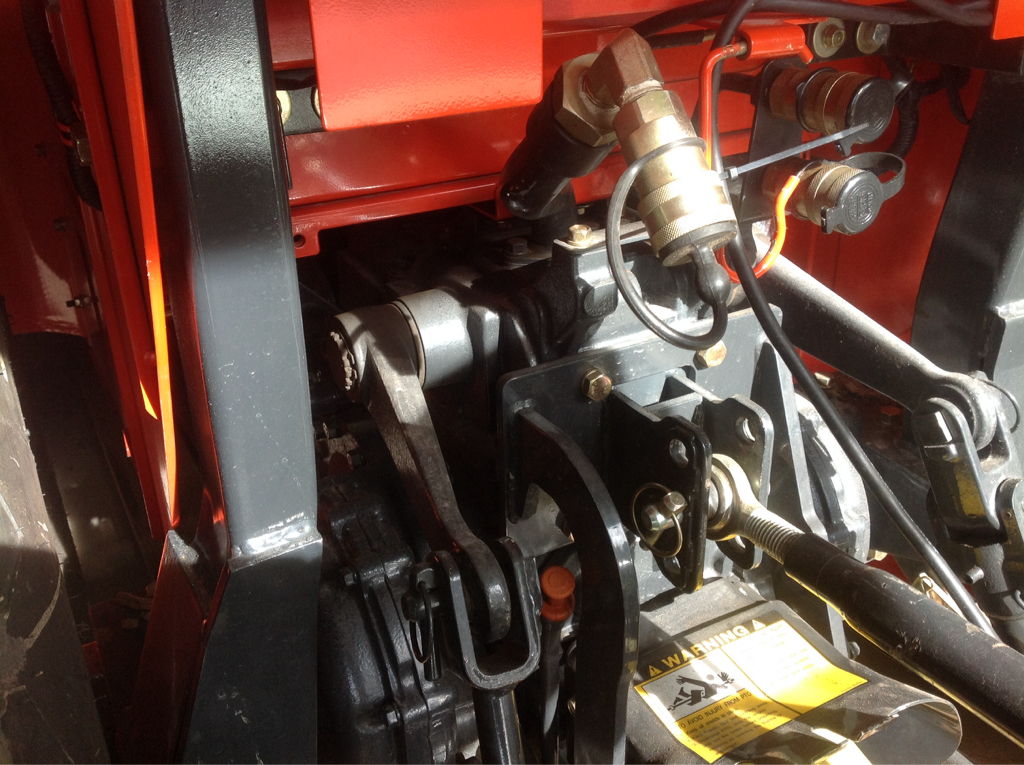

If your dealer installed the dump kit for the backhoe return,you can remove the QA connector along with the elbow and nipple and fill the hydro fluid from there.
It's a lot easier than pouring almost 8 gallons through the dip stick hole.
Mine doesn't have that. There are four remotes on the back, the same ones you have on the right and then the same thing is on the left side.

Some return at the remote and some return to the fill hole as seen in the photo of post #34.
