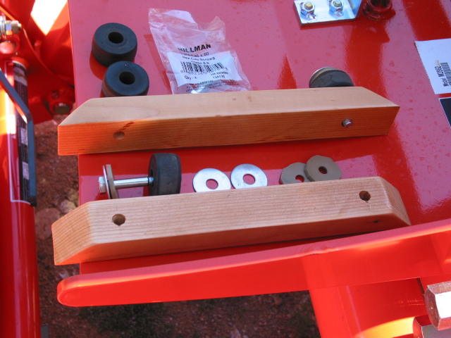

Hope you get another 15 trouble free years too. I hear you on the seat. None of the imports have a seat to fit me - and I'm a pretty much normal 190 lb six foot guy with size 13 feet. Frankly, it doesn't matter which imported tractor we talk about, as far as seats go, all the seats and platforms seem small.
Every new tractor I promise myself that this time I will spend the money toput an Grammar air seat on it....but in the end didn't do it.
What I did do was spend a day rising the seat up on some wood with rubber grommets for cushions & some big washers changed the seat angle a bit - just little things.
It was a day well spent. Take care of your back.
