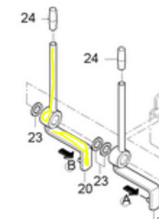

I just completed the install of a 2nd remote kit (T4145-A04040302) on my DK40se and would like to share some of the things that I learned the hard way.
1) buy 2 10mm x 1.25 nuts to install the longer studs. Put the first nut on and use the second to lock the first nut in place. Thread the stud completelly into the casting and then remove the two nuts.
2) the new valve is stacked onto the existing valve and will be closest to the rear wheel side of the tractor. Not towards the center of the tractor as I read here. The control levers will not function properlly as one is taller than the other.
3) the new valve comes with the orings already installed, no need of the orings (04810-00100 and 04810-00160) in the kit. Orings are found only on 1 side of the valve body.
4)the snap ring on the lever shaft is hard to get at. I had to access it through the side panel and had a tough time getting it back on.
5) the seat is heavy and an extra set of hands helped get the seat out/in without banging something up.
Although it took me longer than 2 hours complete, it was not too difficult. Thanks for everyone's input that gave me the confidence to attempt the install.

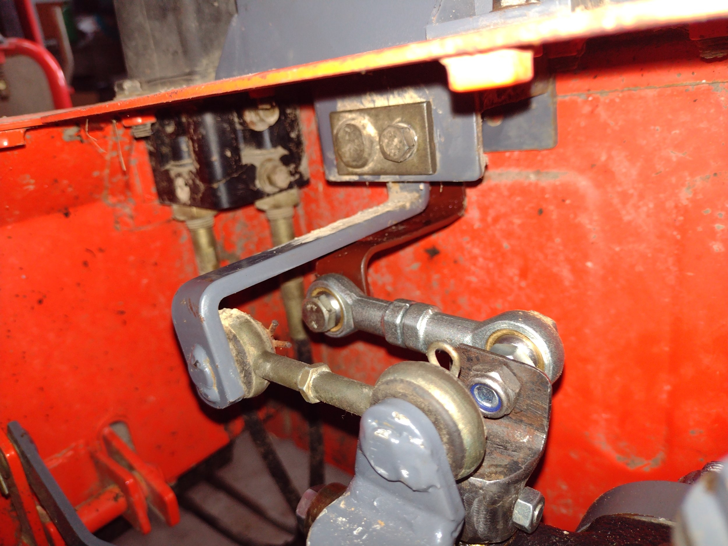

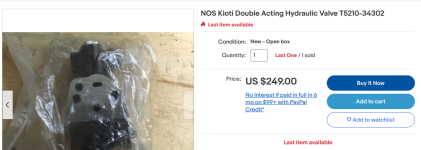

13 years later on and i just did the same on our smaller ck35 to enable us to use our feed our wagon that requires 2 remotes, the kit is no longer available but i did manage to find a double detent valve on a surplus site. i therefore had to manufacture the rest of the stuss from the lever, linkage and pipes to the rear,
I got the hydraulic place to make some 90deg swivel fittings to tube and ran it to the rear bulkhead and attached to iso couplers via bulkhead swagelock compression fittings, made a lever linkage up out of a pair of m8 rod and balls, also i just used some 10mm x 1.25 allthread to manufacture the longer studs. took me about 2 hours to manufacture the lever part with some 25mm round stock and some 5 x 20mm bar.

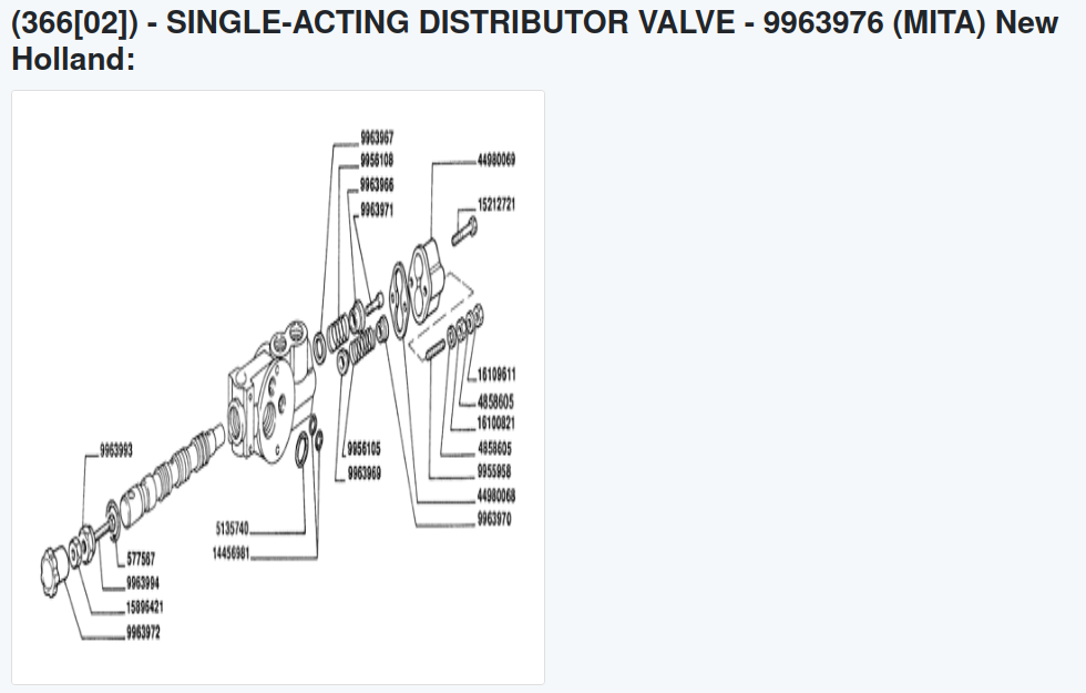

The valve is made by Mita hydraulics Italy but i wasn't able to find it on any of their catalogs.
2 kickers that got me, firstly they say in the parts the studs are "T4681-37861 STUD, M10X120MM" , I found this was to short and had to cut my bar 10mm longer to allow the stud to screw in completely and still leave enough exposed thread for the nuts to fully thread on, possibly the description is incorrect?? secondly as bigturk said its 10x1.25, M10 is actually 10x1.5 so the thread designation was wrong as well as in practice its definitely metric fine 1.25mm. i actually would have preferred a single detent valve but the double was all i could source. there were non detent, single detent and double detent options,
008264 DETENT DOUBLE ACTING VALVE
008266 DOUBLE ACTING VALVE(DETENT)
000826 VALVE, DOUBLE ACTING

same "mita" valve also was used by new holland,
