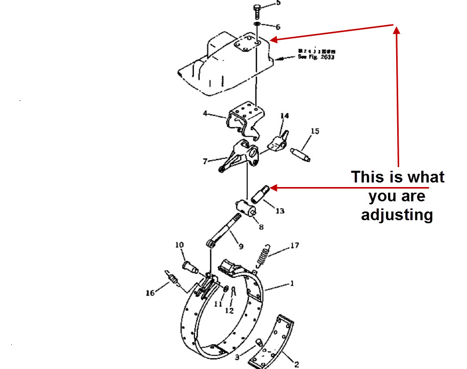

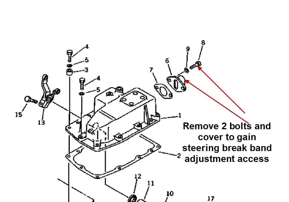

About the adjustment you made to the turning clutch/brake...discribe the location of access/process of adjusting, if you would...we have a Komatsu 20A that is doing the same thing. Thanks ! earl ettabor@bellsouth.net

Hi Andrew...Earl here...Just rcv'd your post & am knee-deep into this Komatsu as-we-speak. Unit has been layed-up for years. Gave out in the field & there it stayed. Poor maint. prior to that stoppage didn't prolong the incident. Have studied the situation about the brakeing (turning) problem & know that the steering starts from the hyd. pump (clutch housing mounted) & sproket clutches are actuated by this pump and are further controlled by the steering levers/petals which add a braking band into the picture to actually do the turning of the machine. These bands are adjustable from the rear of the tractor...through two, two-bolt covers...bullet-nosed...& once re-moved...allow for a hex-headed nut to be turned. DO NOT back all the way off on these nuts...the band will then be diss-conneccted from the drum & further tear-down will insue in order to get back to square one. ( I have made that mistake...).
Attached is the location of the steering break band cover access port.
Larry
