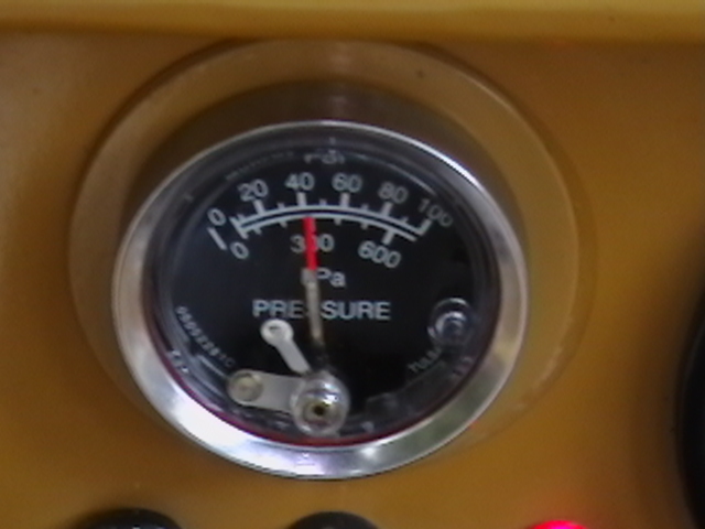

I think the last "toy" the Dozer needs now is an oil pressure gauge.

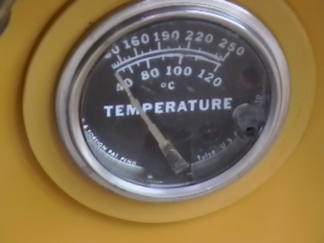

As for your oil pressure gauge, I'll share what I used in three places. Coolant temp, engine oil pressure, and fuel oil pressure (which really helps when I get attacked by the bugs). All are connected to a strobe light under the ROPS. Another option would be a piezo elerctric speaker.
http://www.fwmurphy.com/20p_25p/
