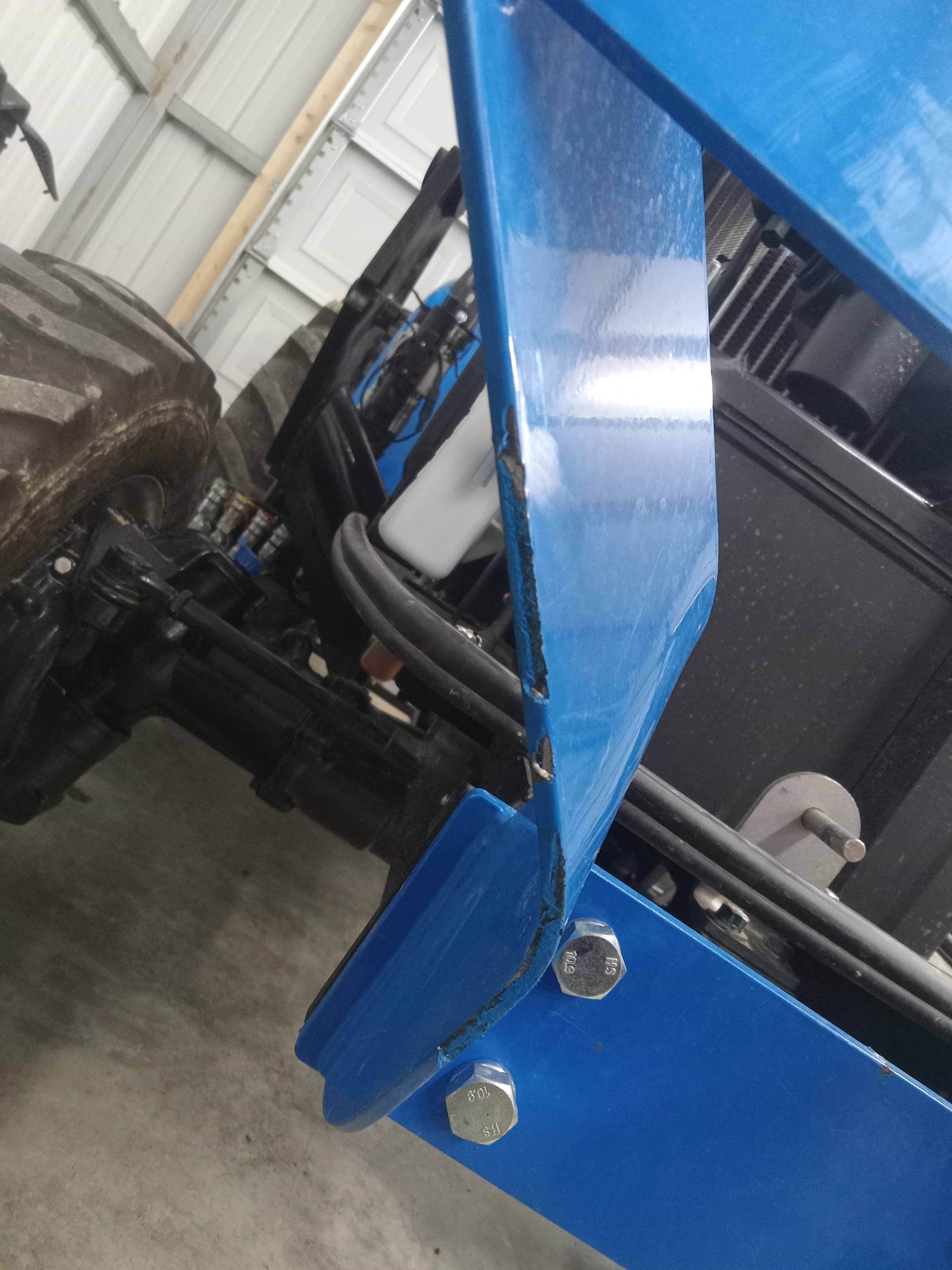

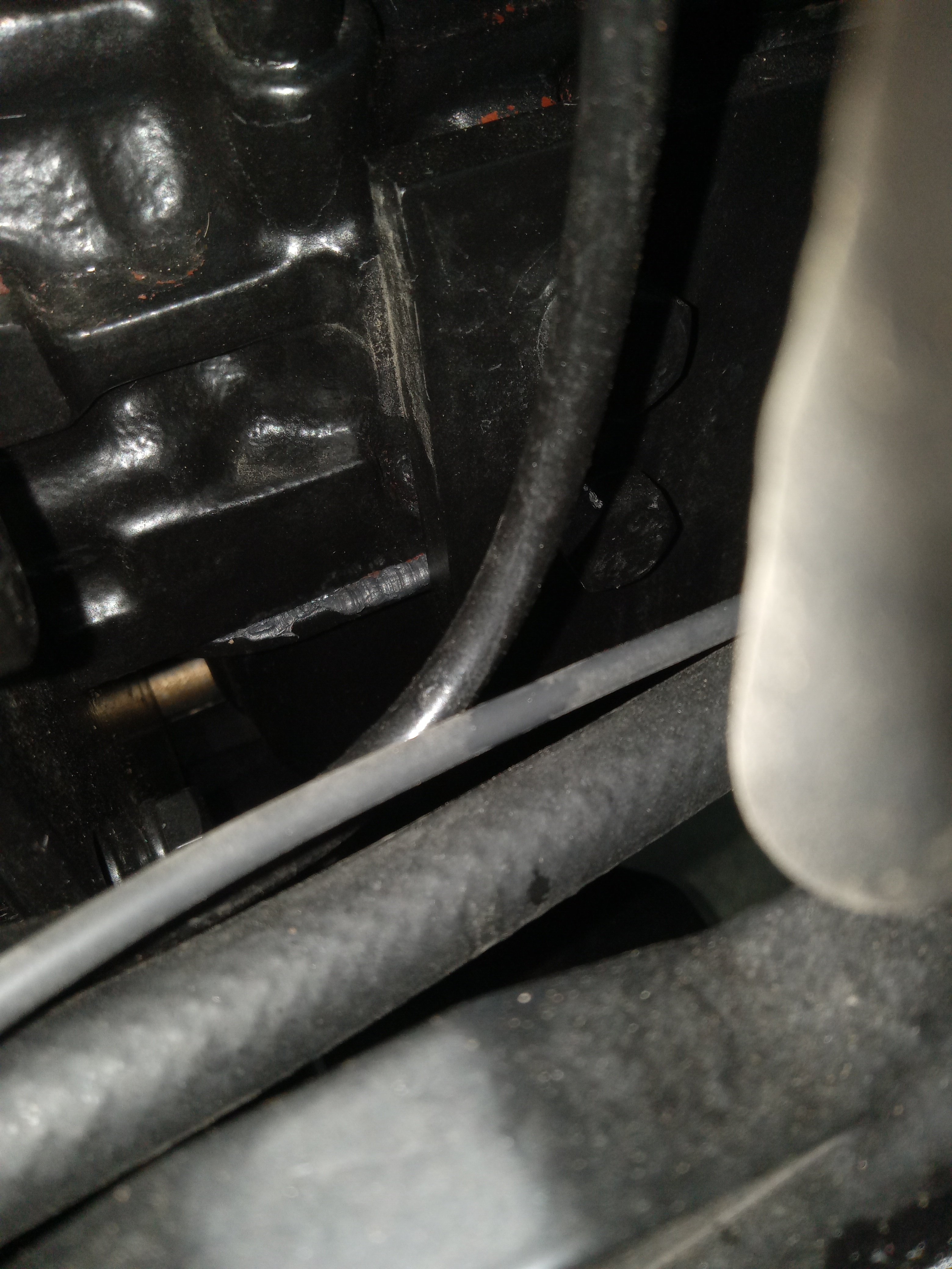

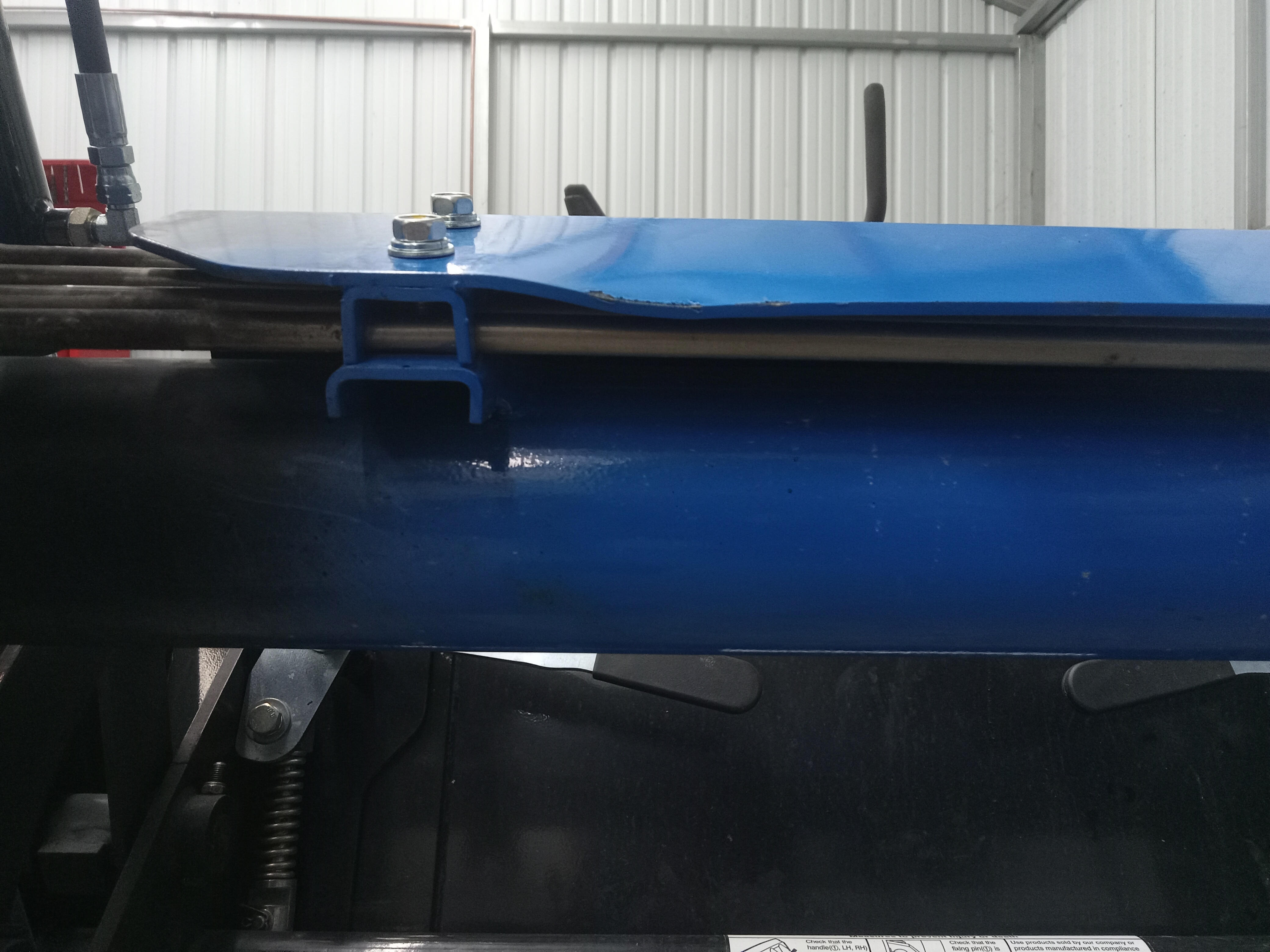

Been busy, its hunting season. Finally got around to putting dye in the fluid. Yeup took all of 1hr of run time to find the leak. Its the hst input shaft seal. Bottom up the pump is soaked in fluid, bell housing has a valley in the casting that has to fill before it starts dripping out the weep hole. So nothing has hit the ground yet in the 1hour of run time.
That being said, i refuse to take it back to the dealer i took it to. As they damaged my tractor , did a half azz job on the oil pan and " could not find a leak " for the hst. The other local ls dealer is booked way out on work. So its listed for sale and i will use it till it sells and or completely blows the seal out.
I got ahold of ls about this whole ordeal, showed them the photos of the damage the shotty work and the leaking pump... they could care less and offered zero help. Ohwell lost a future customer and will steer every one away from them
