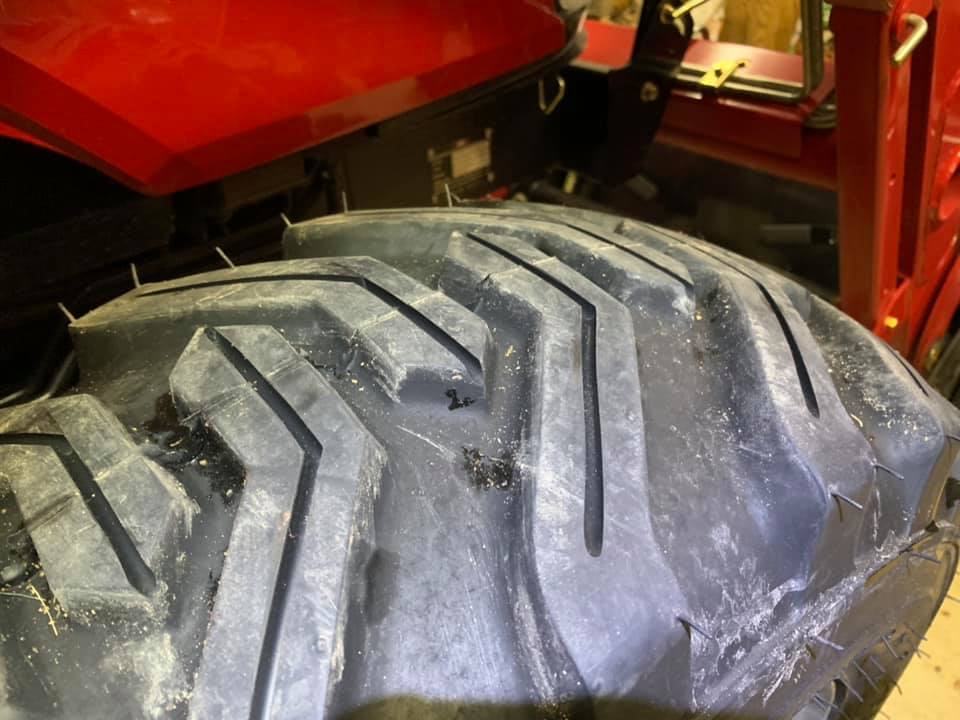

If you wanna be on budget and still get R4 tires, you can use a heated grooving knife tool from Ideal to greatly improve snow traction. Follow this thread in the tires section https://www.tractorbynet.com/forums/tires/431713-groovy-tires-3.html
