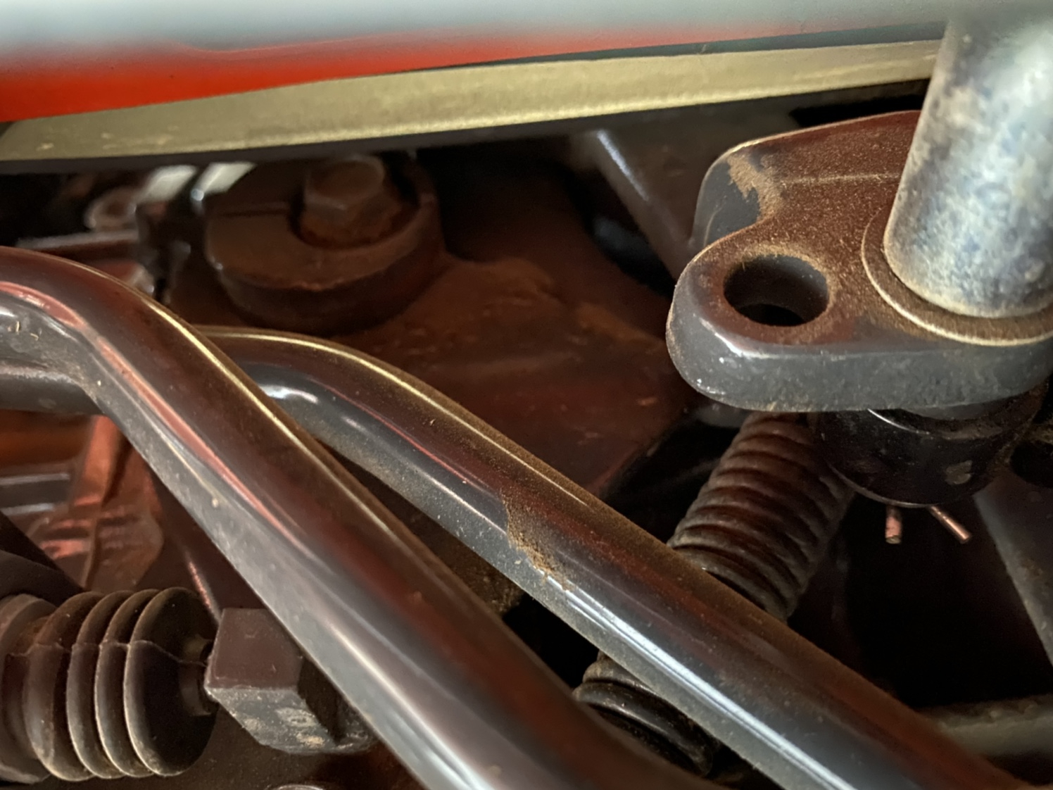

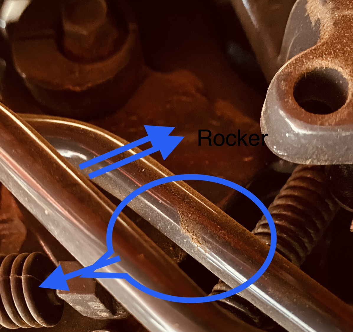

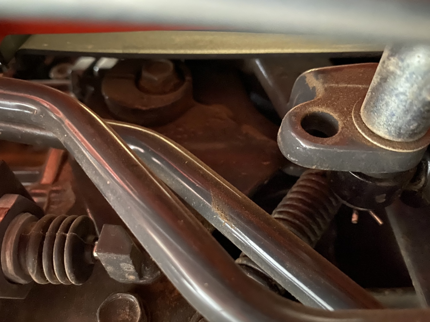

This on my LX2610
Two arrows point to the rocker.
The arrow and circle point to the neutral switch.
There are no grease fittings on the 2650 nor the 2610 for the hst peddle.
This set up was changed between the 2 tractors.
On my B2650 I saw rust on a pivot, above the neutral switch.
That was what I lubricated and fixed intermittent starting problems.

Thank you all for this info an pictures... i have already dealt with the peddle issue and replaced all worn parts two months ago. Im positive it is not that....this time.

Thank you all... good stuff. I found the safety switch for the hst peddle had loosened up and was not in alighment with the hardware that activates it... so close but not detected till i got help watching things move. There are two nuts under there that are hard to tighten because access is so damn difficult.
