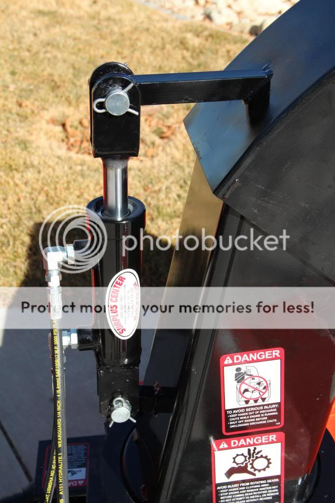

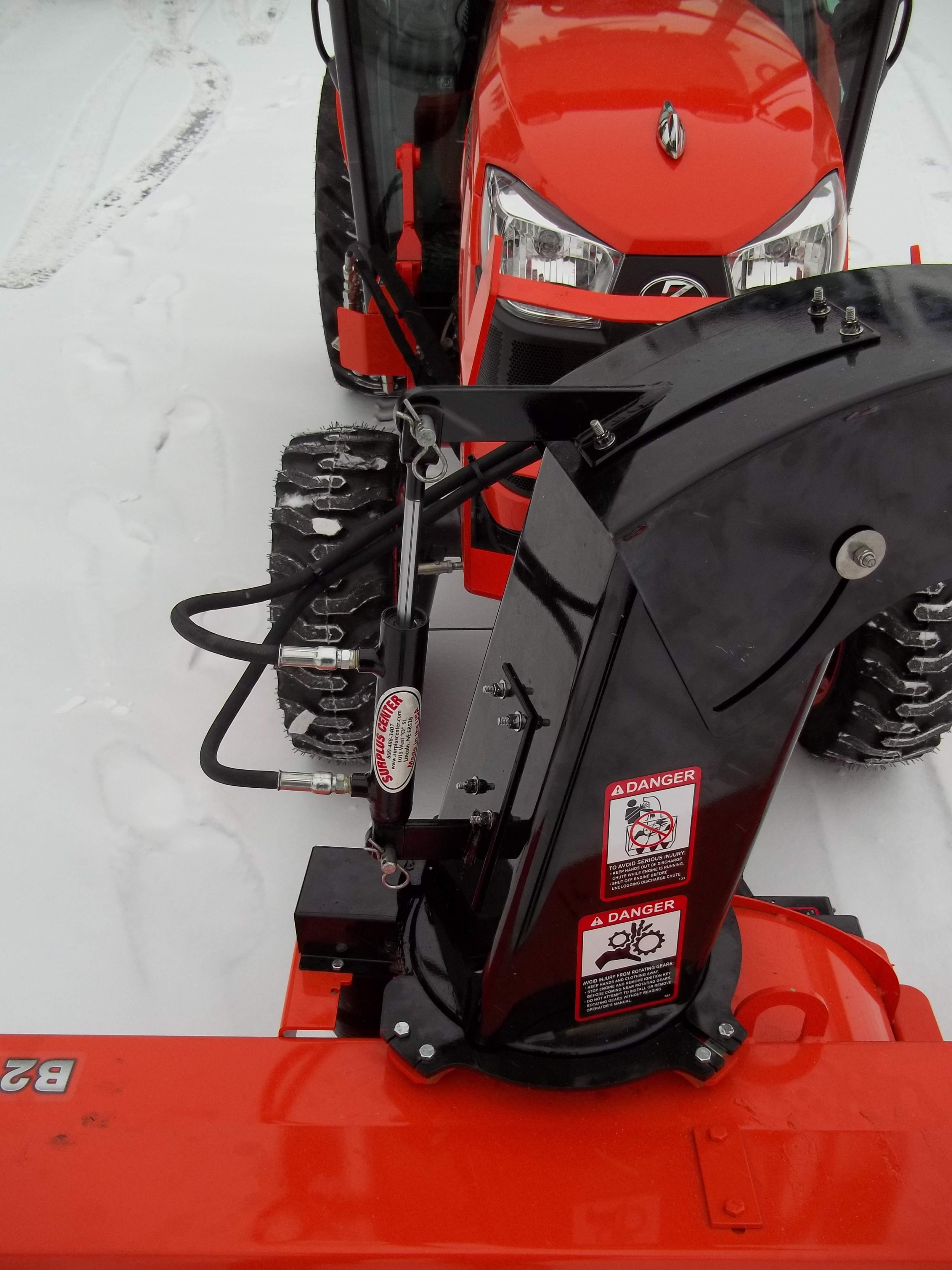

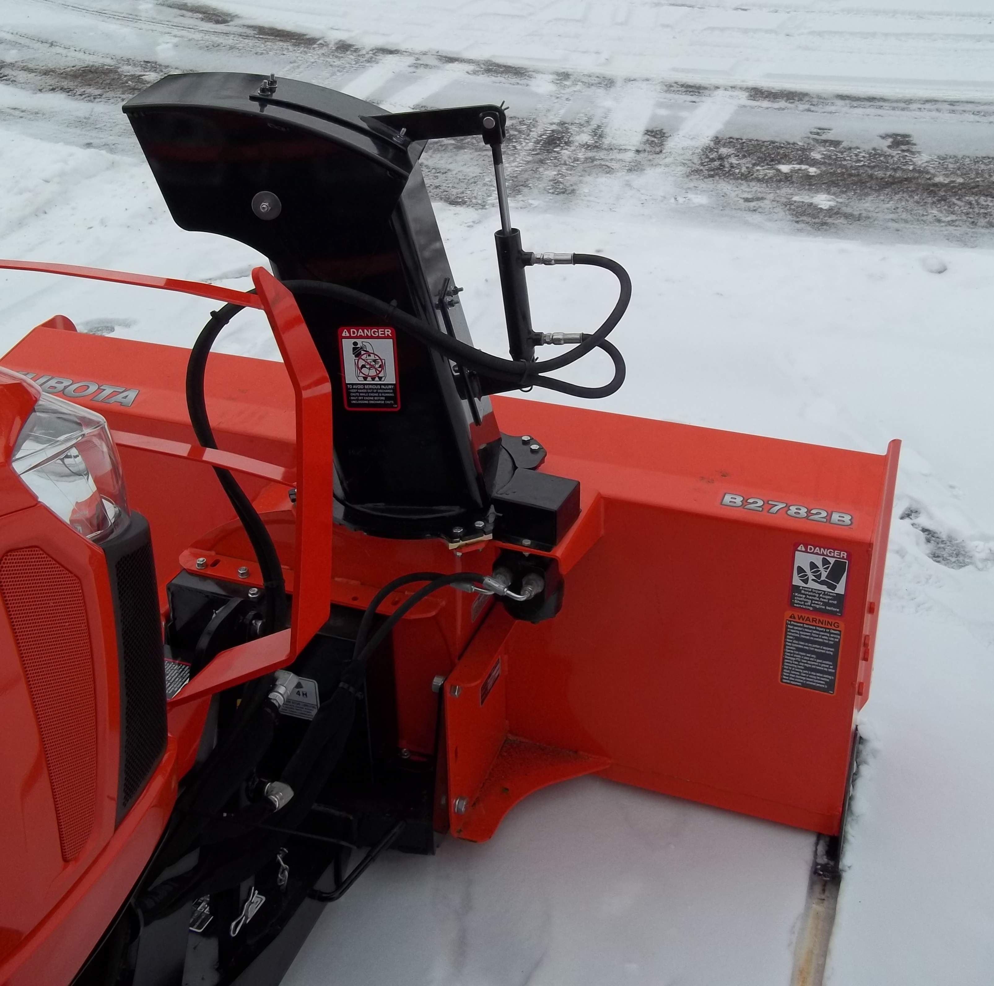

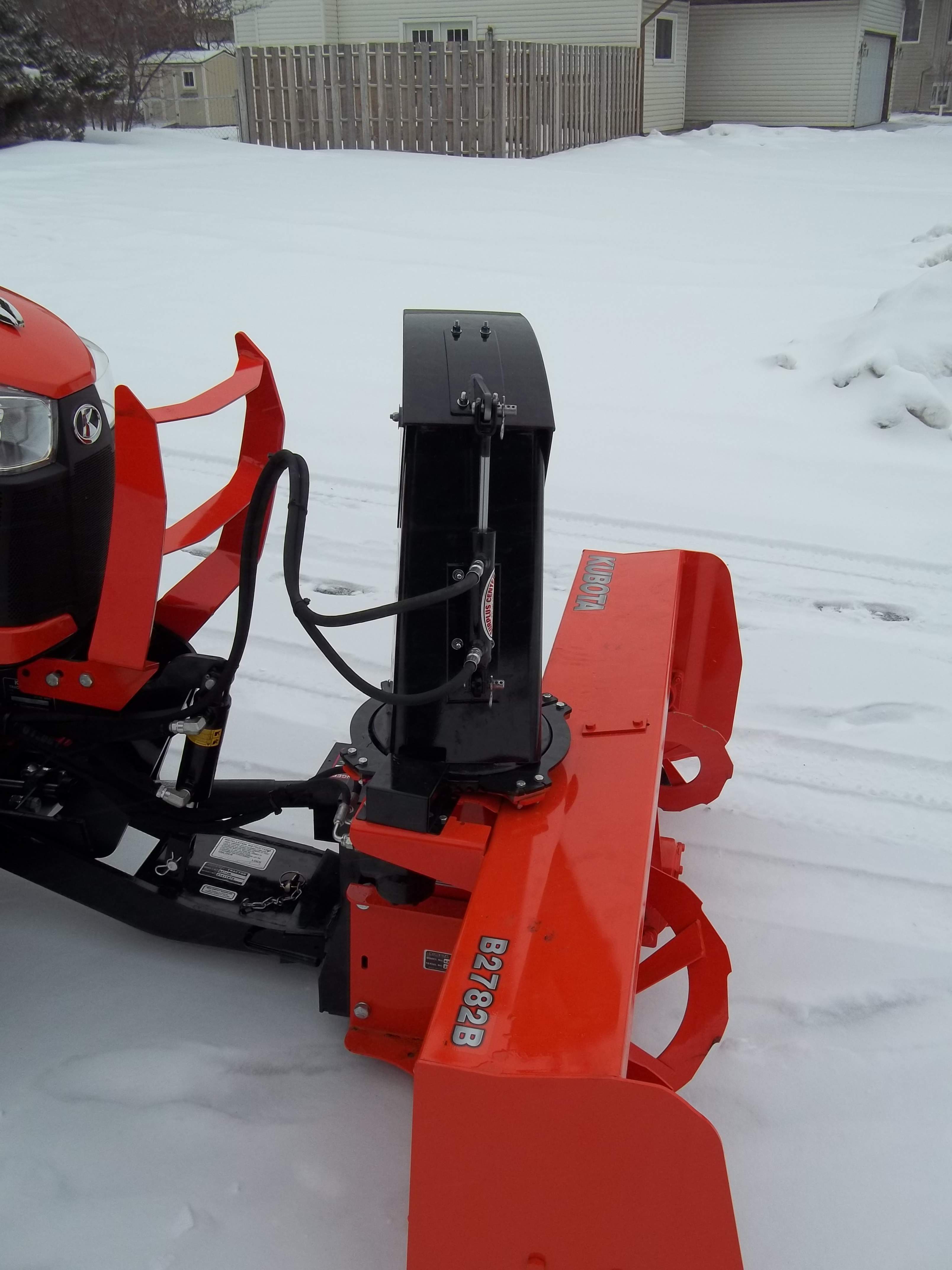

Here is the hydraulic chute deflector that I built for the front mount snow blower. I could not justify the crazy cost of a kit from Kubota, so with the help of the fabricator at my shop we built this. It runs off the dump/curl function of the loader joystick, but could just as easily run of a third function or rear remote. It bolts to the existing holes in the chute. Not that we built one, we are thinking we may build more if there was interest from other folks in buying something like this. Wondering is there is any interest in buying this as an add on kit or buying the brackets and adding your own cylinder and hoses.
View attachment 413523View attachment 413522View attachment 413521
I did similar, but using a 2" diameter cylinder - one certainly doesn't need the power for the deflector, I was just concerned that a smaller cylinder would travel too fast. Even with that larger volume of the 2", I still added a 0.032" restricter orifice to slow down the ram speed to something more easily manageable.
Lining the chute with UHMW PE for no clogging and even more throw distance - - now if we just had some snow, a bleak year here.
bumper
bumper

Or perhaps the mfg change their MO and decided to pre-drill the chute to accept the Kubota's supplied brackets for their deflector option? I briefly looked into buying parts from them - thought they were a little pricey. Easier to do it myself. I decided not to use reinforcement plates as the chute looked stout enough for directly welding bracket and lever arm for the cylinder (knowing that if I goofed, I could always go back, fix cracks, and do it right the second time :c). I planned the geometry so that the chute just fully opens and closes at the ends of the cylinder stroke with no over or under travel stress.

I made them on my lathe. On 1/4" fittings, I drilled the existing hole in the fitting and tapped it 1/4 -20, then annealed a 1/4 - 20 set screw and drilled the set screw part way with a 1/8" bit, then the balance with the .032" wire drill.
On larger fittings going to cylinder ports, I made a disk type plug that would be a press fit in the connector, center drilled plug .032, then TIG welded the plug in place.
Only one restrictor needed per cylinder.
I did the same for the 3-point top and tilt.
I searched on line for suitable restricters, and found some adjustable ones, but nothing I wanted to use. I'm sure they must make them though.
