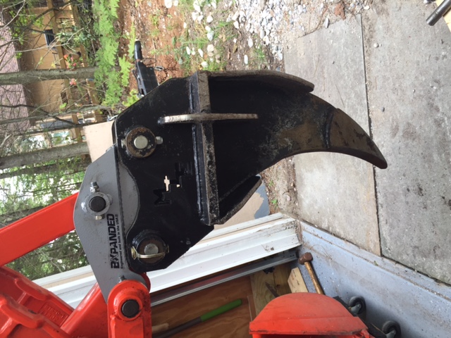

Oh, yeah - one more questio: does anybody know if it is compatible with Bro-Tek's ripper tooth? (That is the one that I have.)
That's what I have too. Do you have a thumb as well? With my Bro-Tek, the thumb works for holding bigger stuff, but unlike the thumb and bucket combo that will grasp small saplings etc, the crescent shape of the Bro-Tek blade allows them to slide right through. So I was going toe make an
"anvil" to bolt to the thumb face out of 1/2" steel, the anvil shaped to mate up with the Bro-Tek. Good thing I haven't gotten to that yet, as the quick connect will change the geometry of that anvil too.

I have the BH 77 with the Kubota mechanical thumb which I converted by adding a hydraulic cylinder and have the 24 inch bucket. Right now the thumb goes inside the bucket so the bucket and thumb doesn't hit at the bottom of the teeth. I have the Michigan Iron ripper tooth and have not had it on to see how they mate up because of the time it takes to put on. I am doing this for convenience and not really concerned about geometry at this point. I would assume that there are two different models of the adapter since they are shown separately .

Well, tomorrow I get e adapter so we will find out.

That didn't take long . . . how long ago did you order? I'd of guessed they'd be backlogged with the new product. Speaking of which, and knowing how much more useful a hoe is with a thumb, and how much better a hydraulic thumb is that that mechanical one (having to get off the tractor to deploy, adjust, and stow (what a PITA!) - I'm surprised nobody has come out with a hydraulic upgrade kit for the BH77. Like others, I paralleled the curl cylinder with a solenoid valve and button on the joy stick. It was basically all off the shelf stuff, I only weld modified the cylinder so the thumb won't bonk the cylinder on full retract (it did as purchased as the cylinder was about 1/2" too short) and that 1/2" spacer gave me a few inches more opening movement while still not hitting the dipper. There's about 1/8" of clearance at each end of cylinder travel, so full available range of motion is utilized.
If I go with the quick connect, and I likely will pending your report, I'll modify my plans for the "anvil" for the Bro-Tek ripper to mate with. Pretty sure it will all work okay together.
One minor concern is that the QC adapter moves the bucket out a little, and this would take away a small amount of digging breakout force?? When I adjusted the tractor bypass, mine was a couple of hundred pounds too low IIRC, the difference was quite noticeable. (Procedure in another thread.)

I ordered it Friday night at 11 pm online. I did the curl cylinder paralleled with a solenoid mod also. I have the Michigan Iron ripper tooth which is quite a bit different than the Bro-Tek so we'll see how that works. I also had to adjust the bypass up by 200 psi and that improved the lift.
Randy
   / Kubota B2650 and B3350 info and hints #270
I have put the Bxpanded quick attach adapter on to my BH 77 and didn't notice much difference using it than without it. Of course , the time it takes to change out attachments is a whole lot quicker. I know the geometry has changed, but I only use it for my own use and do not hire out for jobs so I don't know if that makes any difference to me. Here are some pictures from my installation.
