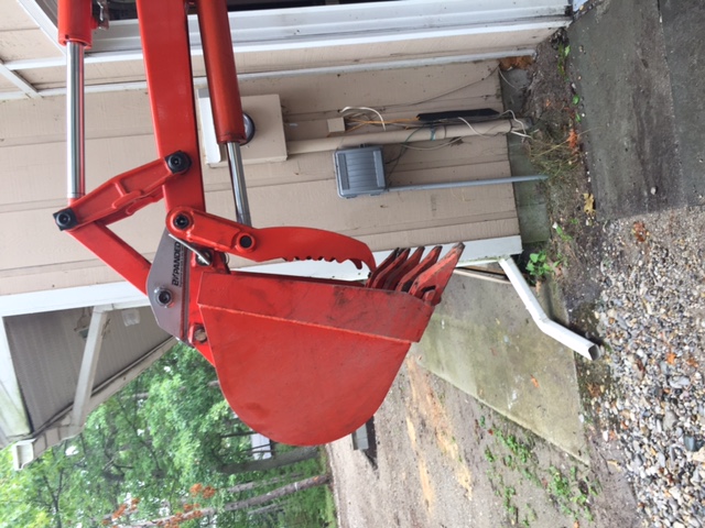

Bumper,
Not that much difference, the bucket is a little lower, 2 inches, and little further back, 2 inches. On the 24 inch bucket , the thumb was already inside the bucket.
Here is a picture with out the adapter, I will take a picture tomorrow with the adapter.
Randy

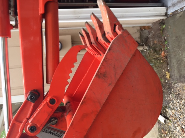

Bumper,
Here is the backhoe with the bxpanded adapter on.
Randy

Randy,
Thanks, looks good. I've ordered one with a couple of extra pins as I have a 12, 24, and ripper tooth, so I'll have an unused pin for a future attachment.
With the quick connect I expect to loose a small, maybe unnoticeable amount of force, an equally small additional reach, and a whole lot of time saved switching buckets :c)
