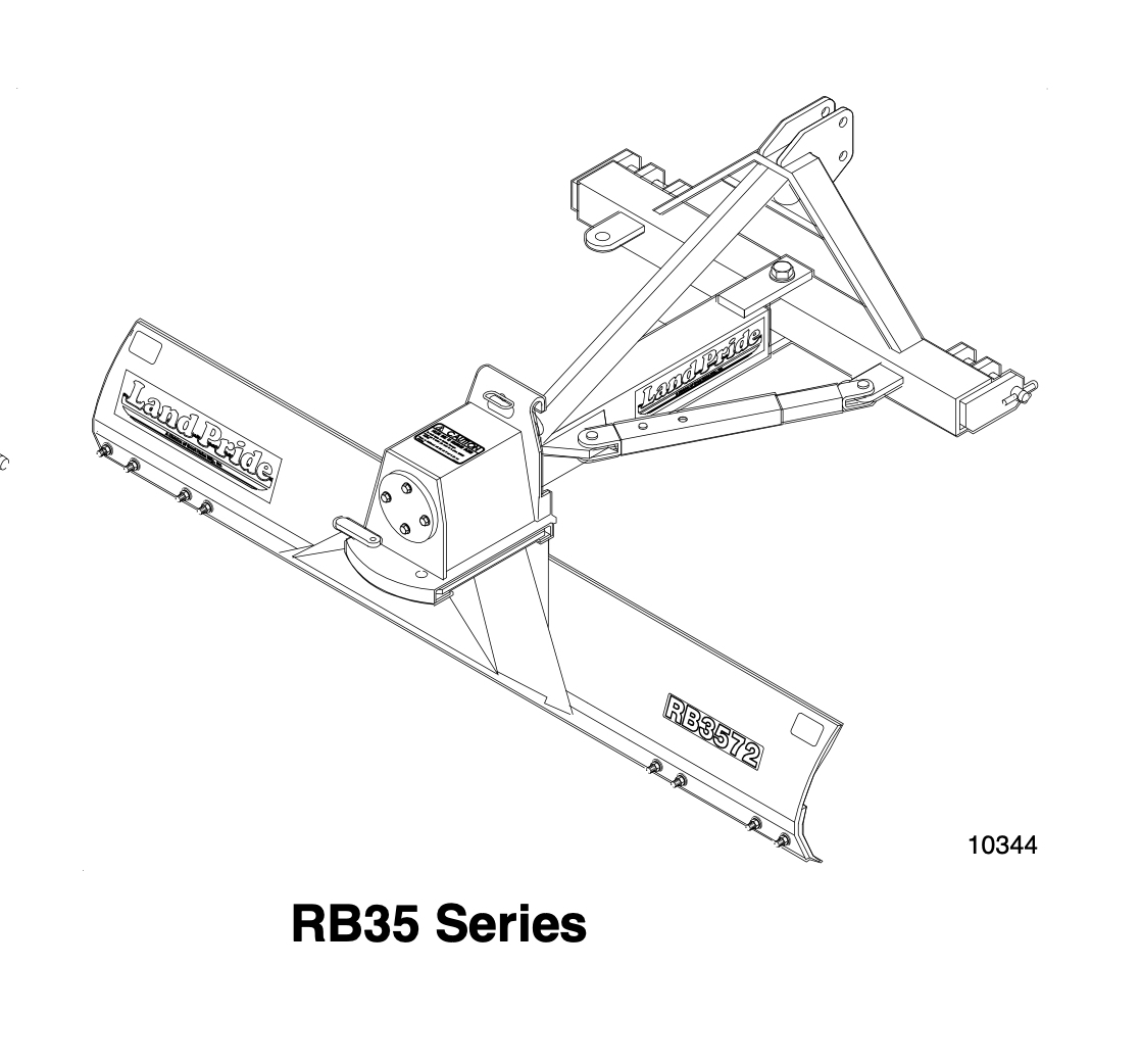

Twenty years ago, the type of project that you are wanting to do was very commonly done with 30 hp tractors. ALL YOU NEED IS THE RIGHT 3PT IMPLEMENT.
At one time, every USA implement company made an affordable manually adjusted 3pt six foot back blade that worked nearly as well as a road grader. IT DID JUST WHAT YOU WANT.
We have one, and I still have an old spread sheet showing half a dozen companies that made their own version. Although these have mostly been discontinued in today's cheapie US implement market, a used one would be just exactly what you want for that muddy long driveway.
In fact, since I have one I know it well. No, unfortunately not for sale - but a used one would be just as good. An example is a Land Pride RB3572 (discontinued, of course)
Then RB3572 came with manually adjustable tilt, angle, offset, reversing, end plates caps, stand, trailing wheel, and skid shoes. Every part well built. Well matched to your B3200.
Price in 2002 was just over 2K. Used ones are now about that price today.
It will cut, smooth, ditch, and berm. Does mud & gravel. Has optional rake.
Here's all the info on one typical model. There are others.
It does need to have all those adjustments, and most of the optional parts to really work well. The end plates/caps are what makes it work like a box blade. The tilt+offset does the ditch & berm.
Then trailing wheel keeps it all honest.
(y) (y) (y)
Amazing recommendation and literature. Thank you very much! Having a model/series that has been tested to search for helps a lot!
How could I find comparable models with full adjustments? Do you happen to know another model that i could start a search for too?

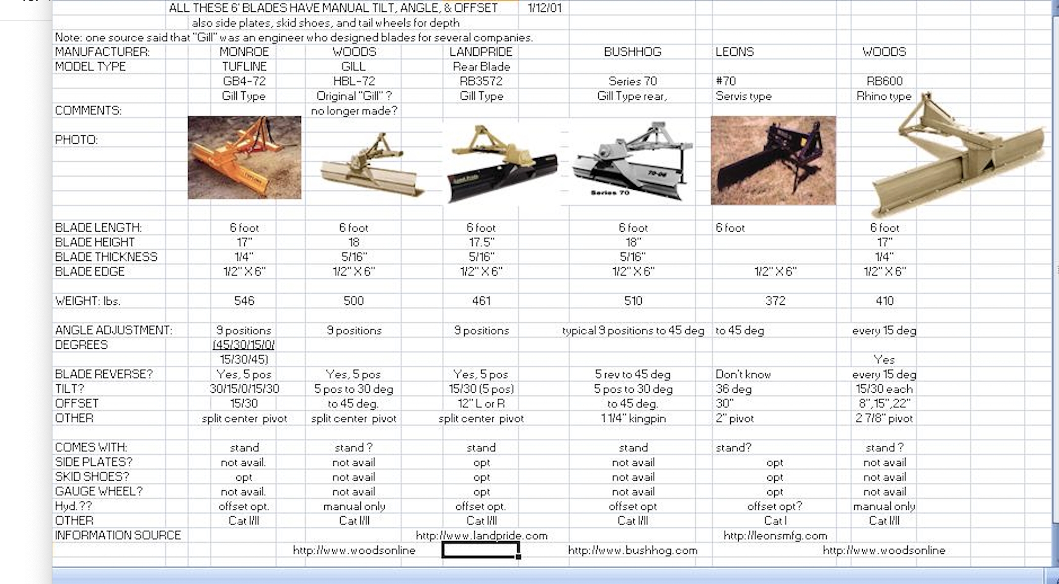

(y) (y) (y)
Well, they used to be common. The same blades are now hydraulically controlled and over twice the price. But I'll bet manual ones are stll out there. Once you get it set up for an operation like ditching or berming you tend to go the whole length of the drive that way. It often requires many passes moving only minimal material to get it right.
There are a number of used implement warehouse dealers online. Used ones work as good as new, but all of the 3way adjustable work much better with the end caps & sliders. I've not found a tail wheel (depth adjustment) as handy as I thought it would be.
But all those parts are pretty much universal and can be adapted later.
Here is a screenshot I made up when looking. Old, but might help. Most blades angle, but what you really want is one that will also tilt & offset. They are built much heavier that a simple angle blade. They are expensive, but 90% cheaper than hiring it done - and when done you can keep or sell the blade. rScotty
