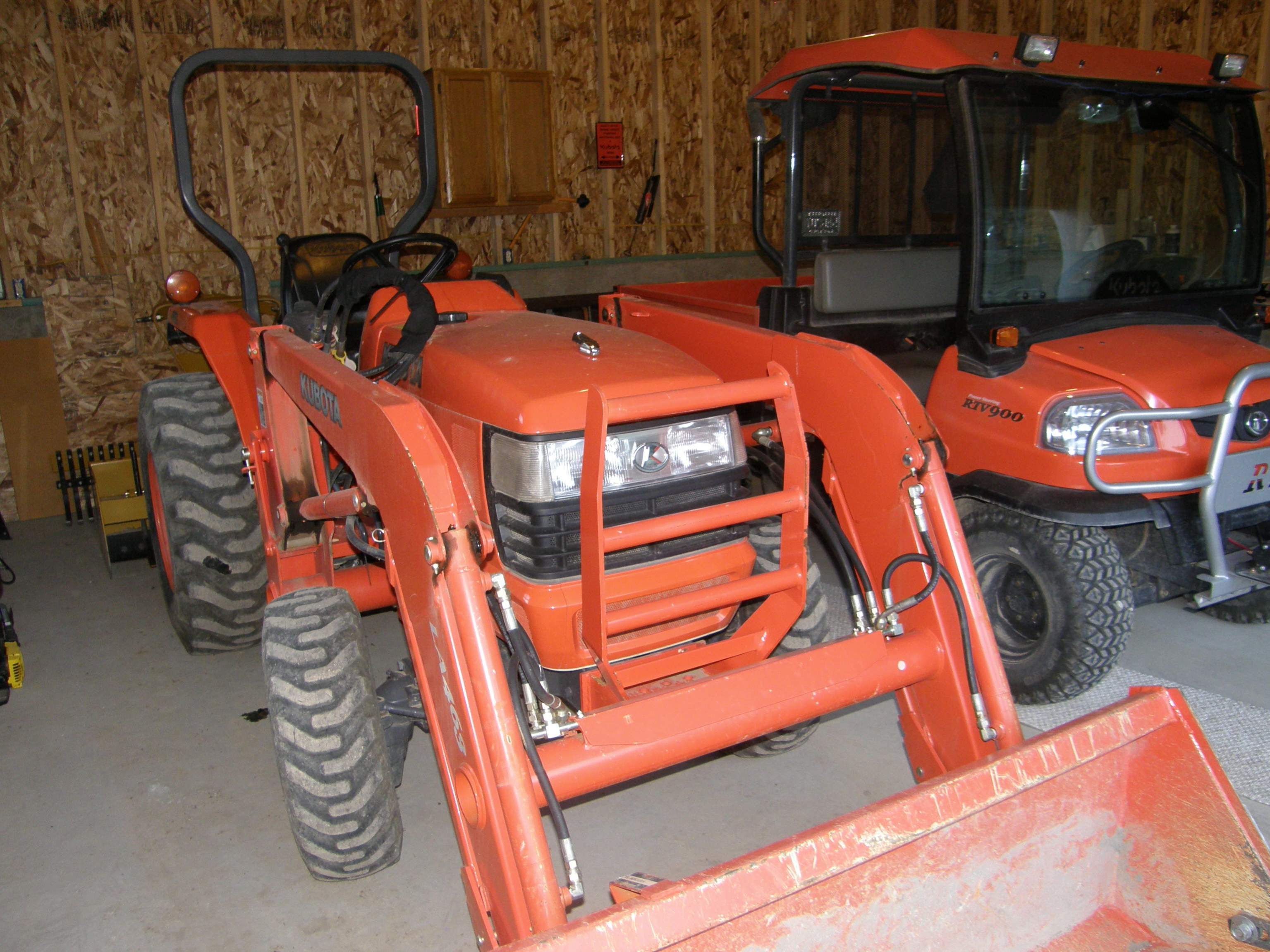

This is Kubota Country with a real work horse tractor. (if the picture attaches)
