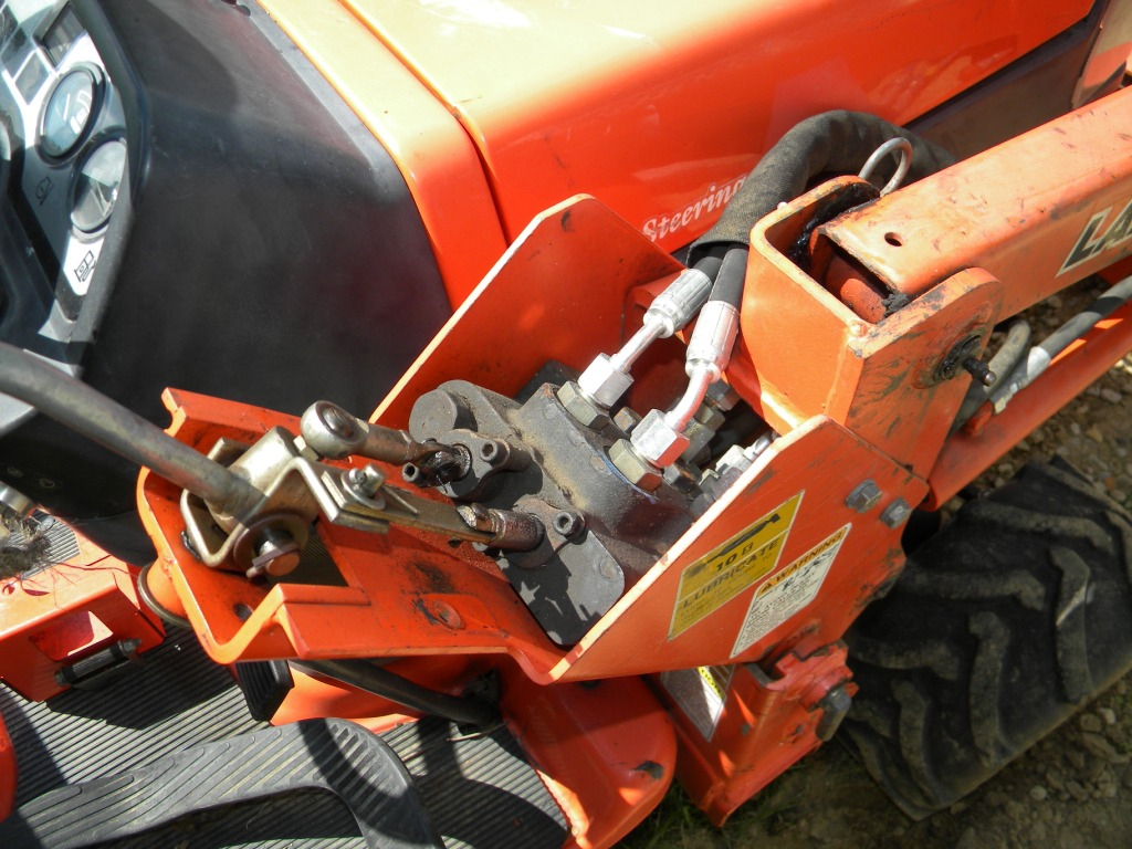

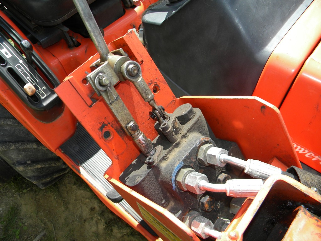

My loader will not go up or down. The bucket will still turn down or up but the loader itself just stopped going up or down while I was using it. The control arm will still flip the bucket u
p or down when I move the control arm right or left, but won't move at all when I push forward or downward. The control arm itself will not move up or down.
   / Kubota BX2200 loader will not go up or down #2
Check the linkage from the Joystick to the actual valve under the top cover, 3 bolts to get it off.
Did that and do not see anything loose or missing. If I push the lever forward it will move about a 1/16" is all and nothing happens with the loader. If I pull back on the lever, it doesn't move at all. It's like it's locked in place. Right and left lever movements remain okay. The bucket moves up and down normally.

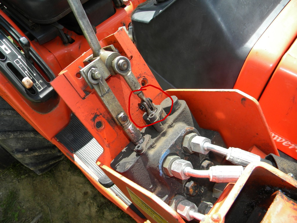

   / Kubota BX2200 loader will not go up or down #4
If you disconnect the linkage at circled area you will be able to find out if it is the joystick or inside the valve

That would have been my suggestion too but it seems the spool isn't moving and I don't believe there is any lock. My BX22 does not have one. OP needs to do as Eagle1 suggested and determine if the lever/linkage is stuck or if the spool is stuck.

Looking closer at the picture looks like the loader valve may be stuck in the FLOAT position, all the way forward. I've heard of the detente mechanism failing. All that stuff is under that long cap on the bottom of the valve normally some bearing balls and spring that will try violently to escape when disassembled.
Loader - FEL stuck in Float position

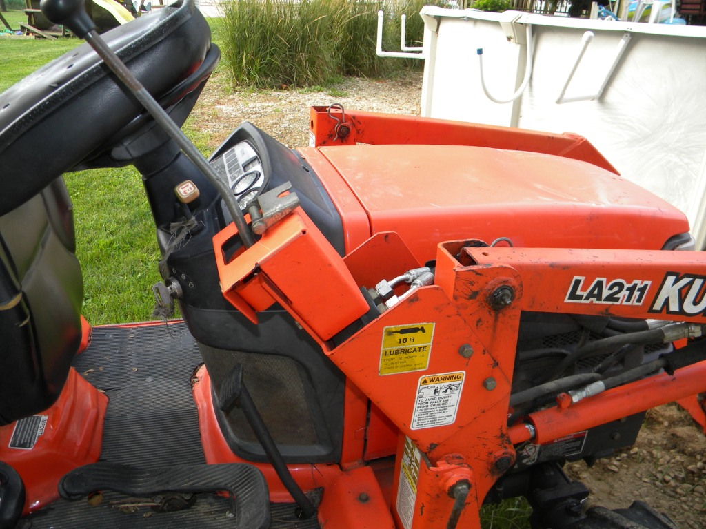

Good observation. There should be clean spool showing if it was in neutral. Pulling back on the lever would pull it out of the float position provided it's not being blocked mechanically. Note to the OP that float position is detented so it will take some force to pull it out of that position.
Edited to add that the third picture clearly shows the lever clear forward in float position and that there is a sort of lock but that it is not in the locked position. I never use that thing and had forgotten it existed. (the lock, use the float regularly)
#11
If you disconnect the linkage at circled area you will be able to find out if it is the joystick or inside the valveView attachment 758774
I did this and still cannot get the rod in the manifold to pull out. With the cover out of the way I was, however, able to move the rod inward and back about 1/4". I tried this with the engine running and it had no effect on the loader movement. I also rotated the the rod around and it turned freely. I have a sinking feeling that I have internal manifold issues.

Yes, it appears to be locked in the float position. One way to try to unlock it is to sharply hit the lever in the raise direction. This should "pop" it out of float. If not, you will need to remove the spool and disassemble the detent assembly, being careful not to lose the balls. Clean it up and reassemble.

Item "A" and "020-A" are pretty much the detent portion. There 4 small balls and 1 larger ball at the end of the small spring. these all go in the inside of a sleeve. Items from "140-A" to the left are the detent itself.
I spent a few years as a quality control engineer and one of the places I covered was a hydraulics equipment manufacturer. As such I have always hated to beat on anything having to do with hydraulics controls, especially manifolds. But, I thought, what the heck. There's nothing external to this unit that I can do to fix it. So, I took your advice and gave it lone sharp, but not to hard, blow with a brass headed hammer. It worked!! I found that I can still get it stuck if I go too far with the control arm, but ,after I reinstalled the cover, it can't go that far and the loader works fine so far.
Thanks to everyone who made suggestions about my problem. I now know a heck of a lot more about this tractor than I did before it got stuck.
